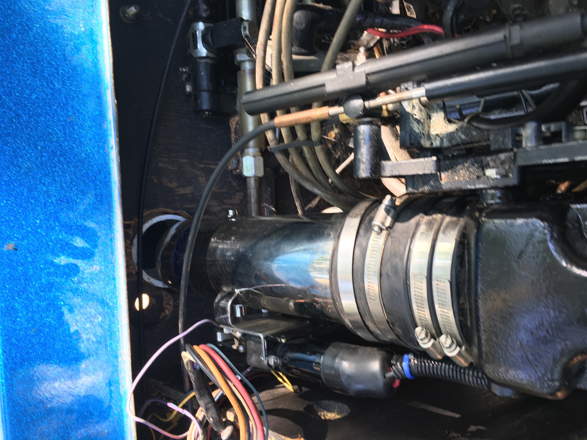

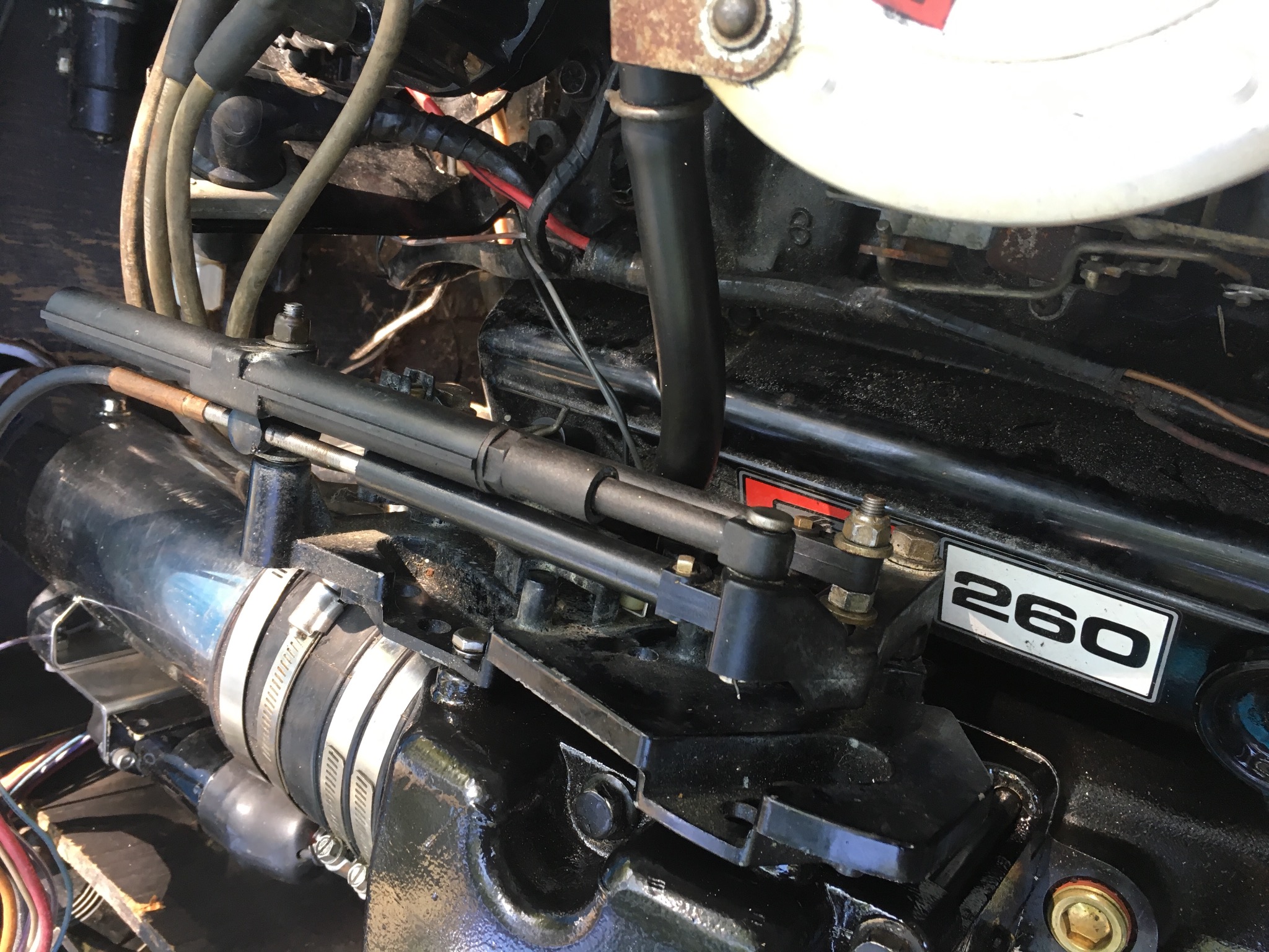

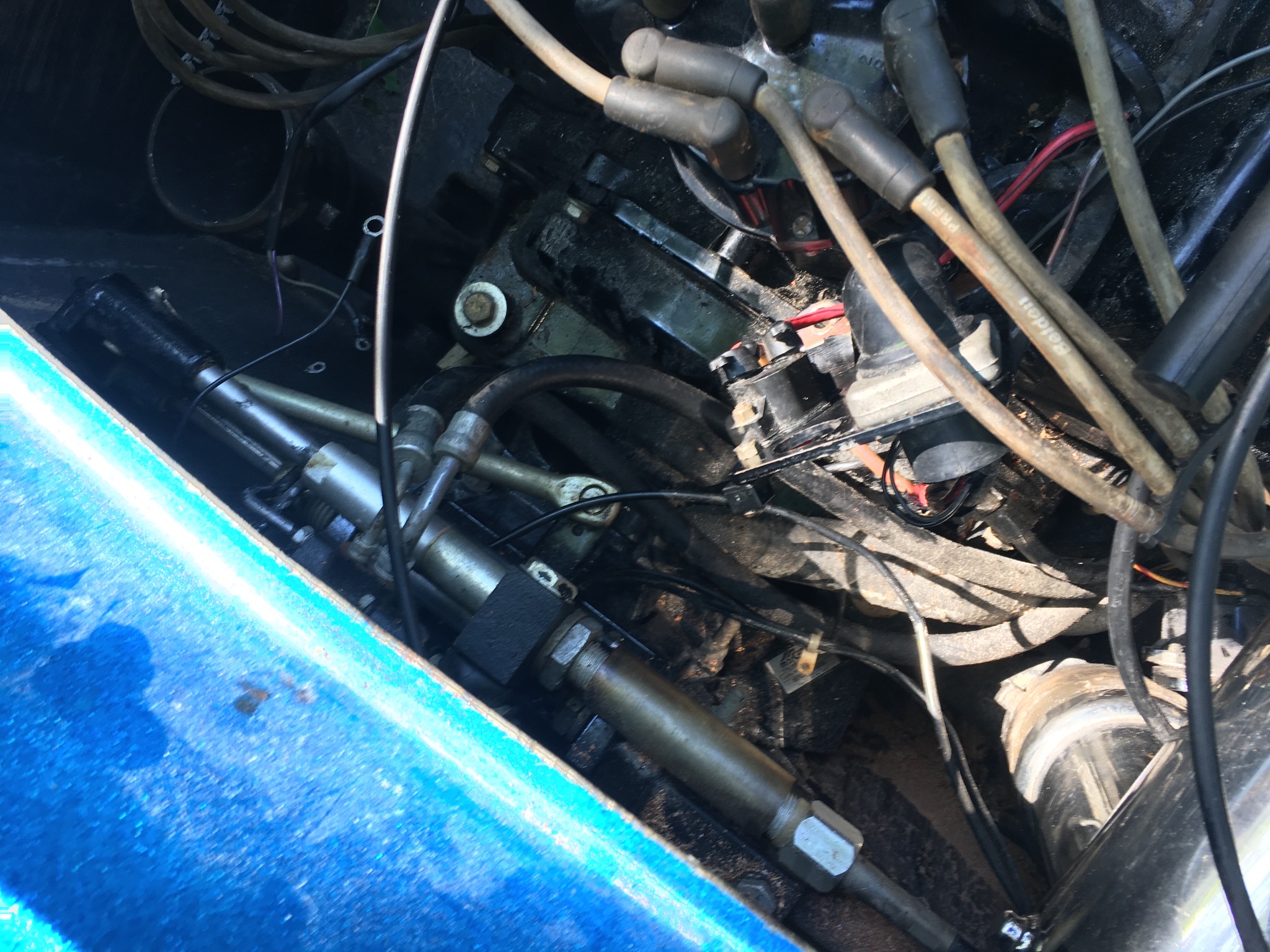

1980 Hammond San Tropez Restoration 9 years 1 month ago #134277
Just a quick update, the project is still ongoing-a new job has taken all my time so not much is left for the boat.
Also, I have yet to find a good place to re-host my pictures so standby for those.
I got her running last week to check all of my new parts:
New Mercruiser updated manifolds instead of the "logs".
New risers
Quick and quiet exhaust
New Edelbrock carbeurator
New coil
New thermostat
Complete tune-up
Updated to Thunderbolt IV ignition to scrap points
All proper associated brackets to accommodate new manifolds
New Mercury low-flow trim pump to scrap the reverse-lock mechanism
So she's ready mechanically, and re-winterized.

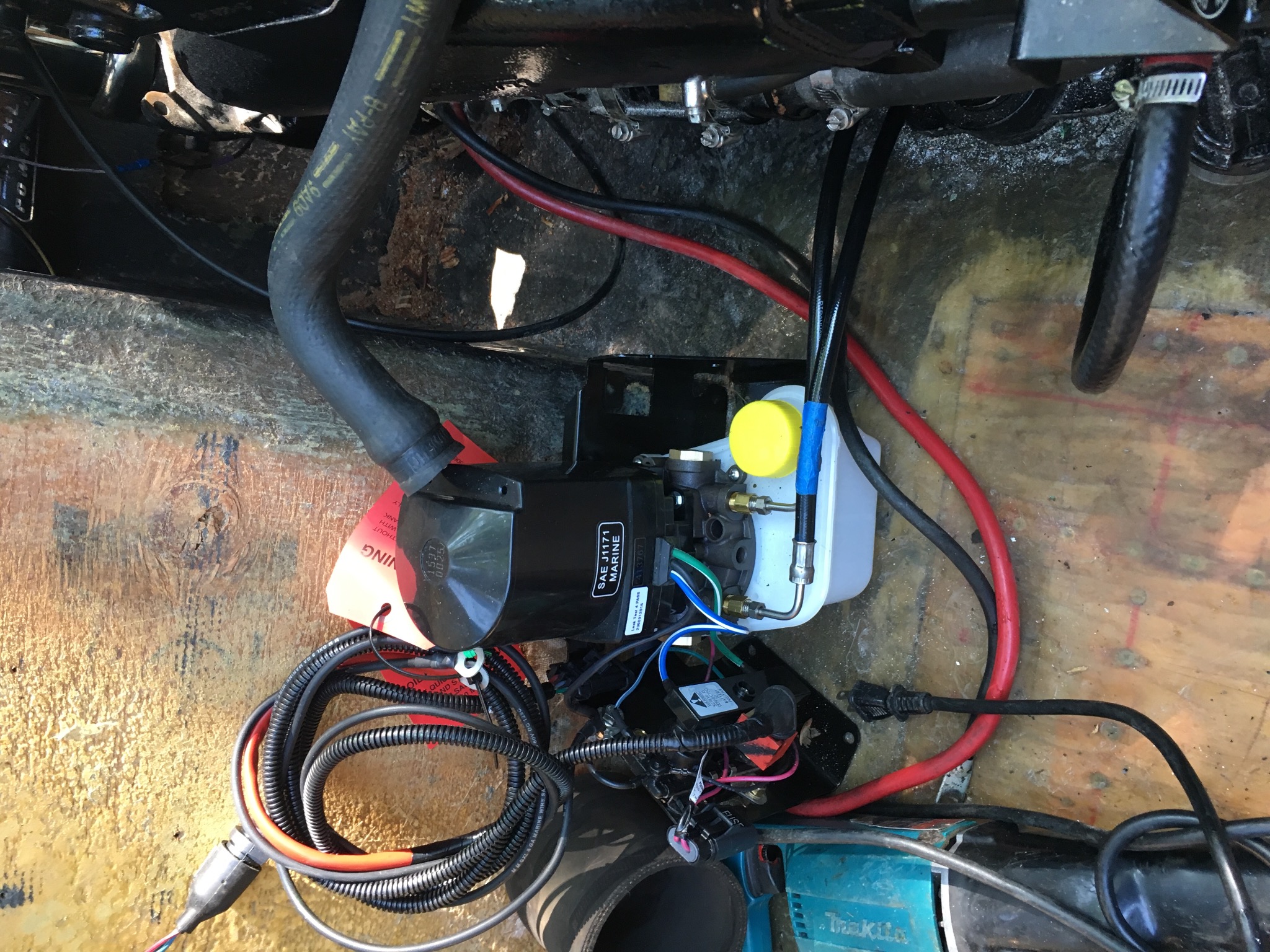

Bellows replacement and trim senders:
Mounted the platform and sensors:

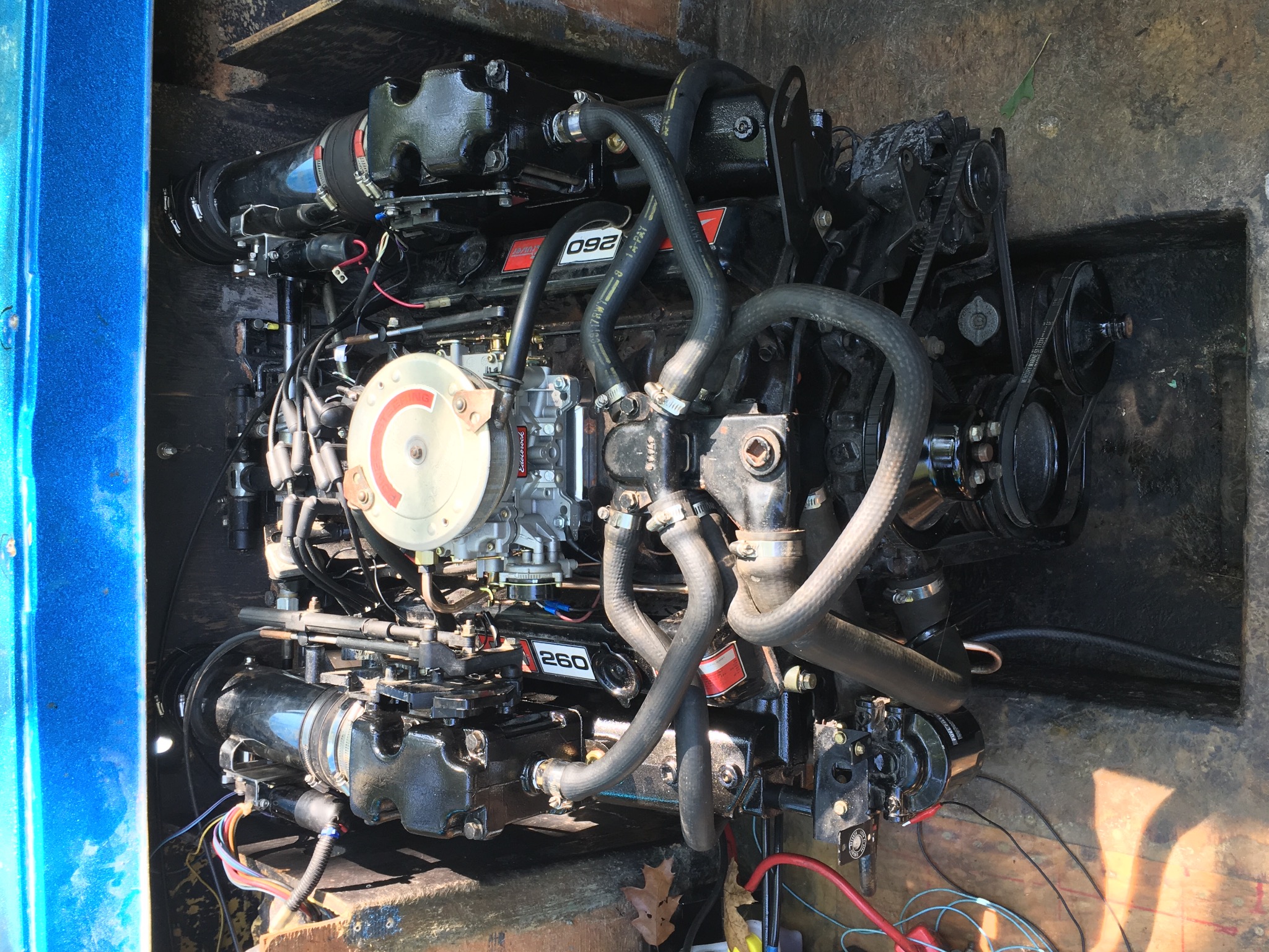

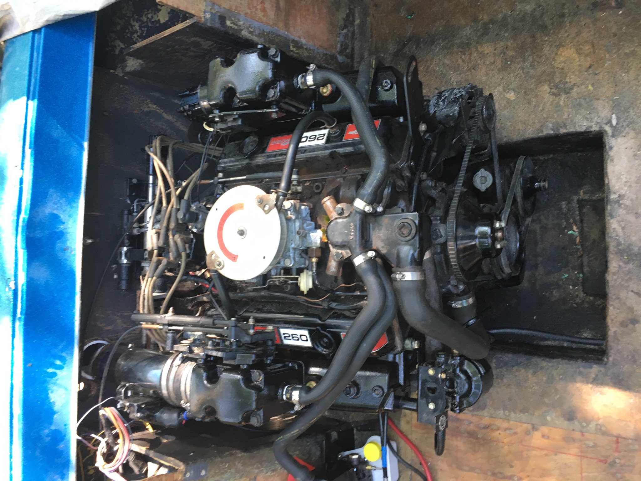

Battery area and switch, it’s much neater than in person I swear:
Engine overview:
