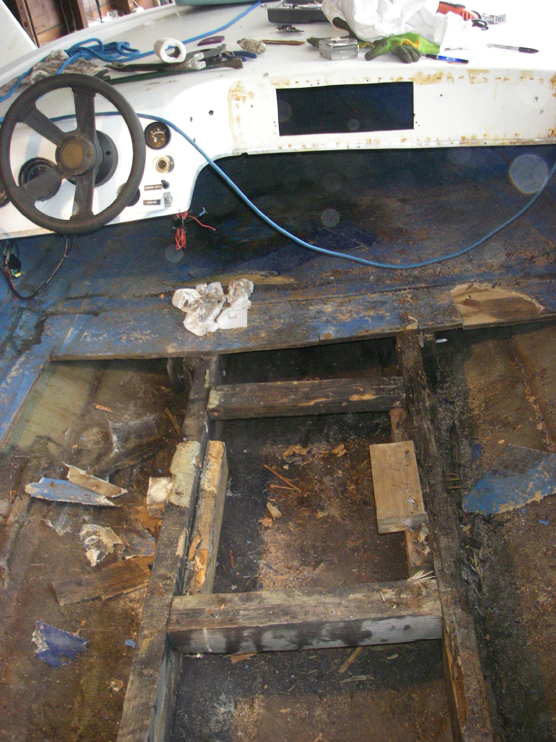

Went back thru the annals and found this pic of what the old structure looked like before rippin' it all out. Those stringers werent even really taped in, just kind of laying there. Good news was that the basic hull and deck laminate was solid. Built of woven roving fiberglass, not chop strand mat. (Of course there's some mat under the gelcoat which is typical ).
My profession is design and engineering of sailboats and powerboats, in fiberglass and carbon, so I know what good construction should look like. What I saw in the internals almost made me puke.

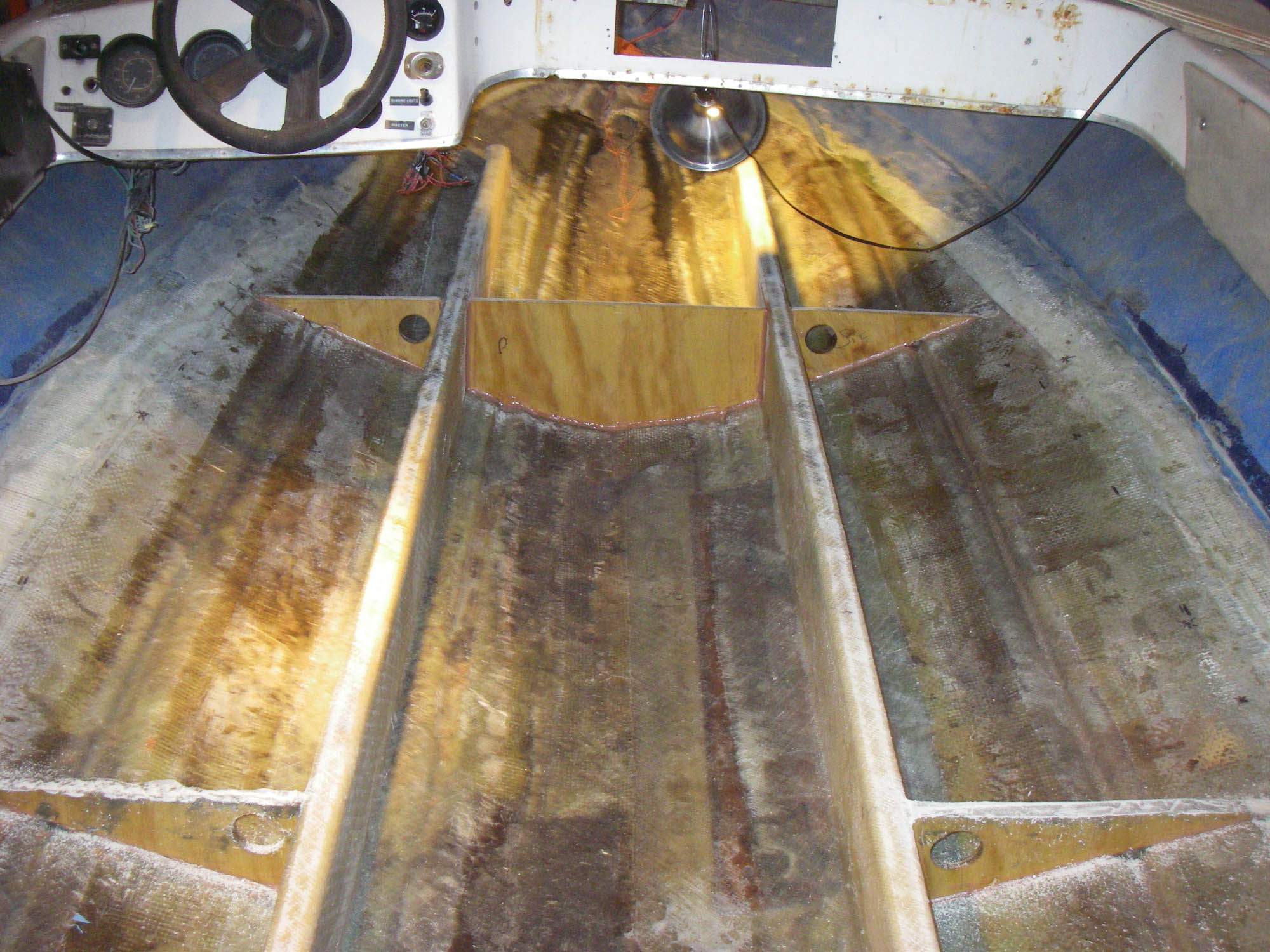

Here's some pics of the new structure. Found some good Spruce 2x8's at Home Depot, nice and straight grain and light. Spiled them into the bottom, then epoxied to the bottom with West Six-Ten. This is nice epoxy ( albeit expensive ) as it's not brittle like laminating epoxy. You can make fillets with it etc. Jamestown Distributors now makes a similar produce called TotalBoat Thixo.
I then laminated over the stringers with 1808 fiberglass / polyester resin, with the bias of the glass at +/-45 degrees to CL. Thus the glass makes the webs of the stringers and tabs them into the bottom. The transverse frames are 1/2" plywood, epoxy coated and filleted in place.

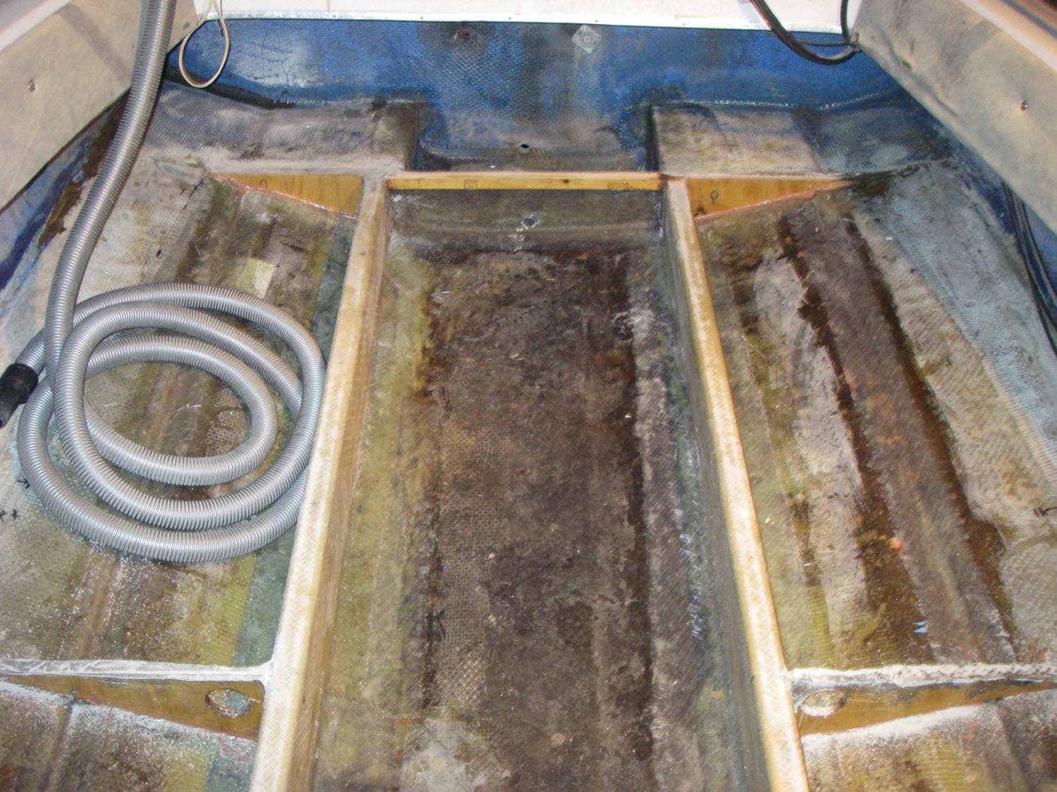

Re:1969 Anacapri Speedboat Restoration 11 years 5 months ago #110945
Heres a picture of the new structure, looking aft.

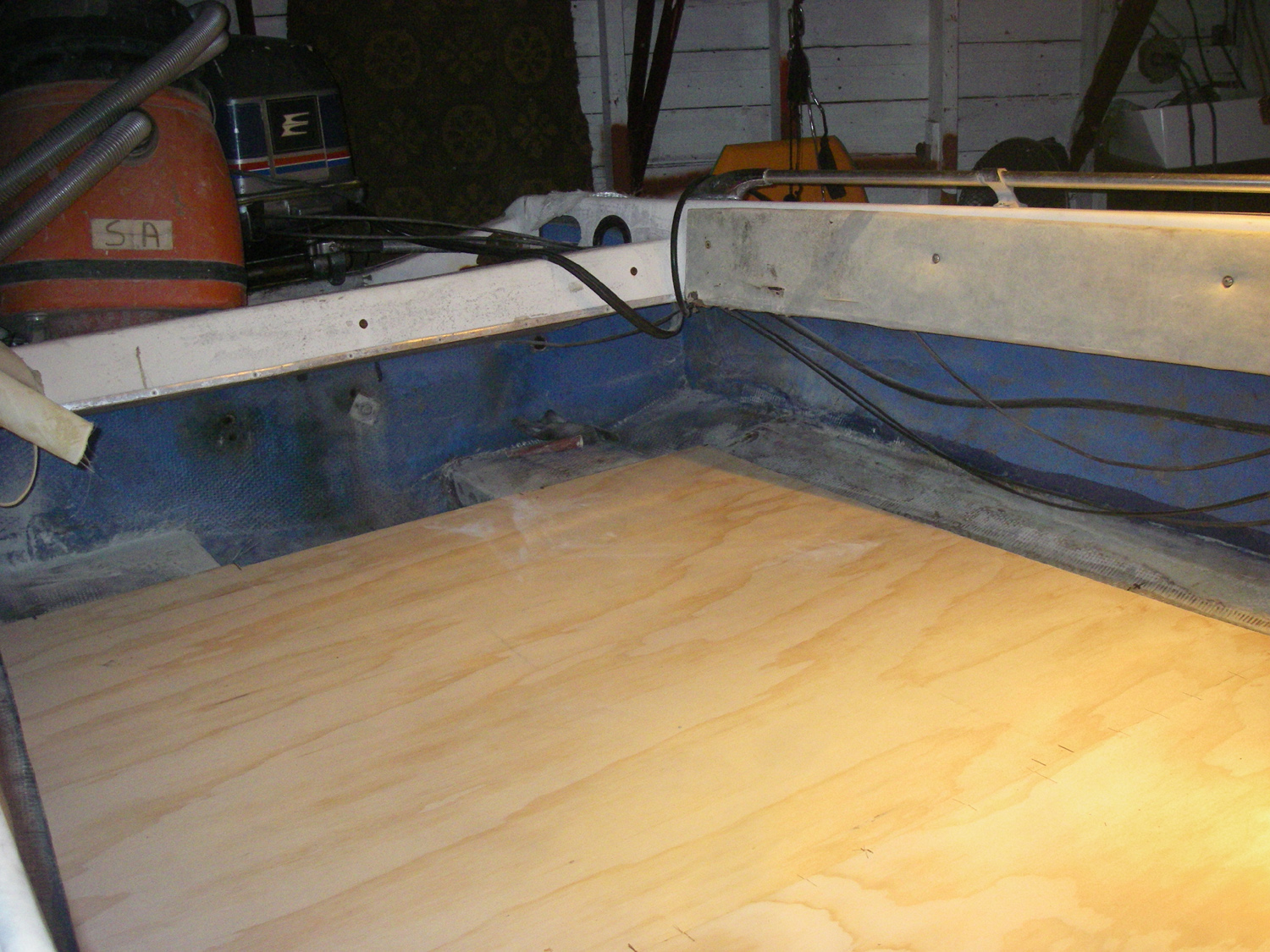

Here's a pic of the new cockpit sole. 1/2" plywood, bonded down to the stringers with 5200. At the edges, it is tabbed into the hull sides with 6" 18oz biaxial (45/45) glass tape.

Here I am prepping the cockpit sole for paint. Sole is tabbed to the hull sides, and glassed over.

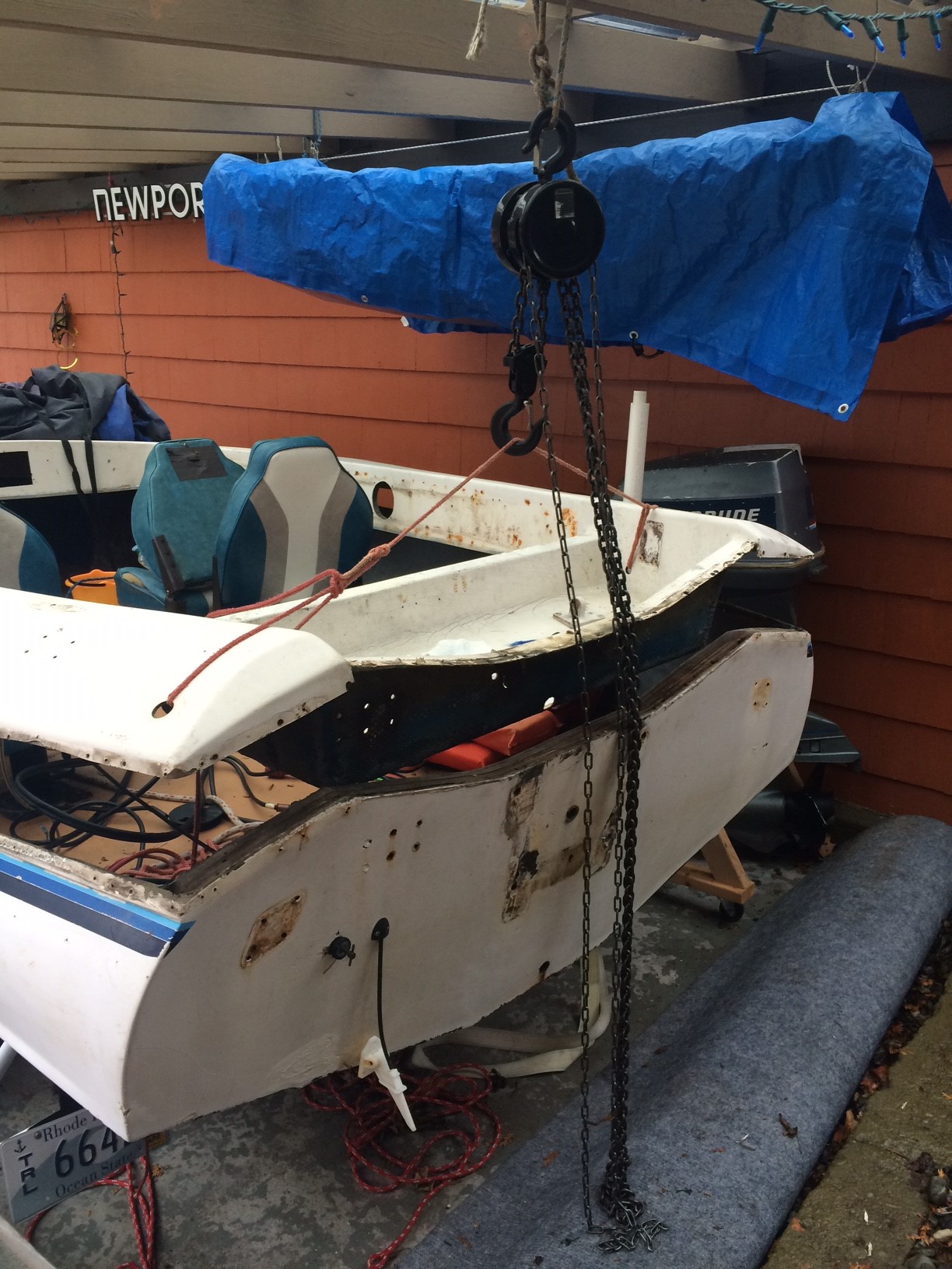

Fast forward now a few years to Fall 2014, the start of "Phase 2". The boat had been running great, but knew at some point I had to get into some serious work on the deck, repairing delam / rotting core, and then fairing gelcoat crazing and then paint.
Here's the start: lifting the deck, exposing transom plywood which was delaminating too and needed multiple pourings of penetrating epoxy.

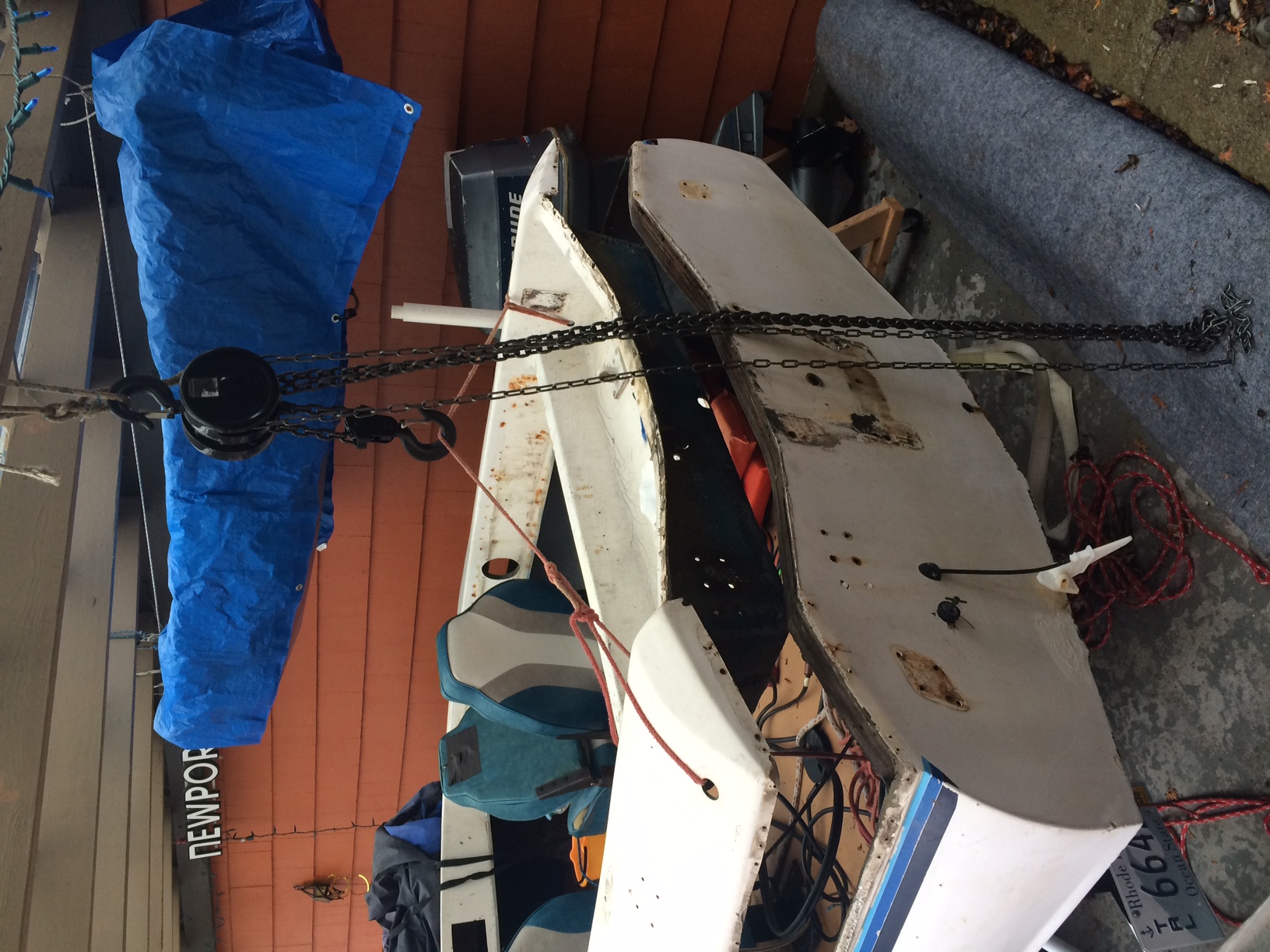

Re:1969 Anacapri Speedboat Restoration 11 years 4 months ago #111572

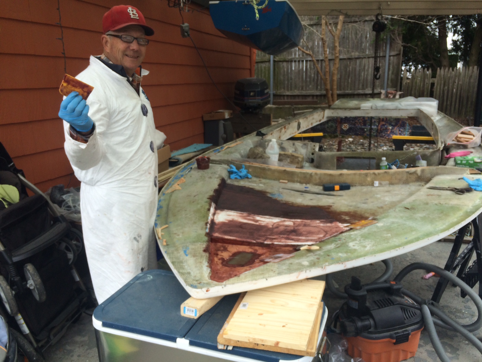

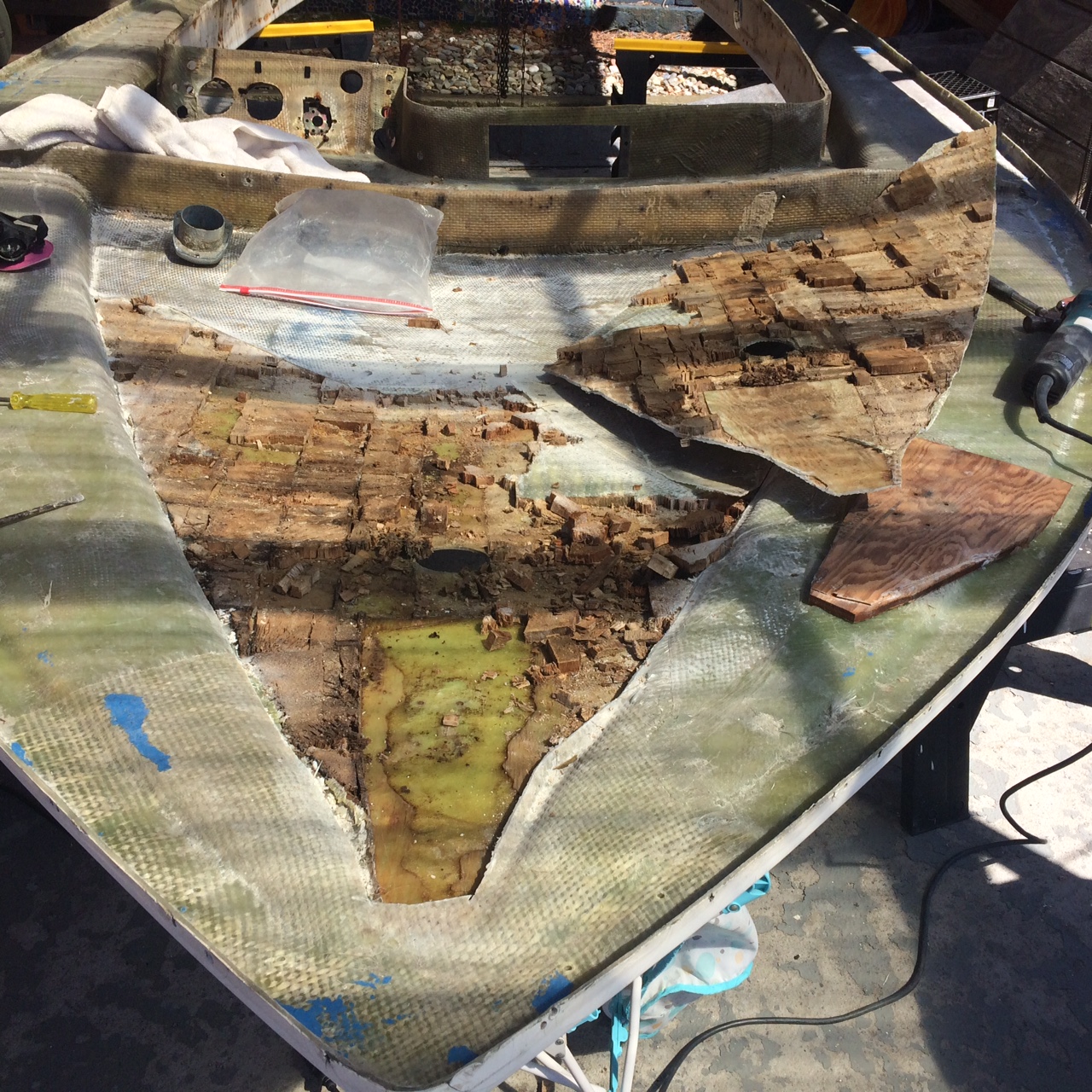

Deck is off, and flipped over. Foredeck was originally built with 1/2" balsa core. I knew there was delam, I just didnt know how bad till I cut into inside skin and the core. Pretty bad, all from leaking into deck via the bow cleat boltholes. Balsa core is junked when it rots. This picture shows why. Yes it's cheaper than Corecell or Divinycell foam, and has great compressive strength. But a single breach in sealing your hardware and the boat rots from inside out. As a boat designer/engineer I always spec foam or honeycomb Kevlar or Nomex core.
So I kept cutting away and boring test holes with 1/2" hole saw, removing a plug and seeing if it was dry or wet.

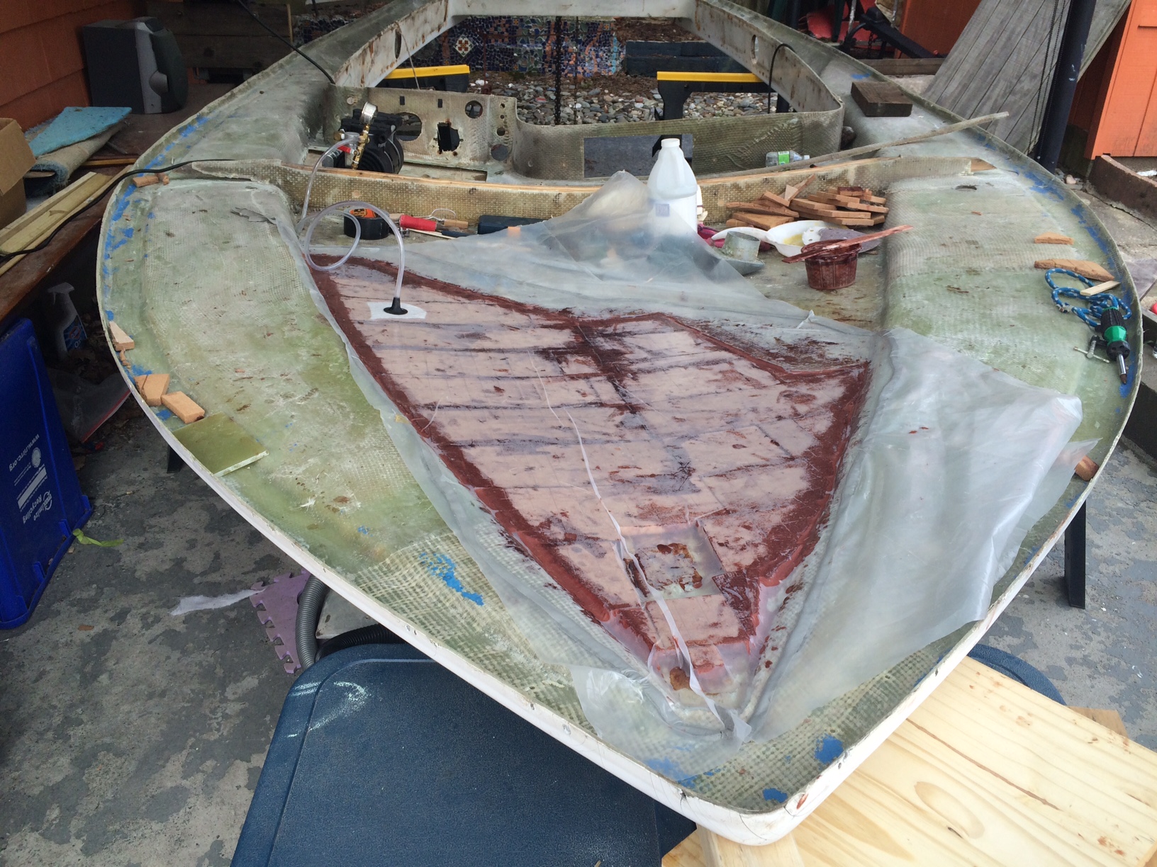

Here comes the new core. 1/2" Divinycell H80 epoxied into place, and vacuum bagged. Kerfs & gaps filled with slurry of epoxy and low-density filler.
Re:1969 Anacapri Speedboat Restoration 11 years 4 months ago #111574
Got the whole family involved! Here's my Father-in-Law getting into it helping me lay up new fiberglass cloth inner skin on foredeck. He did a helluva job, his first time fiberglassing. 18oz fiberglass / epoxy.
Re:1969 Anacapri Speedboat Restoration 11 years 4 months ago #111575
Inner skin of the foredeck now fiberglassed and vacuum bagged.

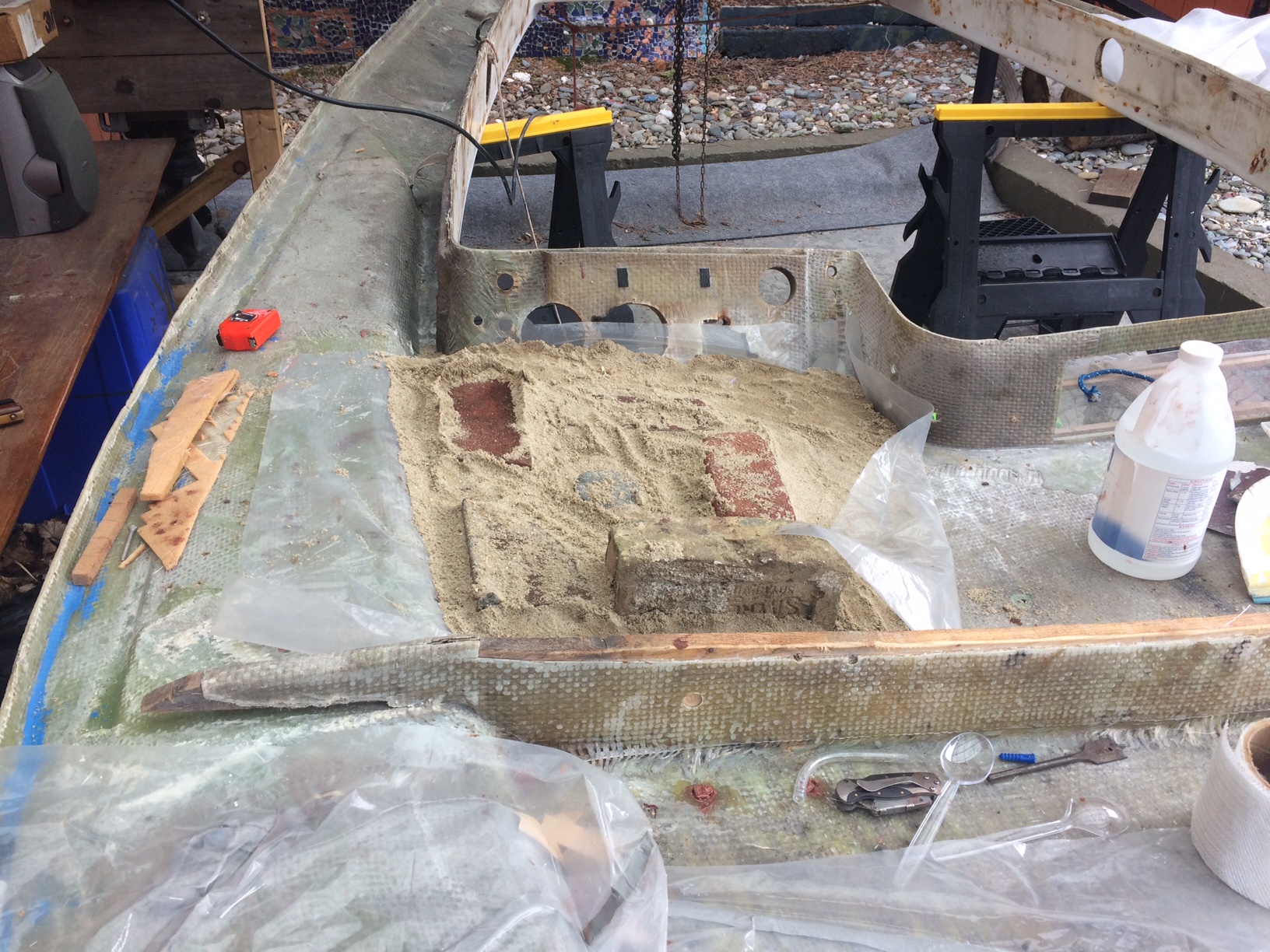

Here's a section of deck foreward of the dashboard, full of rotted balsa as well. Here instead of fighting to get a vacuum bag to work over a weird area and multiple porosity issues, I put down plastic sheet and borrowed a bunch of sand from my kids' sandbox.
That deckbeam got some love too. The wood core wasn't attached. I cut away the capping fiberglass, epoxied the core back in, re-capped the beam with uniaxial and biaxial fiberglass, and vacuum bagged it. A pain in the ass.

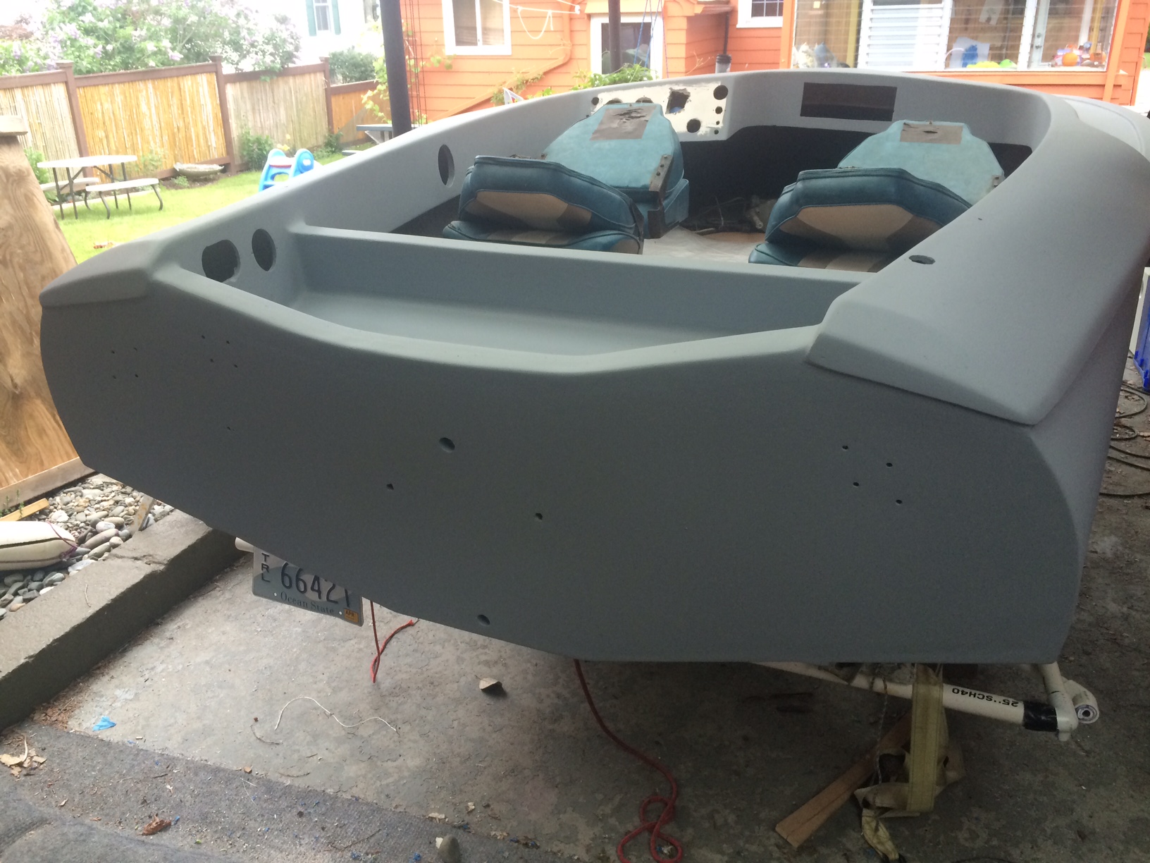

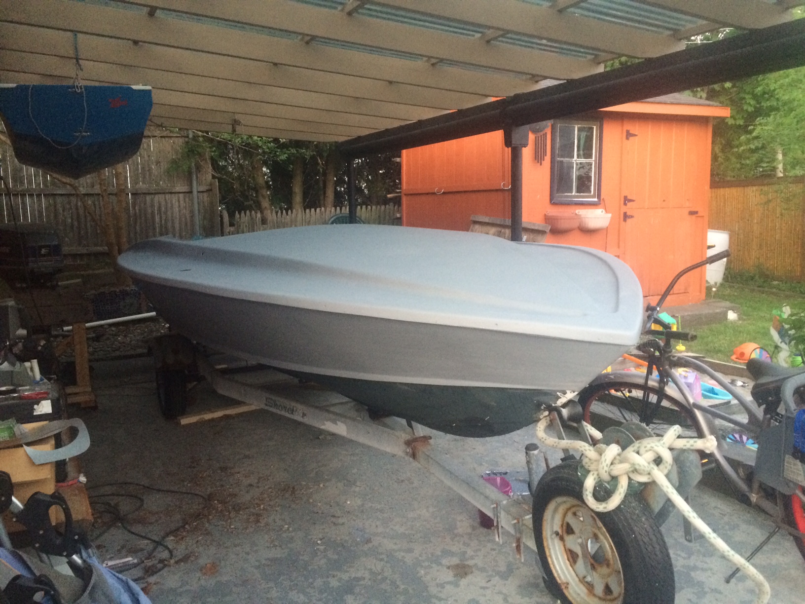

Deck has been flipped back over and landed on the boat. Originally the deck was just riveted on. I glued it back down with Jamestown Distributor's "Totalboat Thixo" epoxy, around the hull to deck flange all around. Same thing as West System Six-ten. Some screws as well to help clamp it. Here in this pic the boat has been primed with Totalboat TotalProtect 2-part high-build primer.
Re:1969 Anacapri Speedboat Restoration 11 years 4 months ago #111578

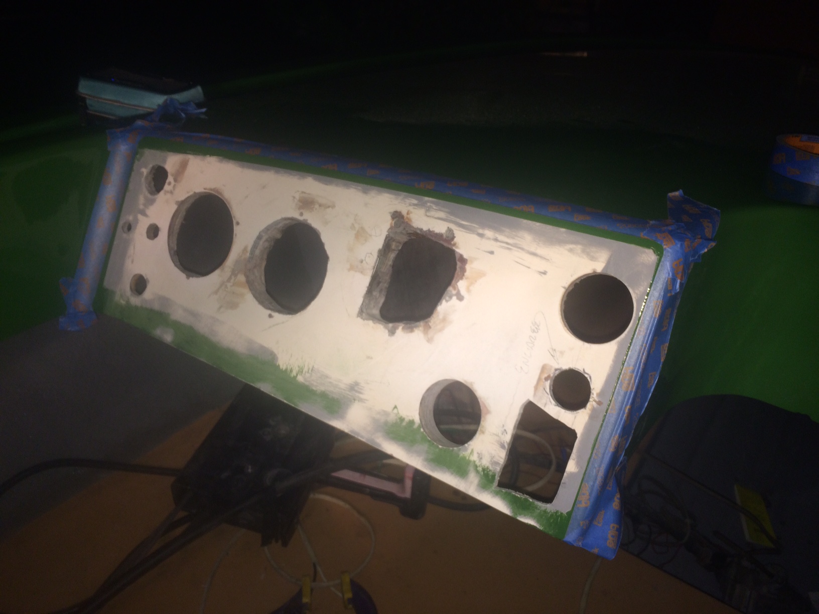

Here's the dash, instruments off, prepping for new teak.

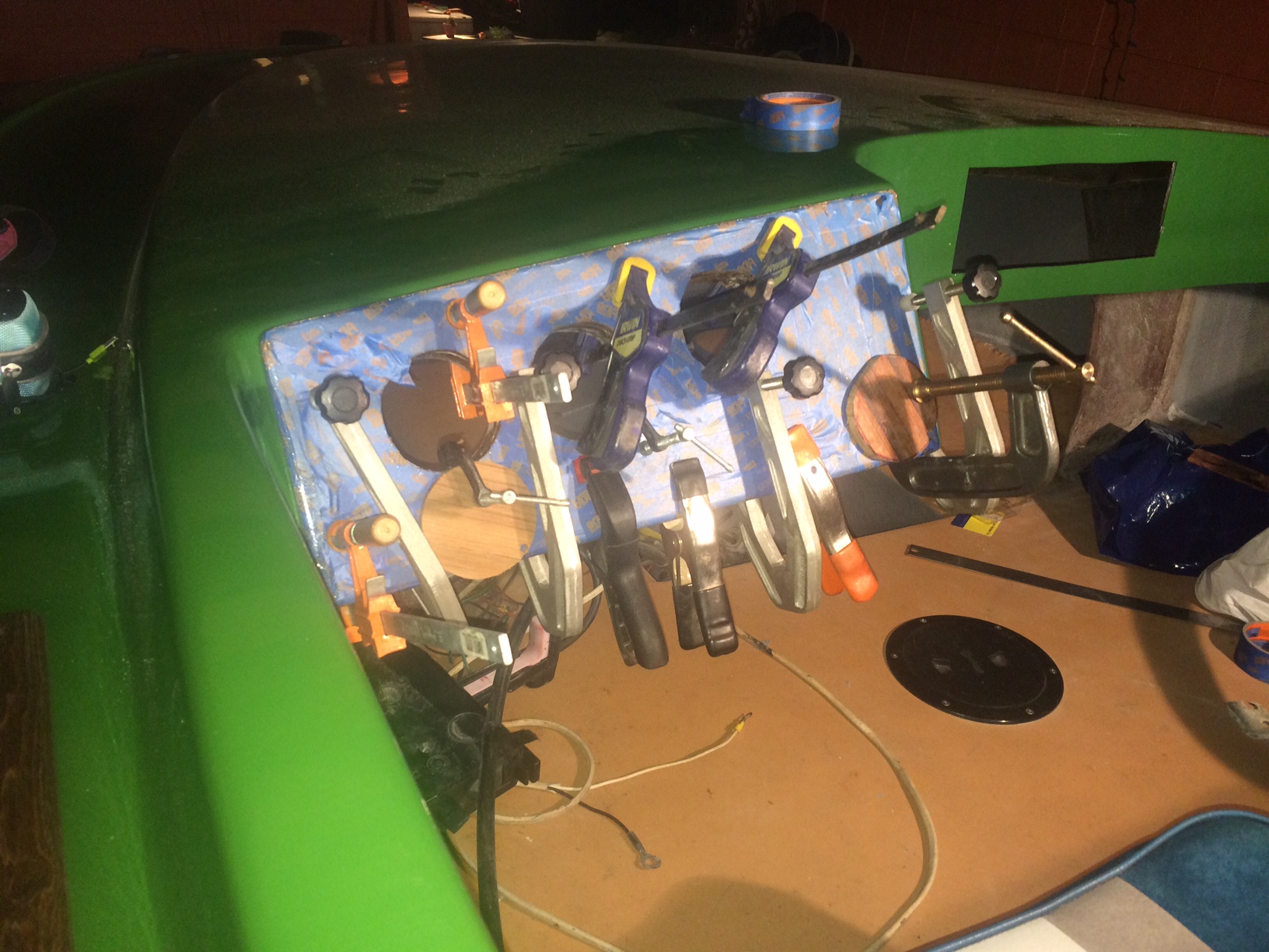

Using every clamp in the house to epoxy on the new dash. I dryfit it and taped all around the seam on both the wood and on the boat. Extra care with the tape and no glue to clean up. Best move here is get the tape off before the epoxy fully cures, so none of the tape gets trapped.

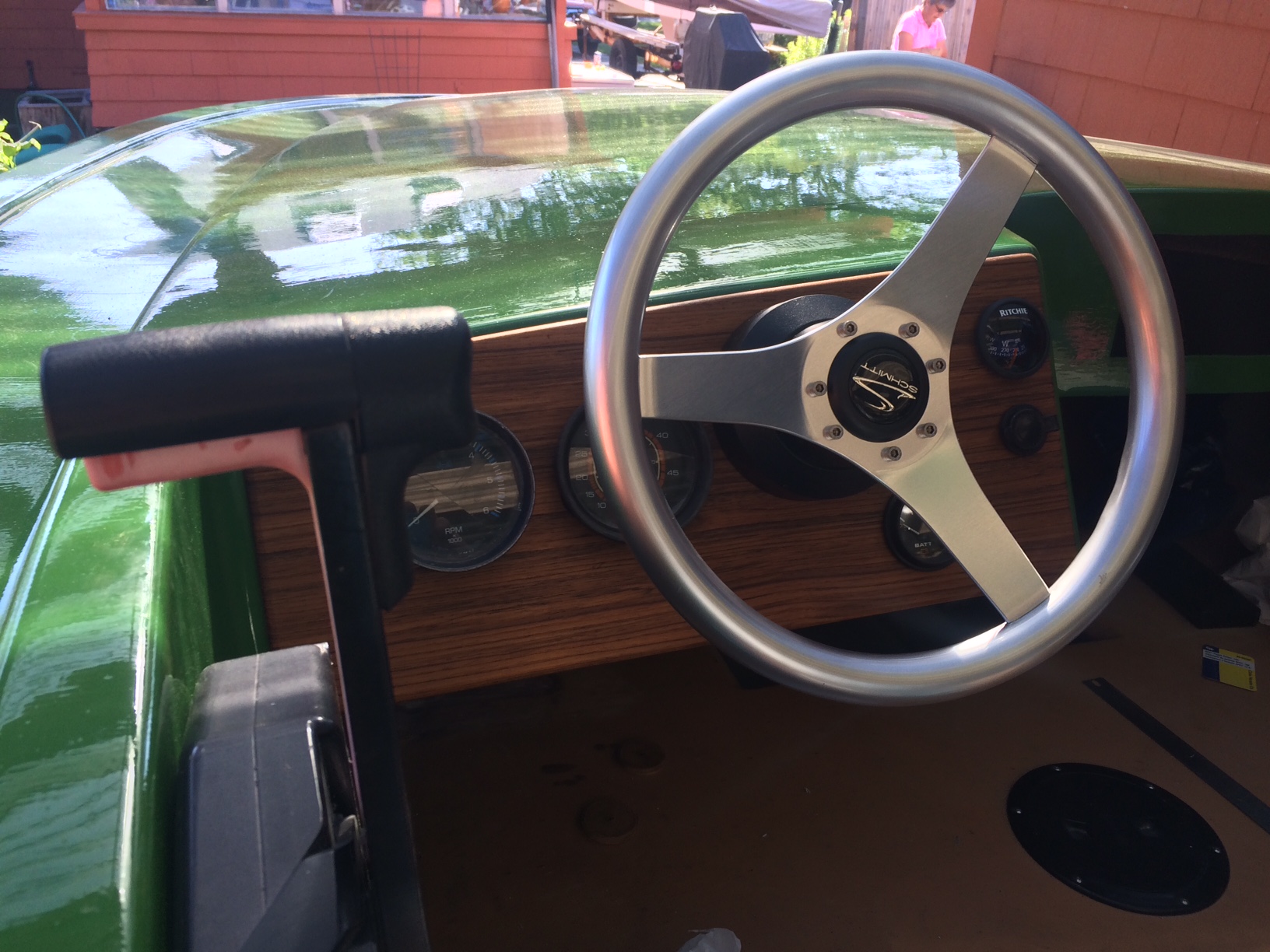

Here's the new teak dash. New steering wheel.

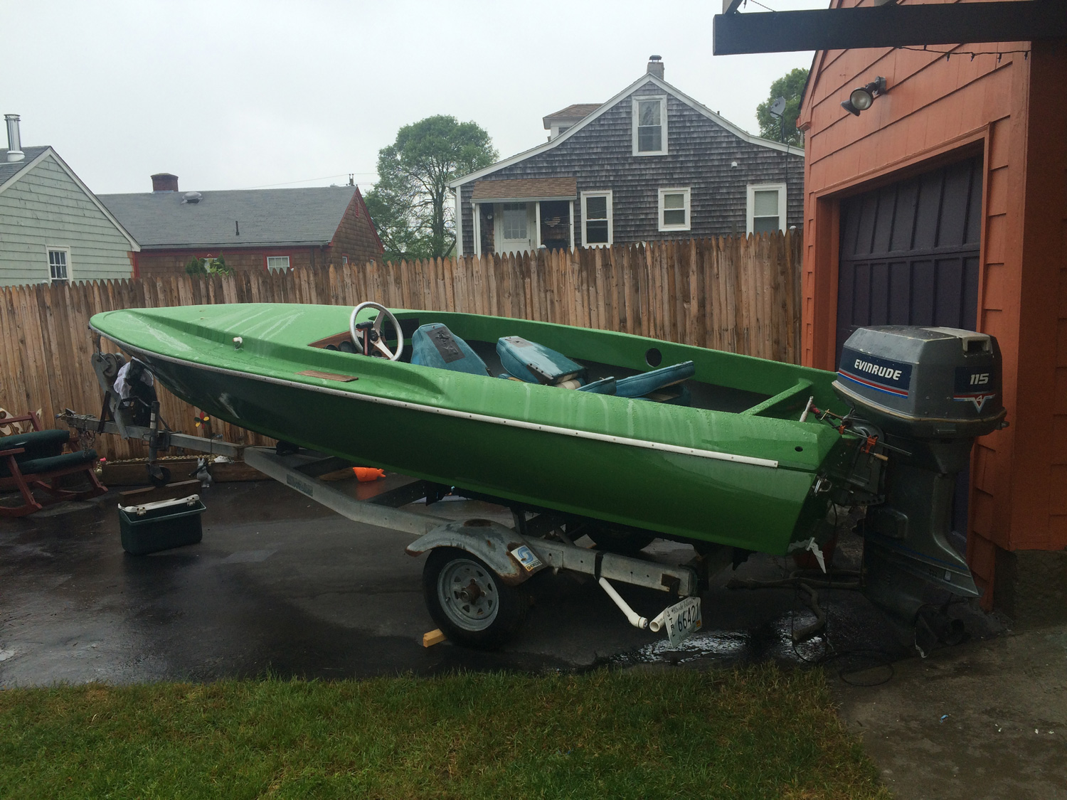

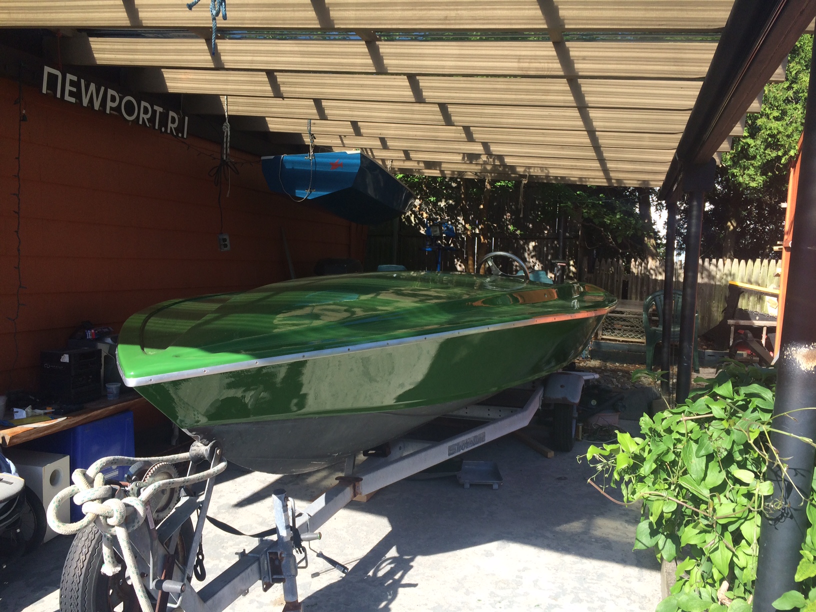

Finally out the shed! The seats are next years' project. Time to go boating.

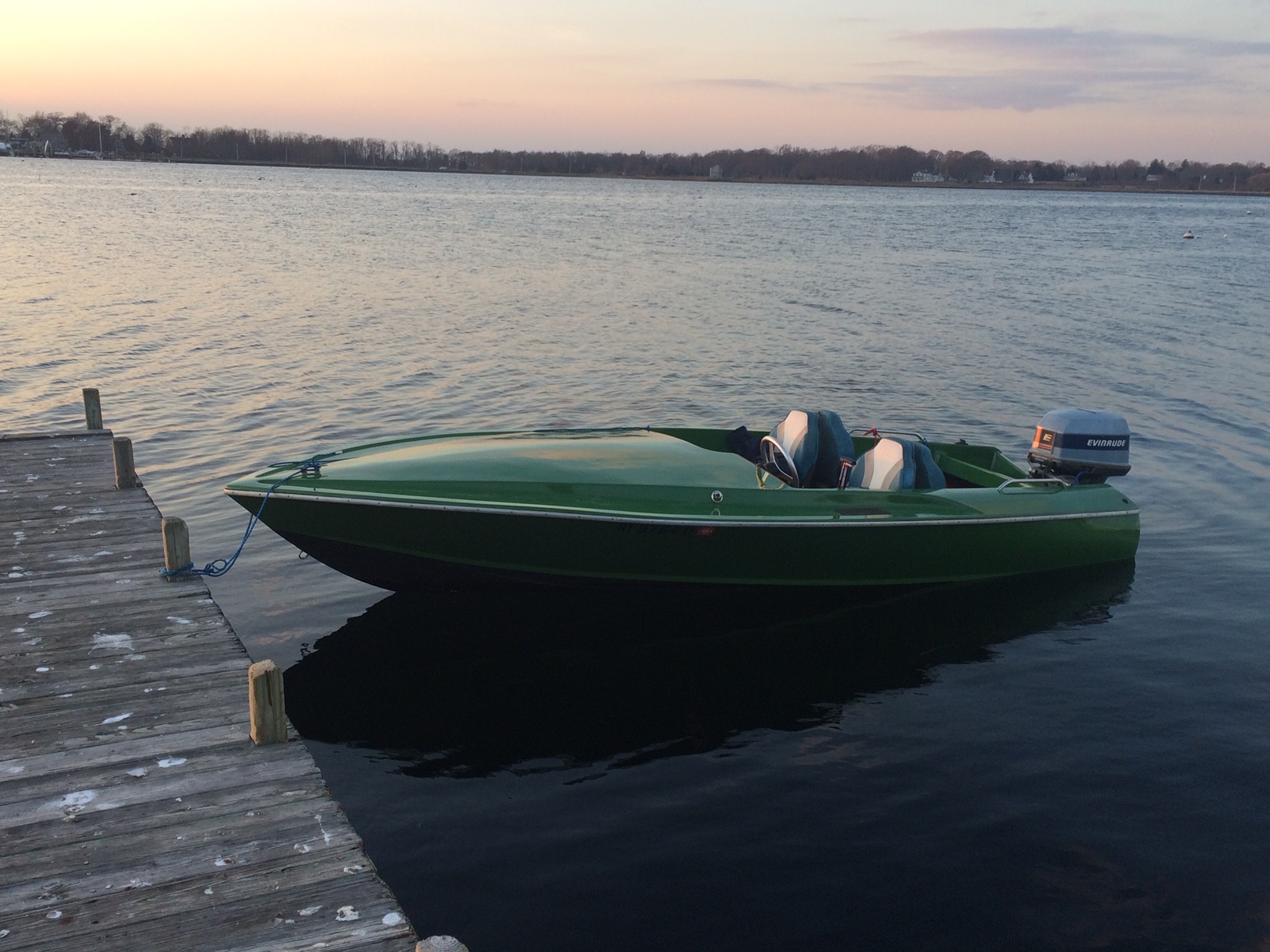

Re:1969 Anacapri Speedboat Restoration 11 years 4 months ago #111585

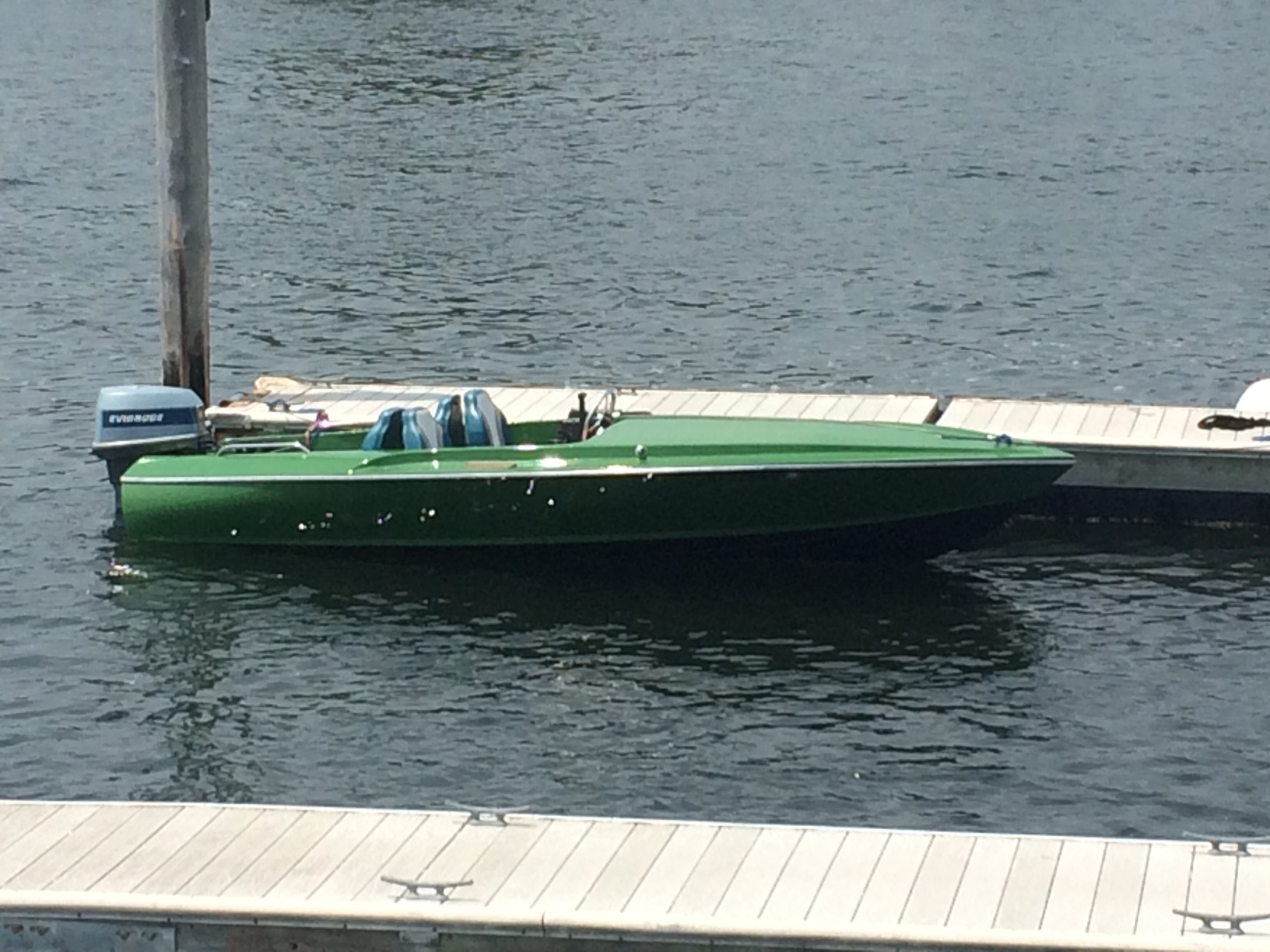

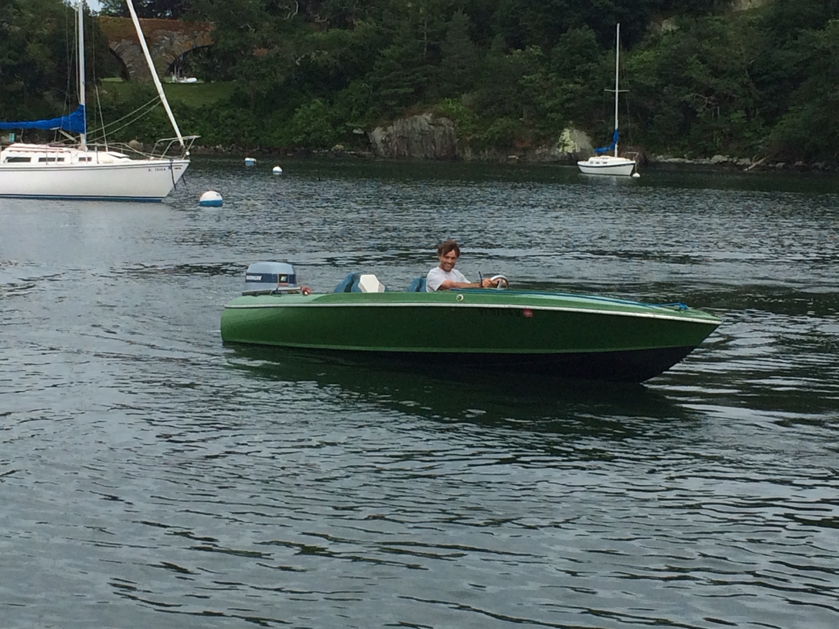

On the water! Still some work to do, but El Chapulin ("Grasshopper" in Spanish) flies again. Need to repaint the bottom and get electrics hooked up next.

Re:1969 Anacapri Speedboat Restoration 10 years 5 months ago #122788

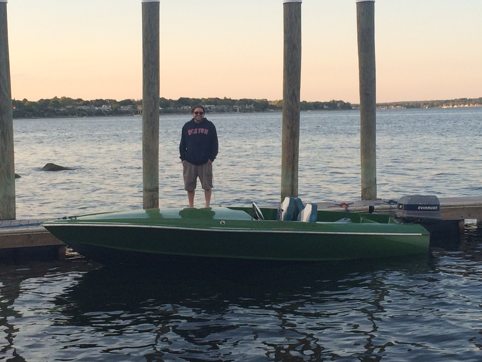

Bottom of El Chapulin is now painted with Nautix A4 T.Speed.
Re:1969 Anacapri Speedboat Restoration 10 years 5 months ago #122791
Wow, pretty boat ! Love the color choice
Re:1969 Anacapri Speedboat Restoration 10 years 5 months ago #122792
Thanks!
Topsides are Epifanes 2-part poly. Custom tinted by Jamestown Distributors, Grass Green.
