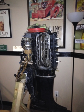

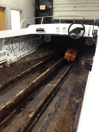

So we are under way with the full restoration of the 17' Thunderbird Sioux. So far to date the interior hull has been completely sanded and ready for new glass and wood. The transom has been completely replaced and glassed in along with new pump box. The floor is now rough cut and stringers are setting in nice. Waiting on foam and more resin to complete the floor. The 72' 800 Merc is all put back together and now waiting on a lower unit from IL. We can't wait to button her up and throw a new coat of paint on. Pics to come soon. Thanks for following.

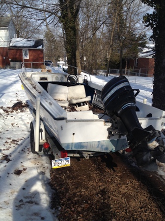

The Start......

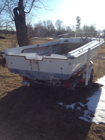

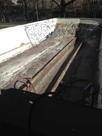

Re:1966 Thunderbird Sioux 10 years 7 months ago #121262
pretty rough when we found it....

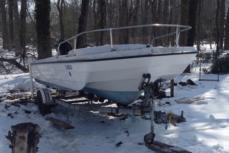

Re:1966 Thunderbird Sioux 10 years 7 months ago #121263
more pictures...

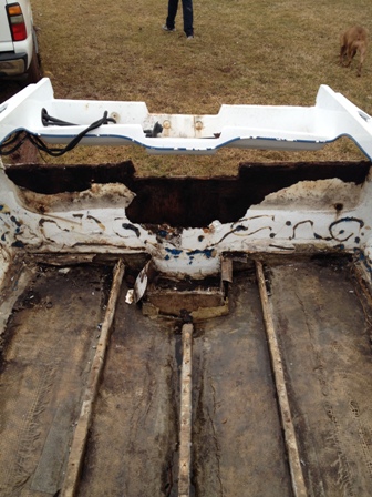

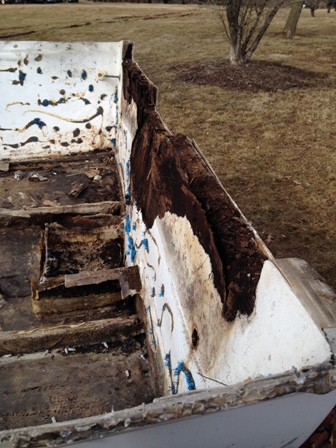

Re:1966 Thunderbird Sioux 10 years 7 months ago #121268
transom is toast......

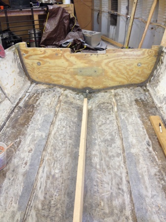

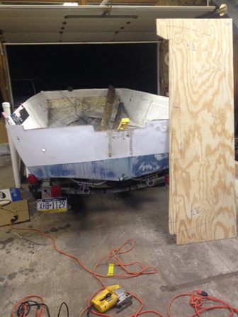

Re:1966 Thunderbird Sioux 10 years 7 months ago #121270
new transom.....
Re:1966 Thunderbird Sioux 10 years 7 months ago #121271
new transom install....
Re:1966 Thunderbird Sioux 10 years 7 months ago #121272
done with that. Not too hard at all, just a lot of fit tests then glass.

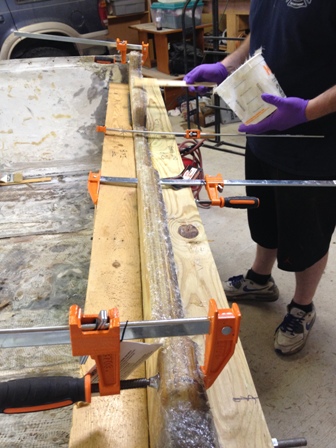

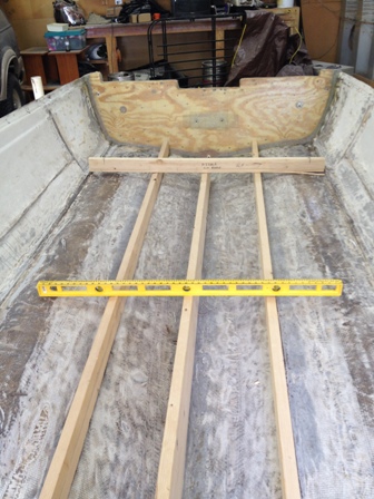

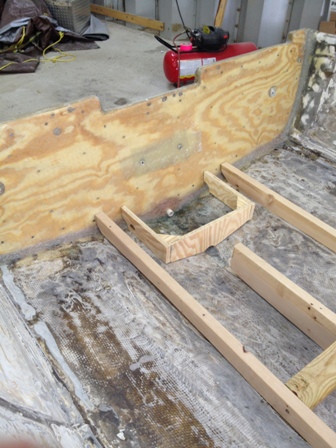

Re:1966 Thunderbird Sioux 10 years 7 months ago #121273
fitting stringers and still sanding everything for new glass and gel coat....
Re:1966 Thunderbird Sioux 10 years 7 months ago #121274
pump box fit.....

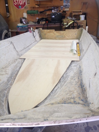

Re:1966 Thunderbird Sioux 10 years 7 months ago #121275
fit testing the floor before glassing the stringers and pump box in...more picture to come. Waiting for sub zero temps to come up to glass again. Thanks for following!
