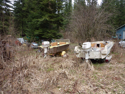

I recently purchased 2 new (to me) boats. I have some photos in Glassics Gallery under Two 60s Boats. Any feedback would be greatly appreciated.
The first one to get work is the Wacanda. It is a 14 foot Husky, as far as I can tell. The floorboard has delaminated a bit behind the seats. The floorboard is made of two fiberglass skins with some ribs in-between. I have not figured out how to re-bond the skins to the ribs. The keel has been rubbed off completely at the transom. There are numerous dings and stress cracks and a couple of depressions where the hull contacted the trailer rollers, but the hull is sound. The motor is a '61 Johnson.

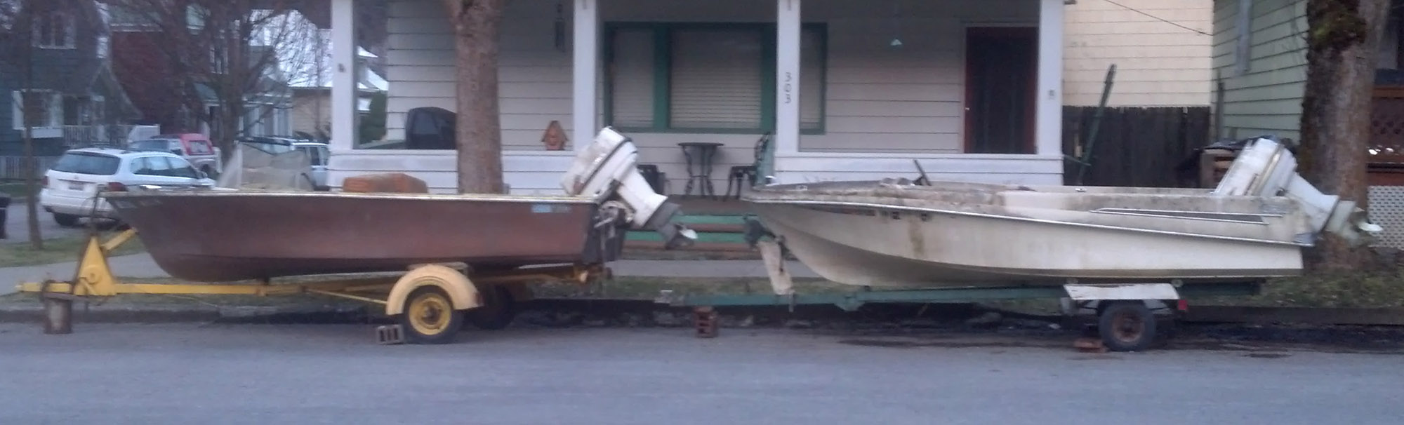

To pull the steering wheel I had to drill and tap 2 8-24 holes in the metal so it would let go of the tapered fitting. It was stuck really well. Attached is a photo of both boats once I got them home.

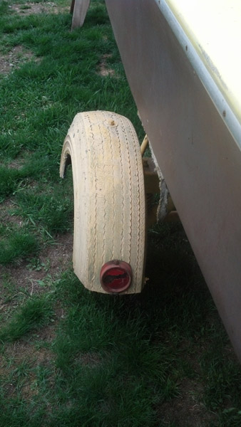

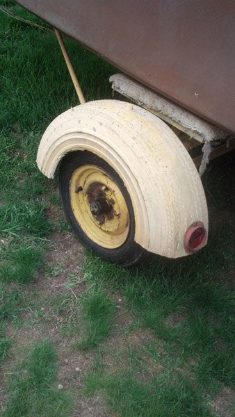

You ask about the fenders.......
They are very creative....sort of a 'redneck' north Idaho adaptation of the word 'fender.' Totally legal and focused on the reuse, renew, recycle type of strategy, some previous owner - likely the one that painted the trailer yellow I suppose - cut semi-tractor tires in half and bolted them to the fender mounts; then painted them yellow and mounted reflectors on the rear. :silly: When I take photos I will get some of the winch area.

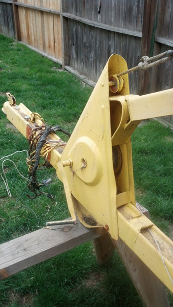

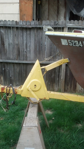

Creative fenders on the trailer for the Gull. Hopefully in the next few months I will know the makes of each trailer. I am focusing on the Wacanda for the summer. It has the ability to fold in the middle for easier launching and getting back on the trailer. Here are the photos of the fenders and winch system.

Last winch photo....
Re:My new Gull and Wacanda 11 years 5 months ago #109967
That trailer is easy to ID, it's a Tee Nee making it one of the most desirable vintage trailers that there is. The fender adaptation is really cool!
Re:My new Gull and Wacanda 11 years 5 months ago #109971
Well, ya sure fooled me, thought I was going to see some stamped steel fenders that I'd never seen before!
Definitely a Tee Nee

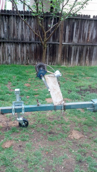

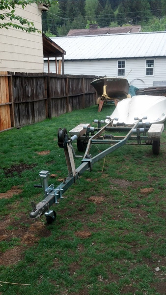

Here are some photos of the trailer that came with the Wacanda...
My small back yard, Wacanda trailer, and the boats.
Re:My new Gull and Wacanda 11 years 5 months ago #109981
Another shot of the Wacanda Trailer.

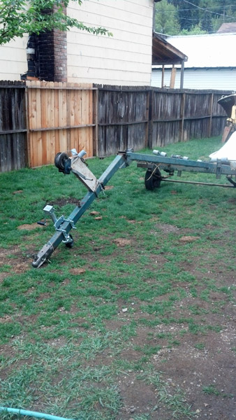

The Wacanda Trailer with the knee folded.....

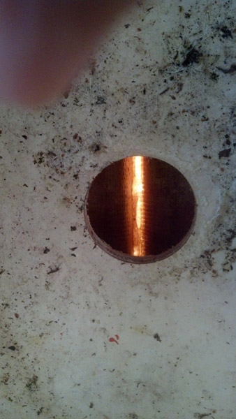

Here are the start photos of what is ahead regarding fiberglass repairs. After I got the boat flipped I went under it to remove the painter eyebolt and look at things. The first photo is what I could see of the keel through a 3inch hole in the floorboards I had to cut to figure out how to fix the delam.

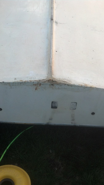

Anyone have a good idea as to how to build up the bottom of the keel?
Here is a photo of the keel at the transom. It is pretty much worn through.
Between this type of wear, the thinness of the keel, and other patches that need to be done, it is no wonder as to how the boat leaked.

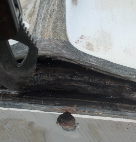

My Wacanda has a wood transom. I just opened the transom to keel area to begin some quick patch work. I found rotten wood approx. 3/4 to 1 inch thick between the fiberglass skins for the transom. My knife is stuck in the wood on the left of the photo. :angry: :S
The wood is pretty soft at the bottom. At the motor well drain holes it is very soft.
Now the question is: Can I use it this summer and fix it later or do I flip it back over, remove the deck, replace the transom, reattach the deck, flip it back over, fix the hull bad spots, and then use it? Ugggghhhh.......
Re:My new Gull and Wacanda 11 years 5 months ago #110139
Definitely address the bad transom now. If it fails out on the water it can only turn out badly! Best case scenario you crack some outer skin (causing much more work) but make it back to the ramp. Worse case you loose the whole boat! (And possibly endanger yourself and/or some loved ones or friends!)
Just my two cents, but it's just not worth the risk.
Re:My new Gull and Wacanda 11 years 5 months ago #110147
Hi Mark......
Thanks for that reply and good counsel. I am concerned about the same thing. I plan to get some pro help setting a strategy for the repairs in the next few days or a week or so. I may move my efforts to the Gull since this will be a LOT more effort.
I can't take the boats anywhere until the road work on our street is complete. They just poured new curb and will be paving soon.
Re:My new Gull and Wacanda 11 years 5 months ago #110269
After chatting with a professional that does boat repair here in Northern Idaho it has become clear that repairing the Wacanda is too big a project for me at this time. To do the transom 'right' it means popping the deck and working from the inside of the transom. When I began the project it was assumed that everyone saying the Wacanda was all fiberglass was correct. However, the transom on my Wacanda is plywood and very weak.
