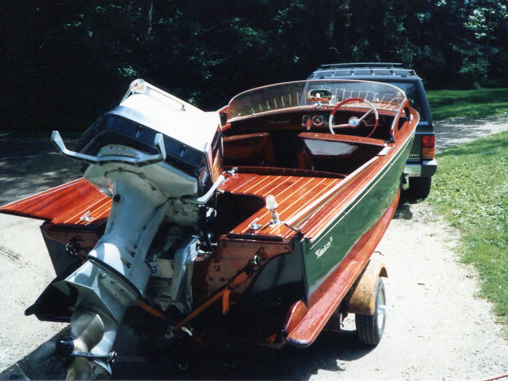

In other posts I mention the 1957 Fleetcraft Imperial that has been in my family since new. I redid it in the early 90's and now deck delamination and general wear and tear forces me to do it yet again. All wood is off and I will repaint the hull soon. Original dark charcoal outside and light gray inside. There is no internal wood to rot as this is a pressed fiberglass single layer hull about 5/16 thick. It depends on the Phillipine mahogany wood parts for strength. I removed the pounds and pounds of silicon bronze fasteners, some requiring a hammer type impact driver. Good isometric exercise. The 3M 5200 I used last time was fun too. She has an interesting hull shape with a very buoyant bow form, and the boat designer, who I talked to long ago, said this was to provide a dry ride for 3 or 4 up front in rough water.
I plan to use a 1957 Merc Mark 55 that I am redoing instead of the 1959 Evinrude Golden Jubilee fat fifty my uncle used since he wanted to pull skiers. That was a lot of weight for the narrow low transom and resulted in a 2 inch freeboard over the transom cut.

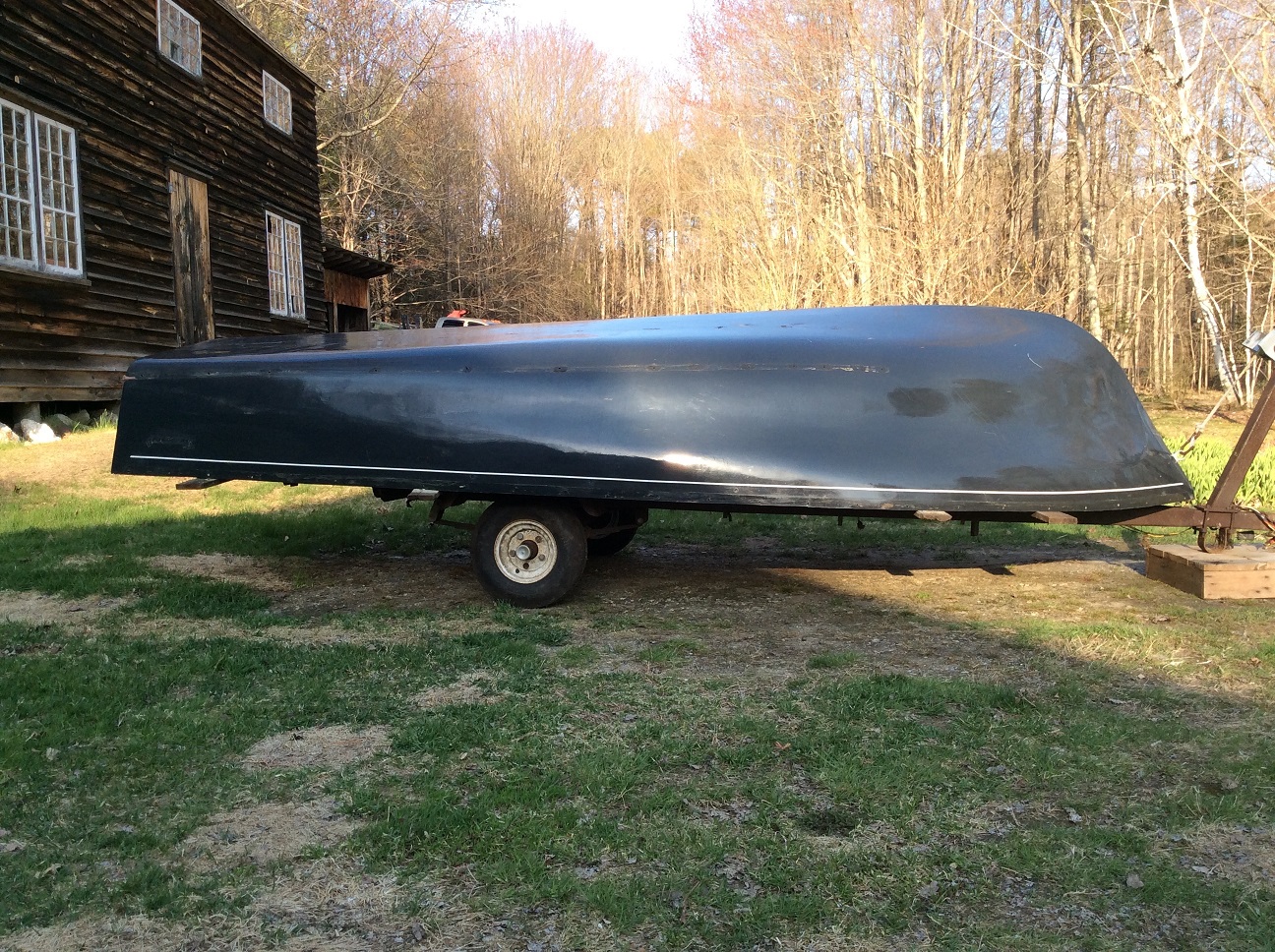

I have not yet sanded and prepped the hull and interior, but when I did it 25 years ago I used Imron two part polyurethane paint. It has held up remarkably well, but has some bad scratches and scrapes so I am doing it all again. I did not spray the Imron, which can be VERY harmful if breathed, and I only had an organic vapor cartridge filter mask at the time. (My lungs still work well). I used the roller and brush tip off method outdoors. It came out quite acceptably from 10 feet away. I'm not sure what I will use this time. When I did it last time it had fiberglass pox and I had to use epoxy to fill and smooth what seemed like thousands of tiny pock marks from uncured resin leaving the hull. The west system epoxy with graphite filler I used took care of that plus sealed it from further damage. Did your Fleetcraft have this type of early fiberglass problem?

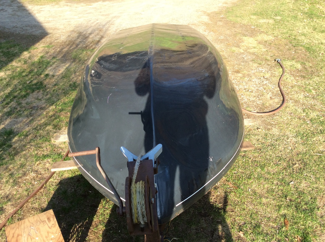

Still working on the hull. I have it repainted on the outside, then wet sanded and polished the Imron paint. I spent this weekend re-driving the silicon bronze screws to attach the keel, bilge keels and the interior keelsons and transom knees. All the other wood has been stripped and needs a final prep for the mahogany aniline stain and varnish. I may replace the inner and outer transom wood with 3/4 Meranti, but that can wait until I see how the beat up original wood turns out stained and varnished. So far I have not replaced any of the original wood except for the front deck.

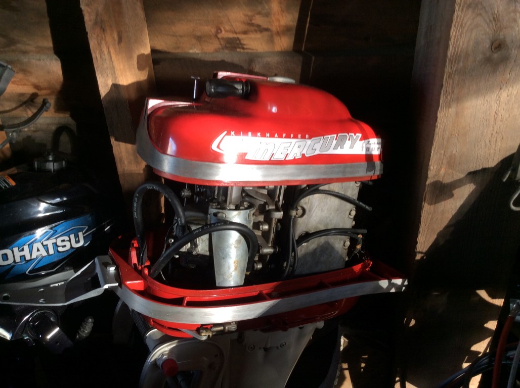

I also have the 1957 Mercury Mark 55 completely rebuilt and repainted in a nice Ford Red and Ford white that is close to the stock Mercury Sunset Orange and white.

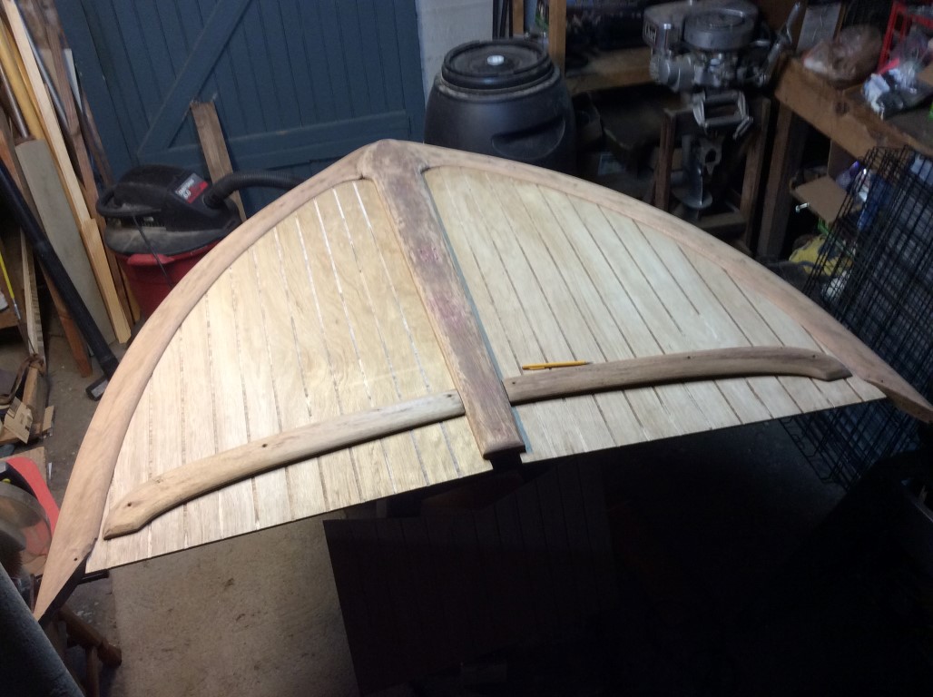

Yesterday I cut the new front decks and the front seat deck from Meranti marine ply. I used the table saw to cut the deck grooves and dry fitted the decks to the center board and gunwales. I will be putting stain and a coat of thinned varnish on all this, but final fitting will have to be done on the boat, probably in the spring.

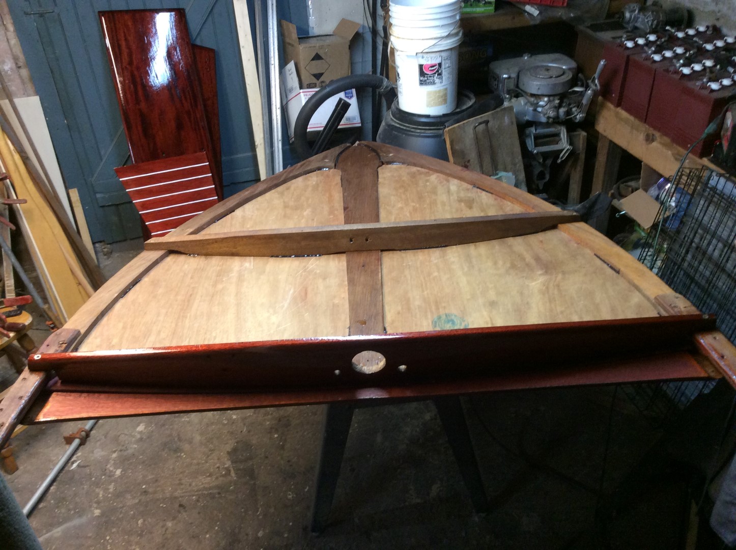

Continuing to pre work the wood on the Fleetcraft prior to spring, I have been staining and putting initial coats of varnish on the pieces I have stripped or rebuilt so far. I also did the striping on the front and rear decks. I used to have steadier hands, but it turned out reasonably well. There will be a few more coats of varnish after the boat is assembled, but this will get things going sooner when better weather arrives in Maine. it is amazing the amount of finish this old mahogany soaks up, and I should probably have used a filler first, so fewer coats would be needed to level.

Will anyone be crawling around on the deck during usage? If so, it might be advisable to add some additional under deck bracing. My hull is fiberglass and suffered surface cracking from crawling around on the deck. The rebuild has a significant amount of support structure which resulted in a very stable deck.
Re:Another Fleetcraft restoration 10 years 8 months ago #120081
Thanks Kern, Since this is the second time I have done this, I am going to do my best and then take better care of it when it is done.
I have only got the foredeck together enough to get 3-4 coats of varnish on it so things go quicker when I can work outside this spring. The deck is pretty rigid but is not intended to walk on. unlike the rear deck, whick is made of 3/4 inch mahogany planking, the front deck was 1/4 mahogany plywood. In all the years it had been used it was OK,and that varnish is not great to walk on when wet. Still You are correct that it could be stiffened up, and I intend to put some 1 inch rigid foam pieces shaped to fit under the deck panels and then brace them to the gunwales and center support so they support the panels. the boat had nearly no flotation in it when new, and I intend to fix that with under deck and seat rigid foam that is not visible and drains well.
