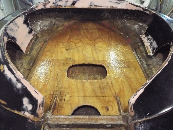

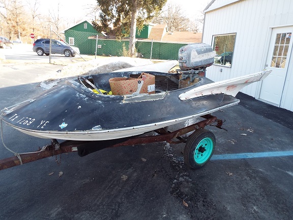

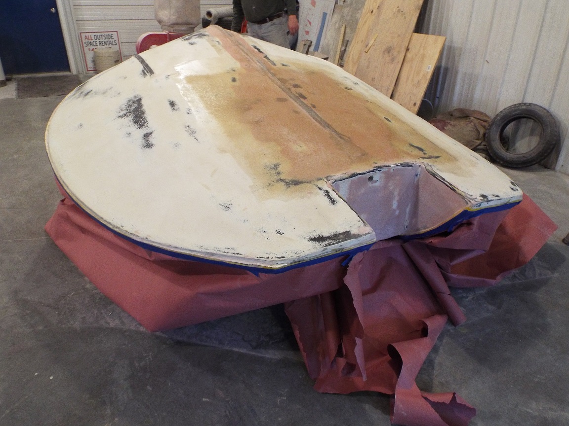

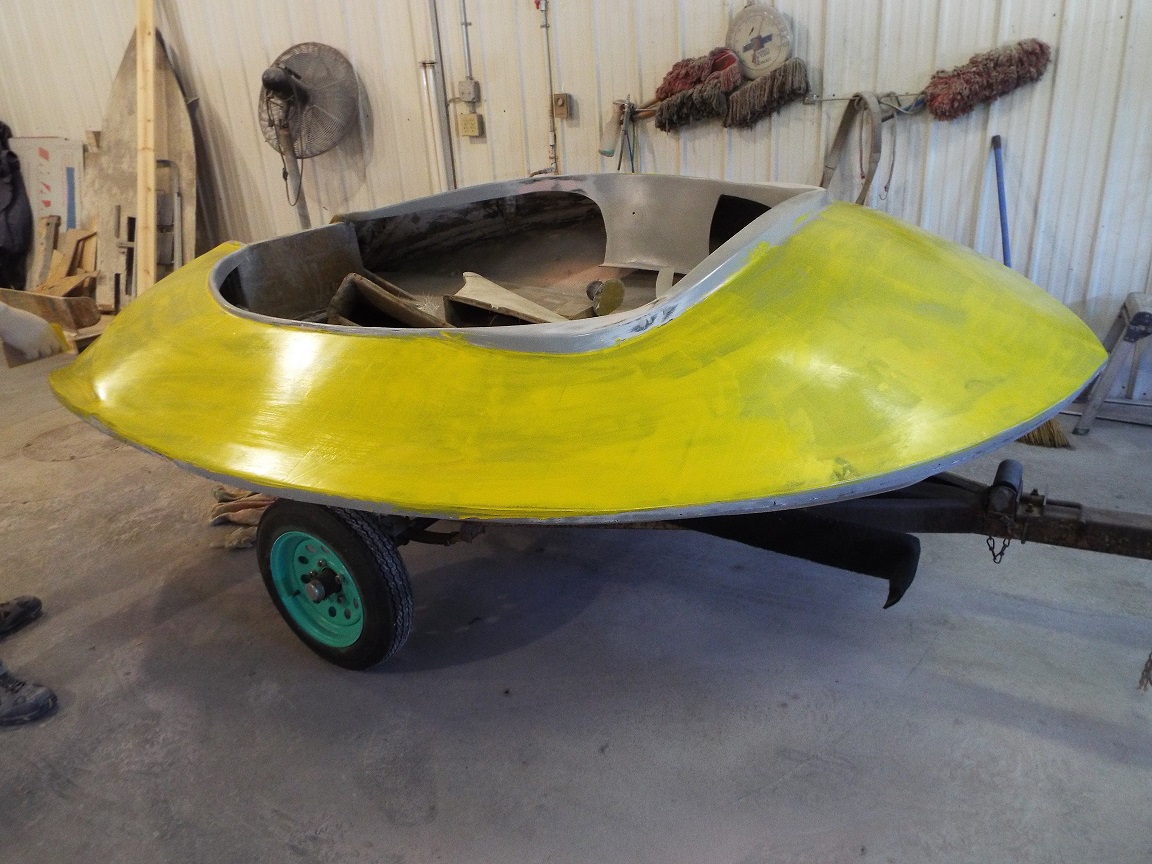

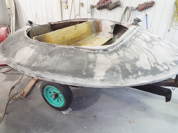

We finally got a good start on this and wanted it in the proper sight. it has been ground down to cloth[top,inside],it has new stringers and a floor,seat,transom, the top has been filled with cabosil and gelcoat for color and fill pin holes,then sanded,primed,and sealed, it has now been gel coated,and curing,it will get sanded and buffed later,getting rolled over,I have an engine,evinrude lark[like the original] ready to go on it,will up date again Bill

What is tha first layer of yellow ? A primer ?

We mix resin with cabisil and sqeegie it on to fill pin holes then sand it all down then primer or sometimes skip primer,this time we primed,but we use the color to help see and acts like a primer,Bill

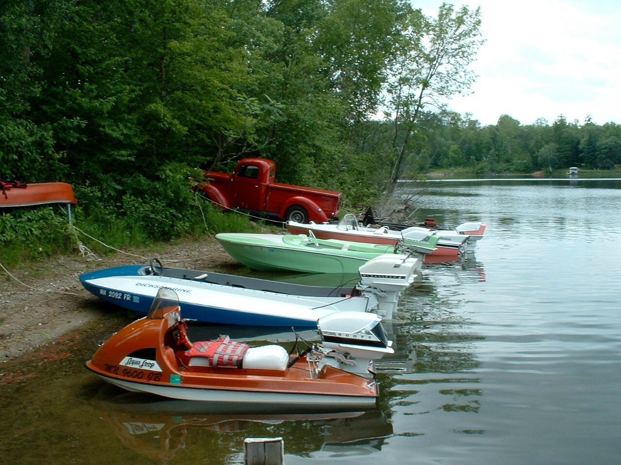

I am looking forward to Bill and I getting together on a lake soon. You know what would be fun is to have a mini boat met. Like Bills Dalcraft, and an Aqua Loop, CirCrafts, Wasps, Mighty Mights, motorized surf boards, Filvers, ten foot GW invaders, I am running out of names! But you know what I mean!

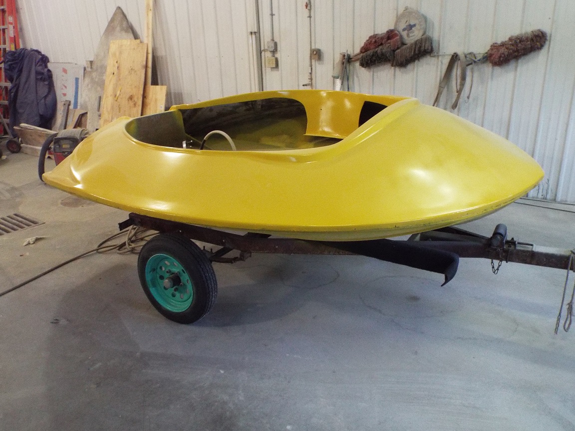

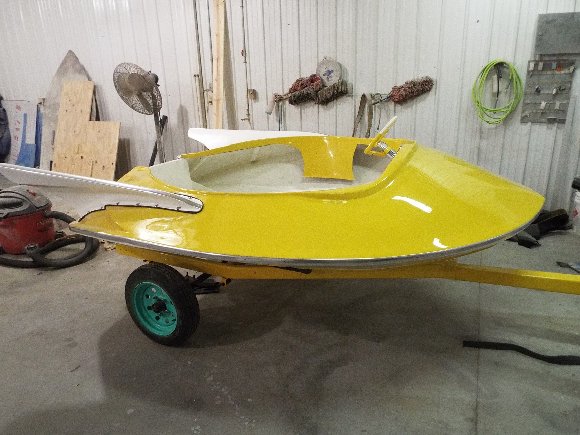

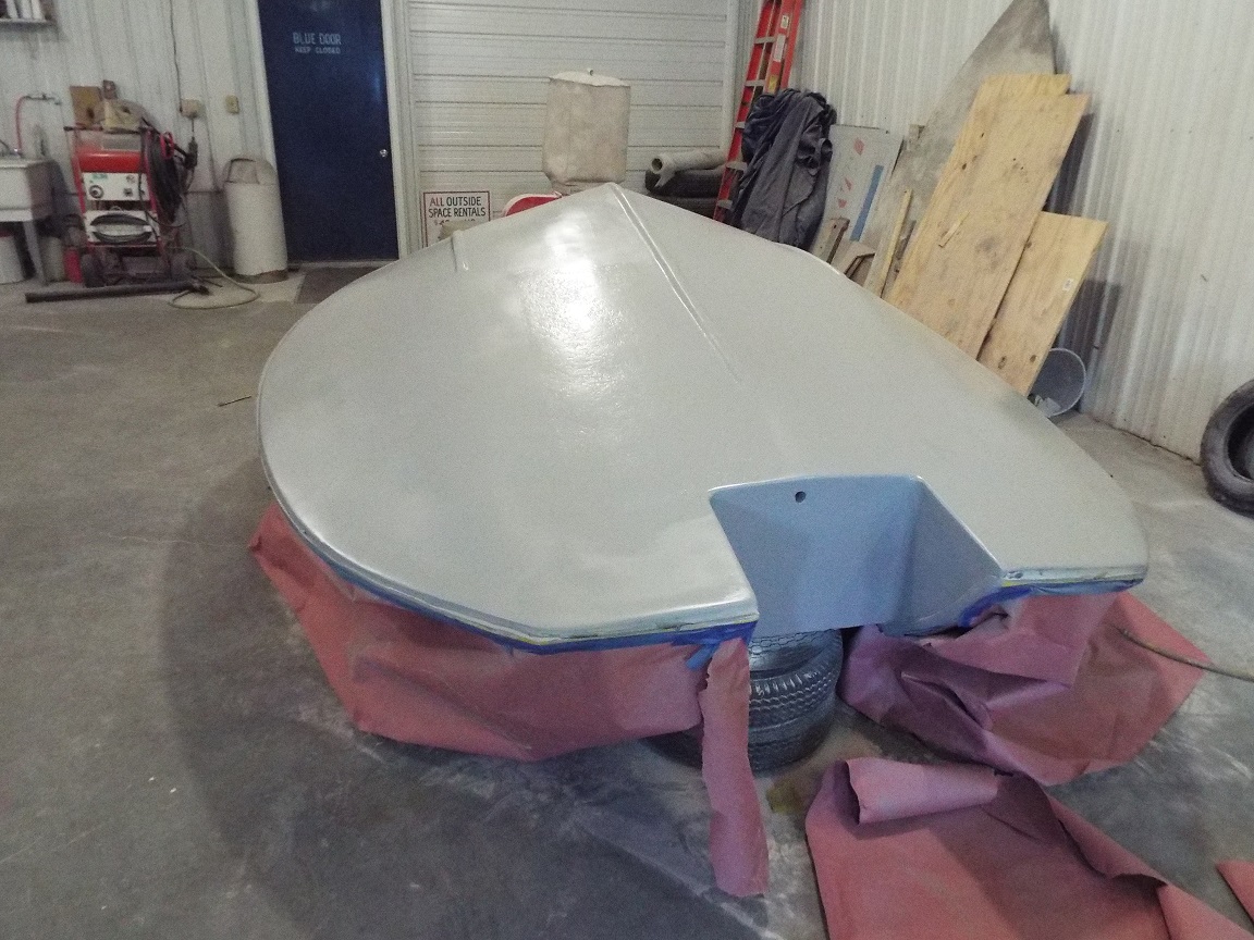

OK Del I know you are going to want to race,,I can put 100hp merc on this I do have enough weight to counter balance hahah Here is an update along with Del stand up 7ft saucer boat ,also change of color for bottom,has to be white,with white fins,with yellow deck, Bill

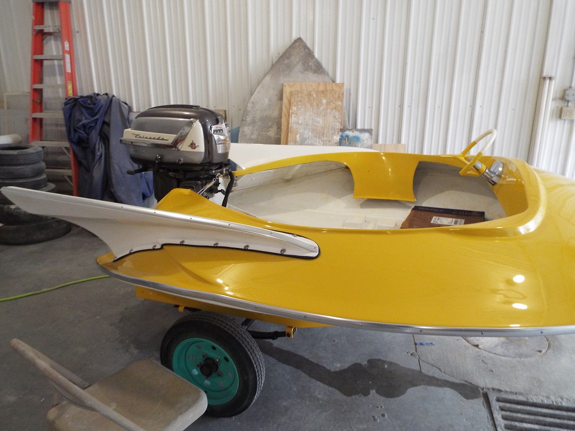

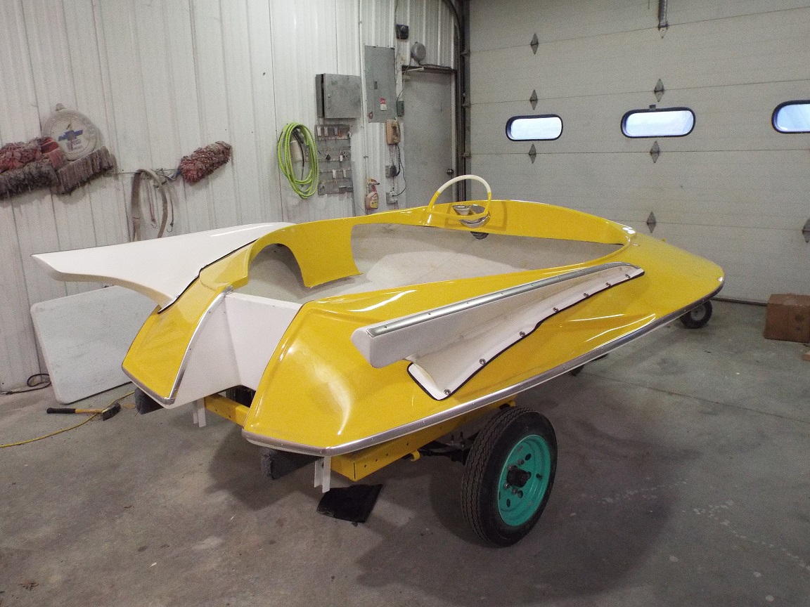

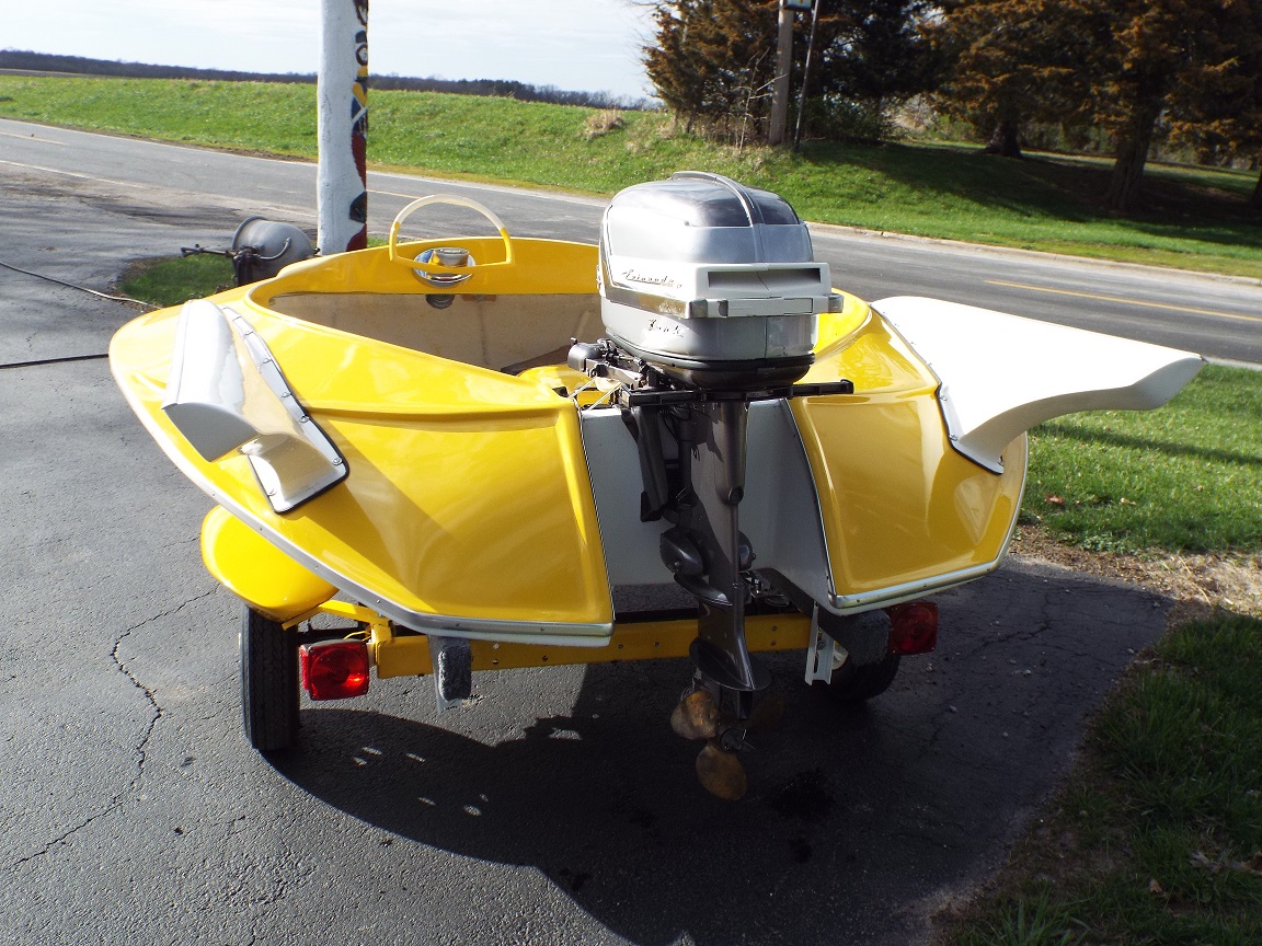

It is getting closer,rub rail,fins,steering wheel,trailer is blasted powder coated[didn't like finish,so we painted] now we need to make a weird fender and paint rims,install winch stand,inside boat is all gel coated and webbed,pinstriper comes next week I hope,waiting on seat to be covered,I would listen to options on names,lemon drop?Jetsons? c u Bill

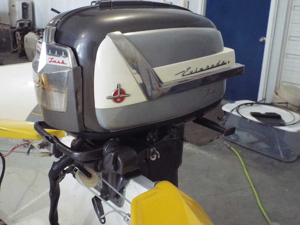

OK,, The steering is in floor webbed and motor is on, this motor has been rebuilt and is real nice,paint control box and solenoid cover this after noon,still a few more days to help name this thing on different thread,Thanks Bill

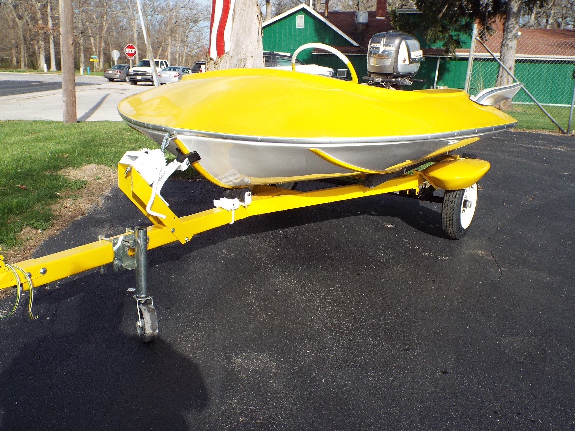

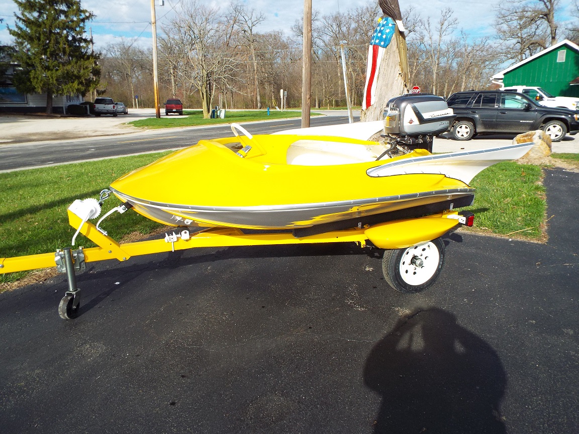

we finished trailer,erik made a saucer type fender,still waiting on pinstriper and seat covering,it is going to be called the Jetson s on one side then pic of them on the other side,it is going to back room tomorrow c u Bill

Bill as I said on the chat last night she looks outstanding!!!!!!!!!!! I think the pinstriping will really enhance her style.

The seat is finally in now just waiting on pinstriper

Re:1959 dalcraft [saucer outboard] 11 years 6 months ago #108746
With that beautiful Lark on this out-standing saucer and those big wings she is sure to fly.
Call the trailer SL-1 (Saucer Launcher 1) LOL
