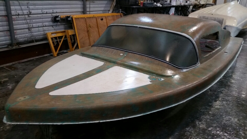

Had to grind the deck down to fiberglass cause there were so many crack in the gelcoat.im going to put couple more layers of new fiberglass on it before I do the body work.the hull is almost done I put a layer of waxed gelcoat on so I can board it off to check for high or low spot before I spray the real color on.

Wow a lot of work but she's coming along nicely. She'll be awesome when you're done and can't wait to see it.
Re:so far so good. 11 years 10 months ago #103669
Nice job!
