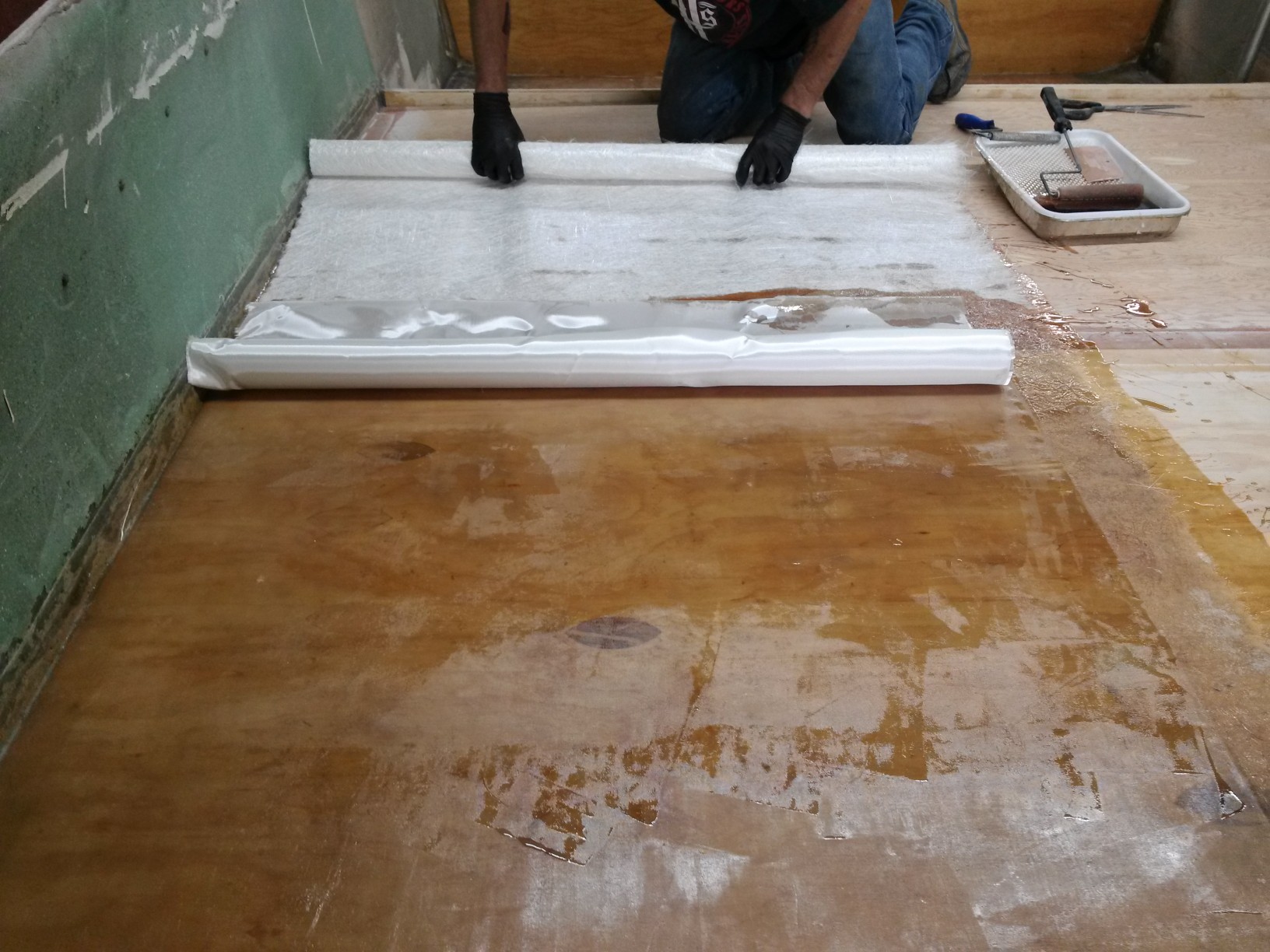

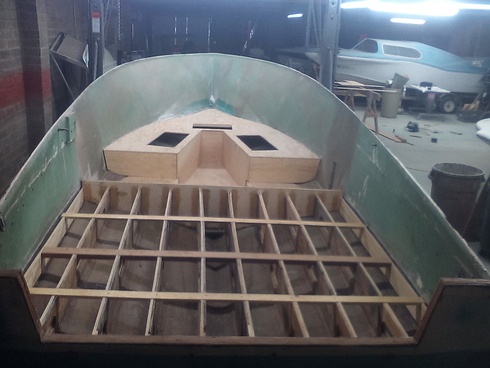

#1 Make sure your stringers are sound. Laying a good floor over bad stringers is a waist of time and money. Your floor will fail. Many boats , like yours, have 3/4" plywood stringers or 1x4 or 1x6 wood stringers, which is barely sufficient. We will scab on an additional layer of plywood to each stringer, if we have any doubt in their structural integrity. We have also added cross bracing, as in the photo below. We often wrap wood stringers in 6 oz. cloth before installing the floor or at least paint the stringers with resin.
#2 We replace all 1/2" plywood floors with 5/8" A good Marine plywood is best, but, exterior A/C plywood will work. We paint the bottom side and ends of the plywood with resin. I don't like using screws to install boat floors. I will use a few stainless deck screws were I'm certain that they will hold. We glue down our floors using 3M 5200 QUICK DRY adhesive. Regular 5200 takes a week to dry.
#3 You must tab your floor to the boat hull. We use 1 layer of 4" 8-10 ounce fiberglass tape followed by a layer of 6" tape of the same weight. When your tabbing is dry you must sand it to eliminate any raised spots and assure adhesion of the fiberglass that you will lay on your floor. To answer your question; 1 layer of 6 oz. cloth will NOT permanently waterproof your floor. We use 1 layer of 1.5 oz. chopped strand fiberglass mat followed by a layer of 8 oz. cloth. We install both layers simultaneously. This takes a little practice to do, so.... you may want to do it 1 layer at a time. You may use laminating resin to eliminate having to sand between layers. Laminating resin will not cure for 8-12 hours giving you plenty of time to get the 2nd layer down.

I'm not certain, but, believe the packaged cloth a Home depot is 6 oz. and the mat is 1.5 oz.
I personally would NOT use it on a floor. The creases from being folded are almost impossible to roll out, leaving air bubbles when wetted with resin. You can use a roller to coat the bottom side of the plywood with resin. We use small diameter 6" foam rollers. At least 2 layers of tabbing are necessary. We use 8-10 oz. cloth because it conforms easily to the floor to hull transition. Biaxle or mat is tougher to lay in this situation (just my opinion). You want to thoroughly saturate your cloth or mat with resin as you lay it. You then want to remove all excess resin, in the process. There is NO strength in resin without the fiberglass material. Excess resin will assure that your floor will crack.

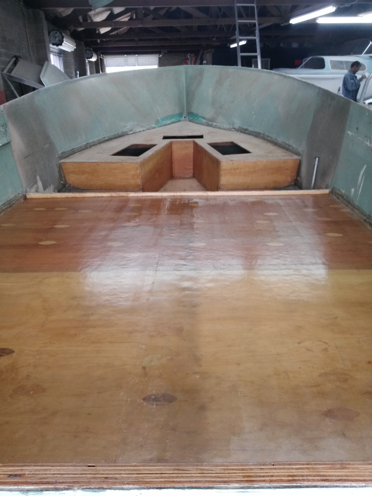

Just got the floor done this weekend and it came out perfect..i wish i could post pictures from my phone on here but dont know how..or at least they dony come up..but definitly important to have a game plan and every step and layer ready to go luckally i didnt forget to cut any of my pieces at all since i layed them out before any resin was mixed..i used sparkletts cups pre poured ..thanks to my dad while he was handing me cups of resin and mat made it easy to stay in the boat..i worked from the front and worked my way out of the boat to the rear..thanks for everyones input very helpful! I will work at posting pics..
