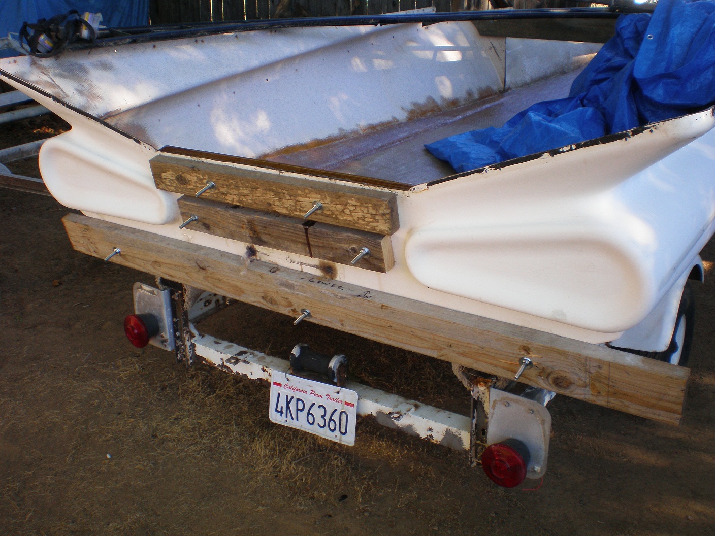

Here's what I have done The boat is a 1961` Admiral cabin crusier 17'4"
and is powered by a 1966 Homelite 55 Gran prix.
When I got the boat in 2000 it was a mess the po's wife had taken a axe to the whole cabin top bow to stern all windows took me 3year's as we have short summer's here in N. Idaho.
Ok now all the cabin and window's are done/the hull and upper top deck are one piece/fiberglassed together at the factory. So I just can't see distroying the intregitery of the hull to upper deck by cutting as the rear of the transom is connected to the top deck.
the transom is also supported with 1/4 " angle iron that is cut to fit over where the motor sits on it then the other portion goes across the outside of the transom
The reason for this was the boat was used in Flordia then found it's was up the Missisippi for about 6 year's then to Oregon where it spent 15 year's there in the Ocean and wound up here in n.Idaho
sitting in a farmer's field Also it had A Big Johnson V4 or 6 hanging on the transom/ which I left with the Farmer as I love my Homelite motor's. so maybe that's why the angle iron. as the transom does not seem to flex.
P.S. I am going to New Mexico to pick up a 1961 Admiral 17'4" runabout that was purchased in New York but is badged Admiral Tampa Flordia Now how cool is that 2 Admiral's The runnabout is all papered and titled from the original owner.on a 1961 gator trailer.

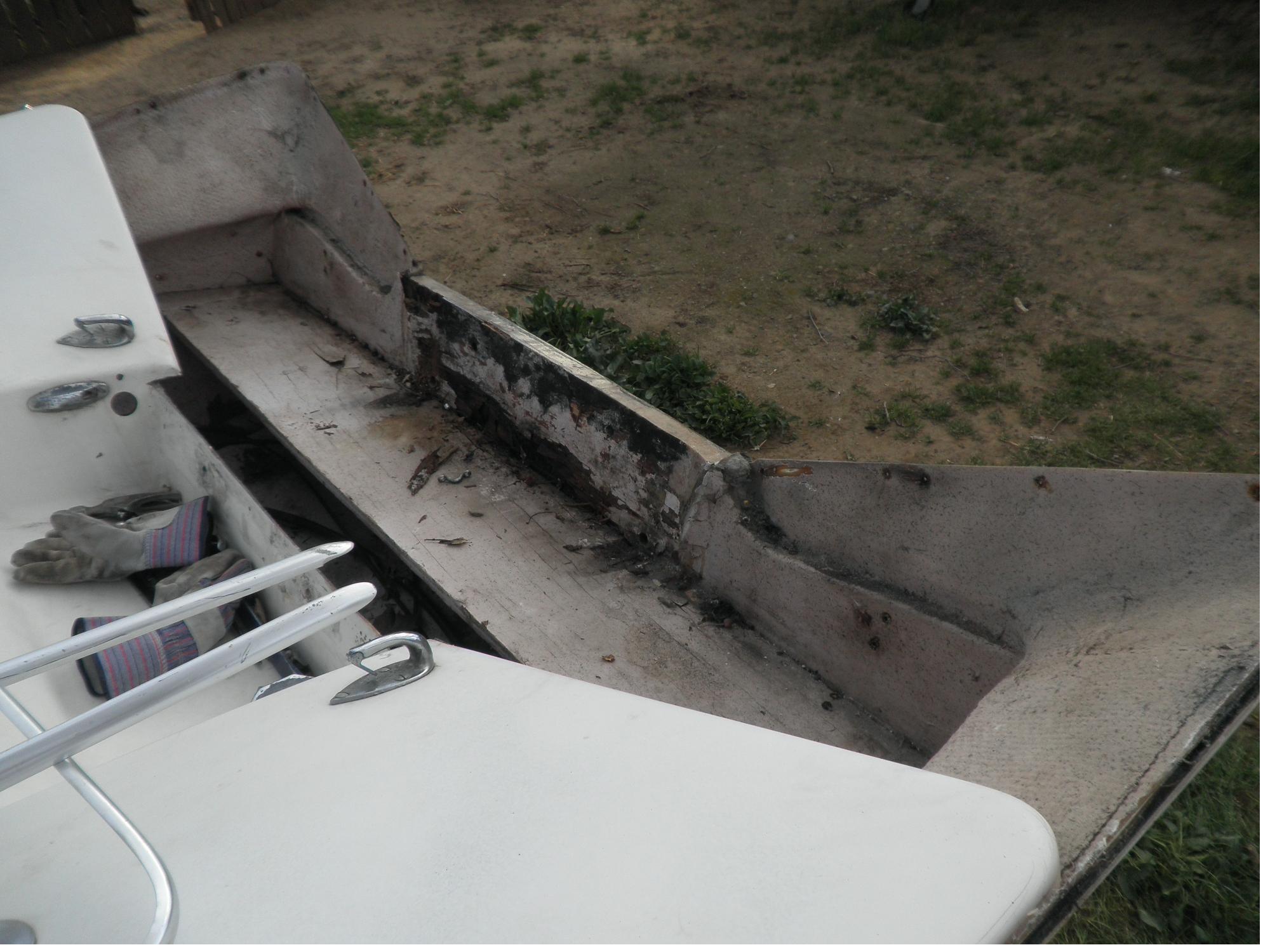

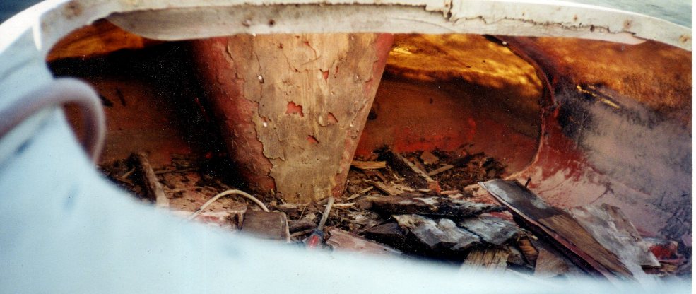

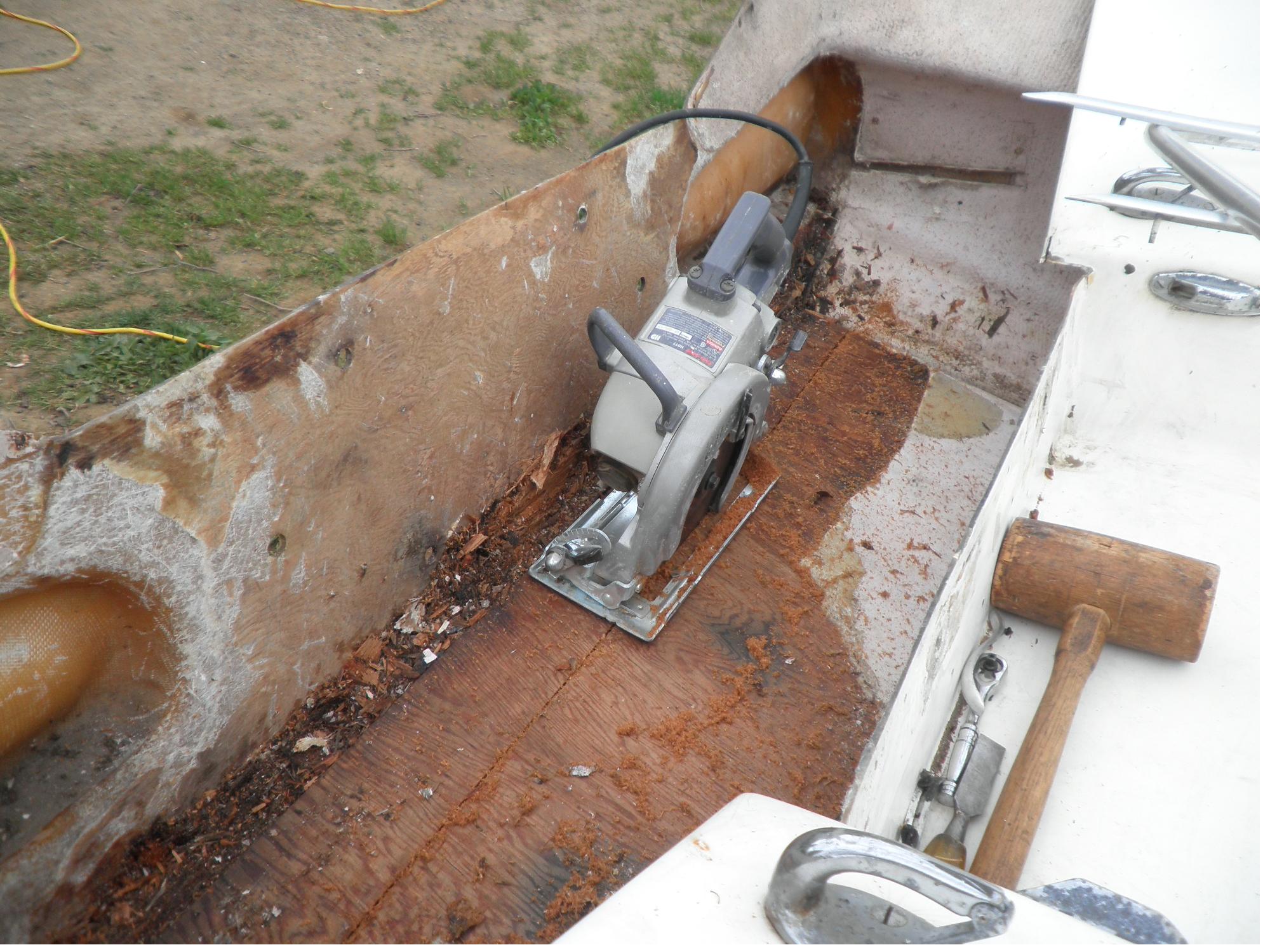

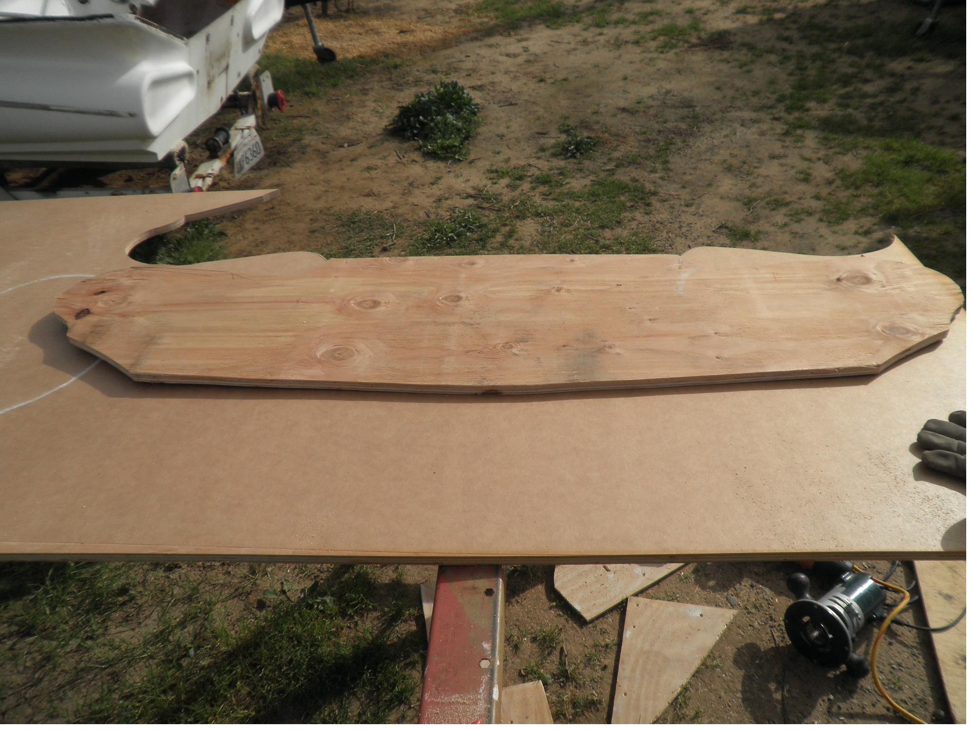

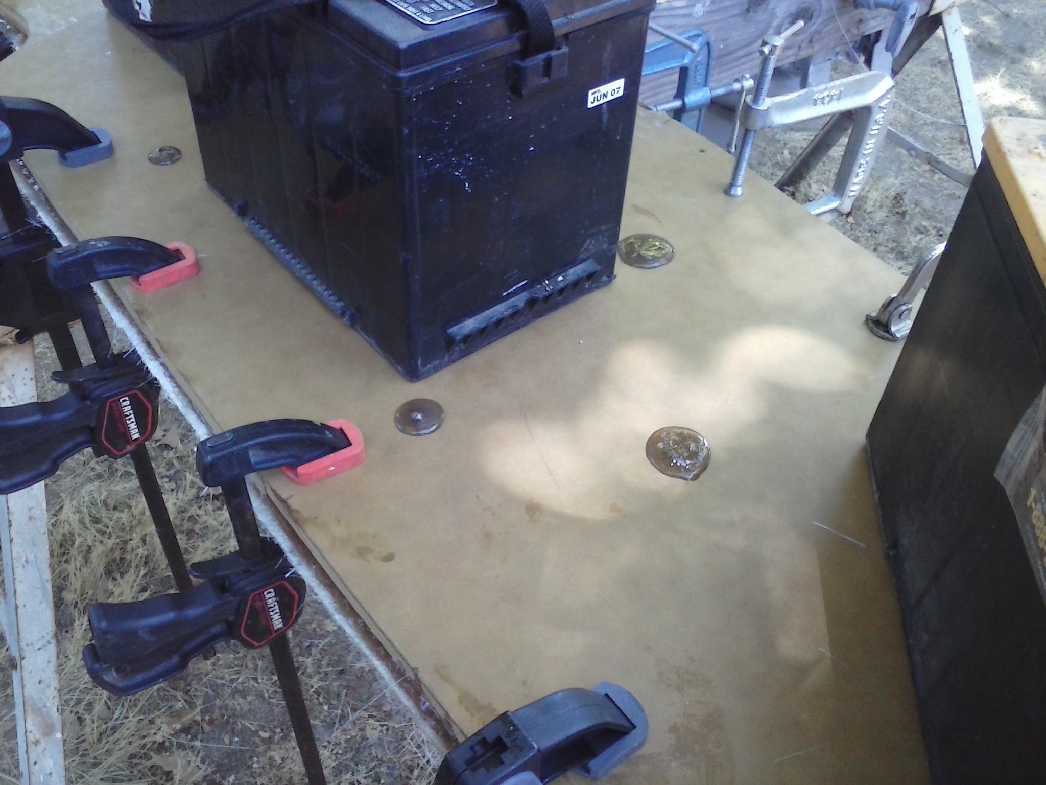

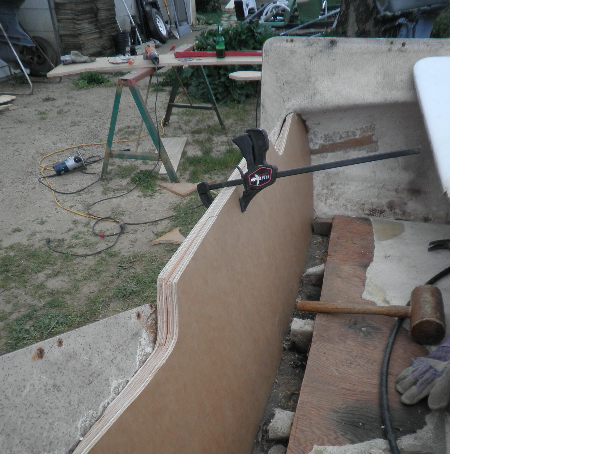

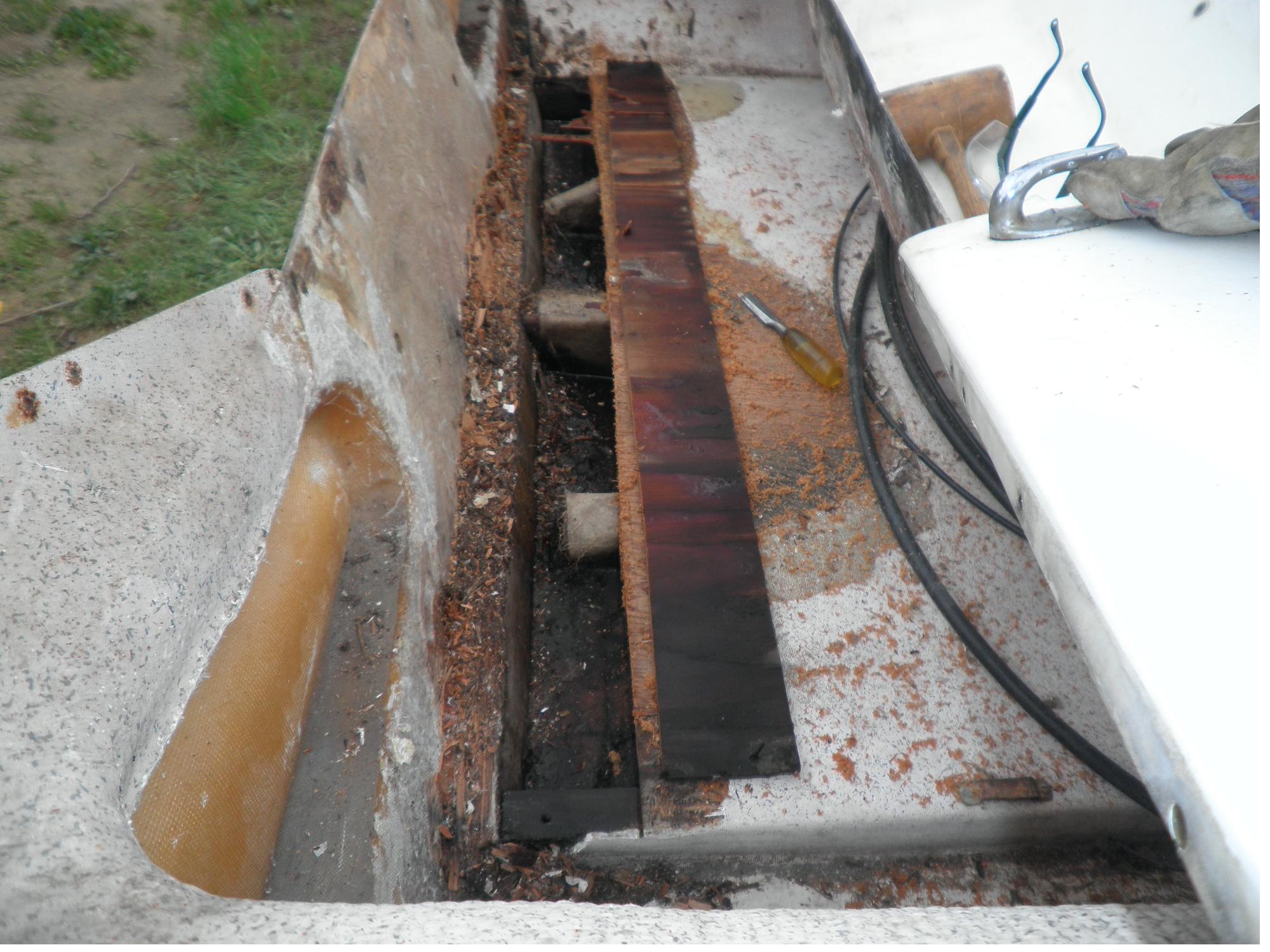

I had to rip out the entire transom and air box on my Flyer as it was all rotted and demolished from the PO running a Johnson 75 on it. I replaced the transom with a mahogany plank and restored the air boxes with embalmed marine plywood and mahogany supports all coated with CPES and fiberglass laminated with laminating epoxy for wood.
