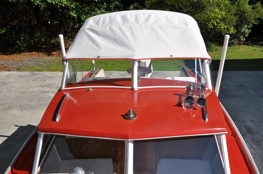

My Wife and I own a 1960 Glasspar Seafair Sedan and they came from the factory with deck "scuppers." Personally,...I like them!
Our boat stays inside year round, so dirt, leaves etc. don't get into them. That is what some fellow Glasspar Owners DON'T like about them.
I like them because when I wash our boat the wash water runs down and out the scuppers and doesn't run inside the boat. It does the same thing in the water. I posted a picture for you to see how they look on our Seafair Sedan. It is an older picture of the boat.
You will see the "scuppers" on the edge of the top deck Brian.
In the attached picture you will see one on the right below but in line with the dual horns.
