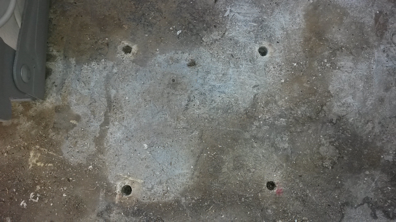

My 70 vip originally had back to back seats that were missing when I bought it. To try it out I mounted a couple of folding seats on pedestals. I used rivnuts to install them. however yesterday the following happened.
Thes are 1/4 -20 stainless steel Rivnuts 1 inch long. obviously they spread out at the top not under the wood and fiberglass as I thought they wood.
Any other ideas on mounting to a floor I can't get under. The original seats were only using 4 per corner no. 8 wood screws.

You might try some longer rivnuts, and epoxy them in place this time. (Something like Six10 adhesive sealant, or the equivalent) This would also seal the holes in the floor so moisture doesn't get in there a start to rot your sole.
The other option would be to build some 3/4" think plywood "plates" to be glassed down on the floor. You could position some bolts through the bottom with the threads sticking up to mount the pedestals on.

I was thinking of something similar, 3/4" plywood plates, with stainless T nuts inserted from the underside, and attached to the floor plate with 3m 5200.

We generally use six to eight 1/4" or 5/16" stainless steel lag screws. If you can pull them out, your floor is shot.

These are the Ultimate in Stainless Marine Toggle Bolts. But.. I too agree with the 3/4" Glassed In Plywood Mounting Pads and Stainless T-Nuts being the optimum mounting method.

I have the marine toggle bolts on order but think I will do bothe that and the glassed in 3/4 inch plywood with t bolts also.
