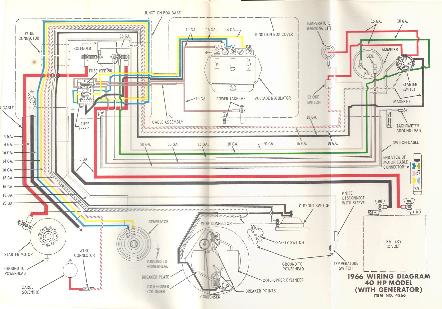

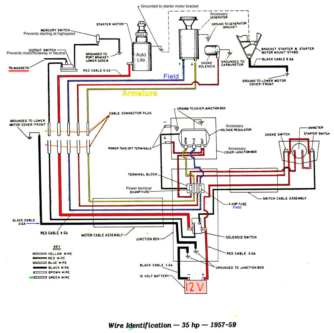

Most electric-start outboard motors have the provision for power-takeoff either at the junction box and/or ignition switch, all of which were protected by fuses.

The Johnson and Evinrudes seem to have an accessory position. Although even on the 40 HP selectric on my VIP the switch was in the dash but it wasn't used for accessories and neither was the junction box power takeoff.
