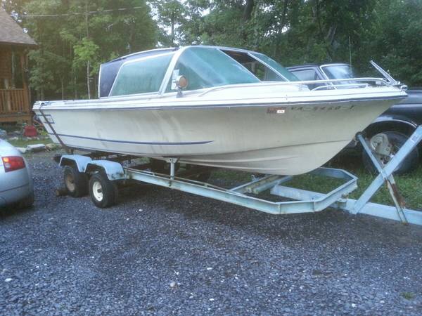

So my wife is going to kill me... I've committed to buy this beauty for $300 as it sits. The head is off the merc 165 but the floor, stringers and transom are solid. Think it's a good deal or should I bail?

Its been in dry storage for years, the outdrive and hydraulics all look good but the head is missing, it was on a pallet next to the boat that was accidentally picked up by someone that bought some stuff from the storage area and is now MIA. I found a 165 that's complete on a pallet for $700 but I agree Id love to re-power it with a newer V6 or a Volvo!

Re-powering usually means a different out drive along with wiring harness,engine mounts and on and on.Forget about the Volvo ,now your talking about cutting out new holes for the drive etc.165's are all over craigs list/ebay and bone yards for cheap,I would explore that route or try a engine rebuild shop and see if they have any suggestions or one laying around before dropping 700 for basically a cylinder head.Yep it looks to be in great shape and if all you do is throw a head on it, even better.Love the hard top,I drive by one every thursday thats rotting away in some guys yard un-covered of course and I just shake my head.

I met the seller last night and its in my driveway! Unfortunately the hull is damaged, where the front motor mount is on the starboard side it’s cracked. When they pulled the head they had to remove the front motor mount, they blocked the front of the engine with sections of 2x4’s, I’m assuming when they towed the boat like this the weight of the engine punched down through the fiberglass. It’s a shame because the boat really would clean up and seems to be sound otherwise. It was last registered in 2005. It came with titles, but the title to the boat was signed over to someone that never had it put in their name. I’m going to just part the boat out and scrap it.
The trailer on the other hand is awesome. Its title says LONG as the MFG, it’s a tandem axle tilting trailer that is almost overbuilt. Since I don’t need a boat trailer but could use a good utility trailer since my Tacoma is a short bed I’m going to put some boards on it, move the axle assembly forward and use it!
The outdrive has a hydraulic pump for tilt trim and the hydraulics look good, the steering is nice and tight and works great, it shifts with no issues and there are quite a few of the engine parts still there. It also came with a really nice tiger oak handmade 5 step ladder and some vintage nautical gear like paddles and an anchor etc. The dash and gauges, speedometer etc. are all in great shape too. The port side of the hard top is missing its window and the seats were removed and missing. Overall a great source of parts! If anyone is looking for any Aristocraft 19 specific parts let me know asap, we can work something out.

Jim, I just sent you some pictures. The bow rails are there but are gouged up from something, they might be able to be sanded and polished back out, not sure. Also sadly the center windscreen is a mess, its not cracked but the plexiglass is roached from sun and age. Im going to pull the outdrive and fuel tank and probably the gauges and controls then haul it to the landfill to get it off the trailer so if anyone wants the hard top come get it, if not its got to go!

The boat is gone, sorry to those folks that are looking for parts, I had a guy offer me a deal for the hull as it was and he took it off my trailer!
