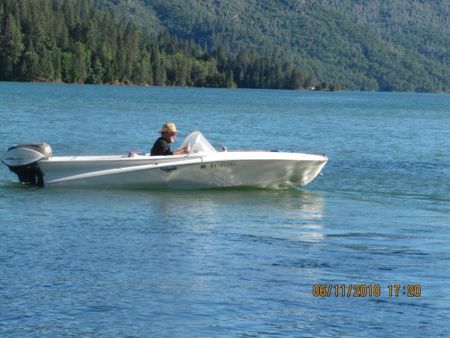

Been meaning to post this for 2 weeks, but just haven't had the time. I finally got the 1960 Reinell Jetflite out to run under it's own power on June 11th. I have owned the boat for just under a year now. I forced myself to not fiddle around with the boat so it could remain as original as possible. It came fitted with a 75 horse Johnson that looked ungly and out of place on the boat. That motor got fired. I then dropped a nice 1963 Merc 650 on the boat just to see how it looked. Nice but just a bit out of place being an all black motor. I then found a 1961 Starflite III in very nice unrestored condition.. price: free. I knew this was the motor for the boat instantly when it was place on the transom.
I then spent a couple weeks doing a couple tweeks to the engine to make it perform a little better (Pertronix 50K volt coil, reeds & transfer port covers from a Starflite 100. I had to reinforce the rotted transom with polyester whool & poly resin that I cooked up myself. Stuff seems to work great.
Dropped the boat into the lake, hit the key & she instantly started. The last time she was on the water under her own power was 1987. Tried the shifting & throttle, all OK. Idled out past the no wake zone. I have a 2 blade speed prop on the boat that has a very steep pitch. Boat goes about 7-8 mph at idle!
I put it up on plane & checked the steering for a moment, got a feel for the boat & then buried the throttle. What a thrill. The faster the boat goes, the flatter it rides. Turns hard enough to break your neck. At 42 mph you can take your hands off the wheel & she stays dead on course. No torque steer at all, and that's with cable & pully steering. Engine is slightly over proped, only turning about 4,000 rpm at full speed. It loafs along at about 2,800rpm at 30mph. I don't care what anyone says, there is no substitute for cubic inches! That long bow rides nice in chop & boat is the most stable fiberglass classic I've ever owned. Makes a G3 and AM stardust feel like toys. Boy am I lucky! I'll never sell this one.

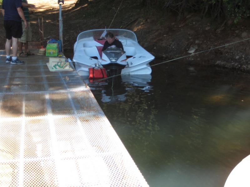

A boat dock with shade!? You ARE a lucky man. LOL What's the red bag hanging off the transom in the dock pic, BG? Glad it all went well, BTW.
Re:Maiden voyage 16 years 4 months ago #9854
just a float cushion - I like them for boats with short gunwalls better than bumpers
