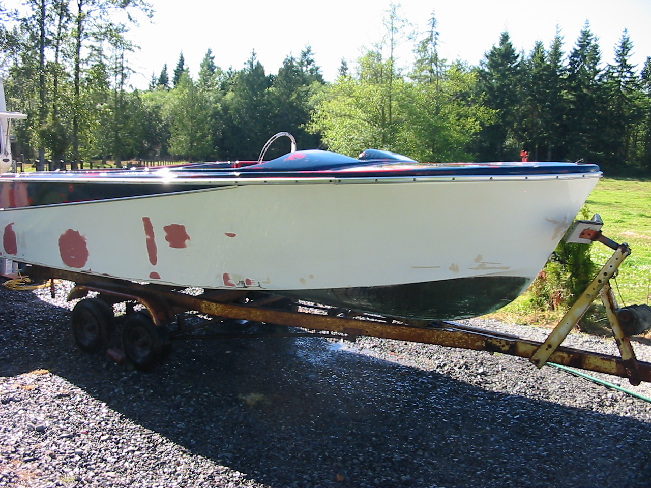

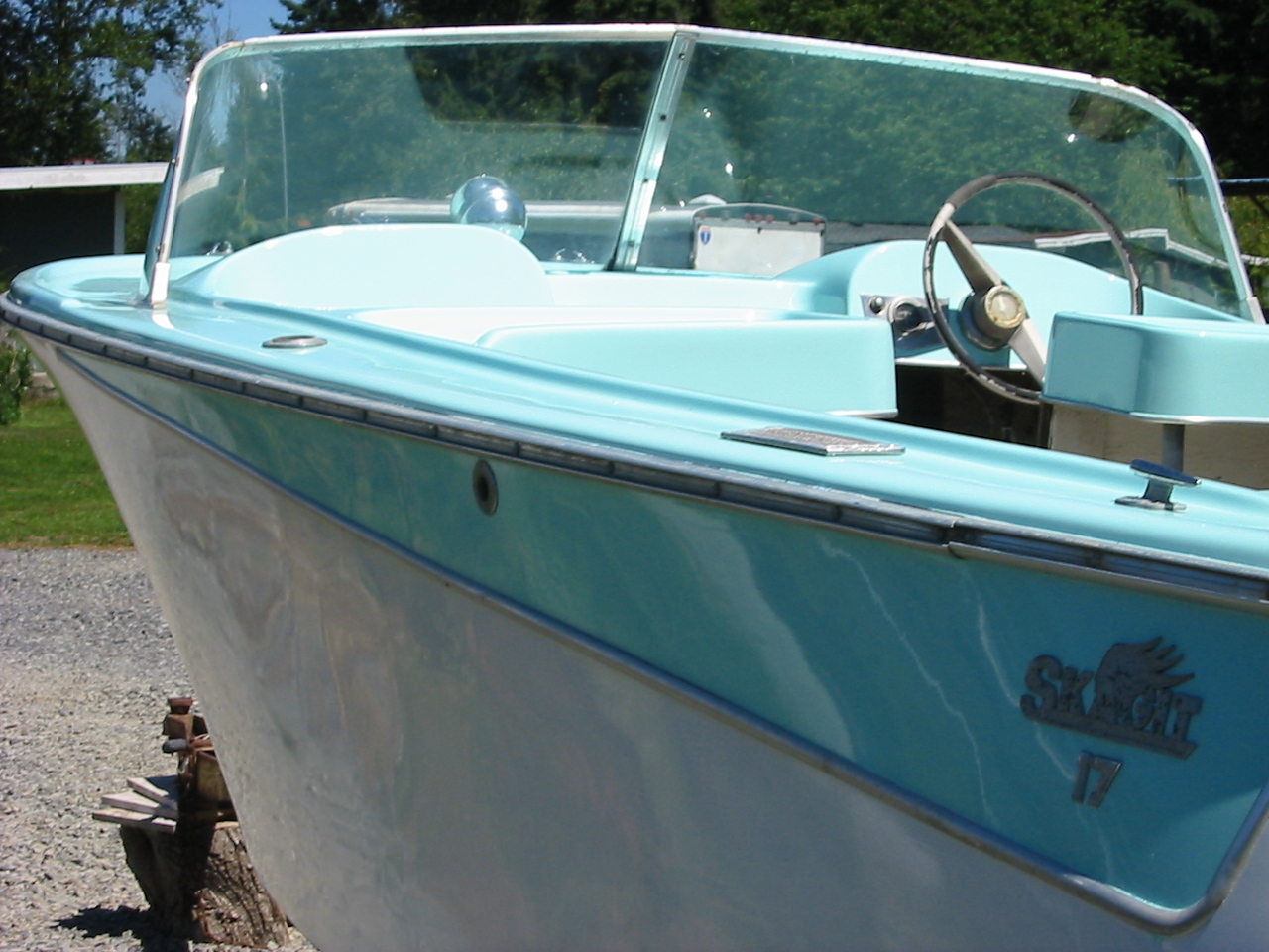

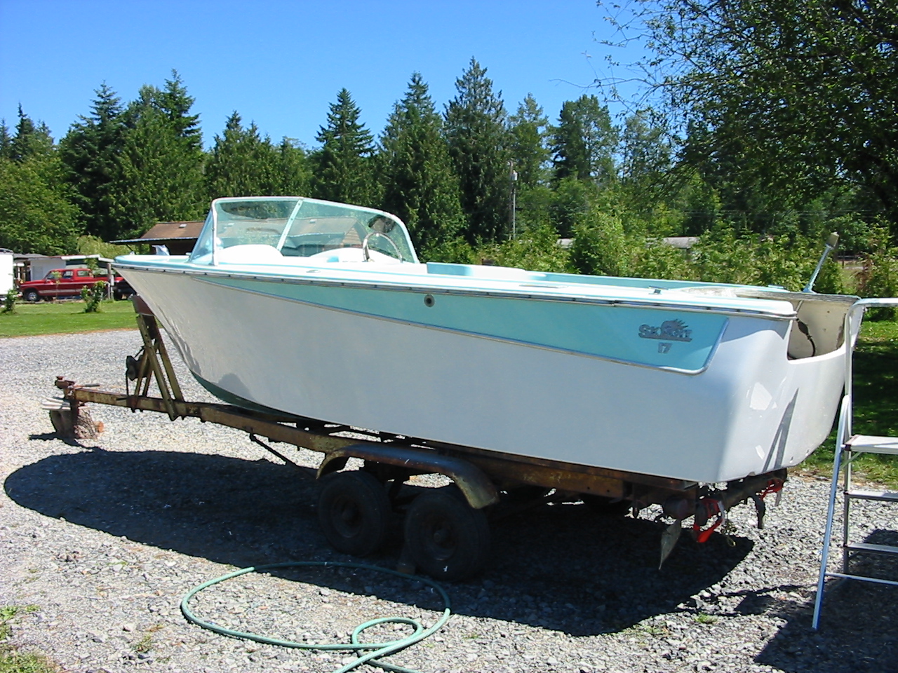

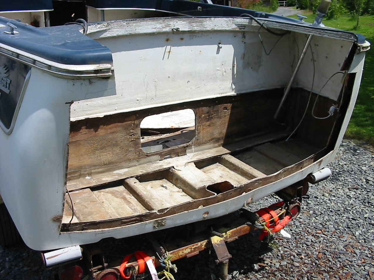

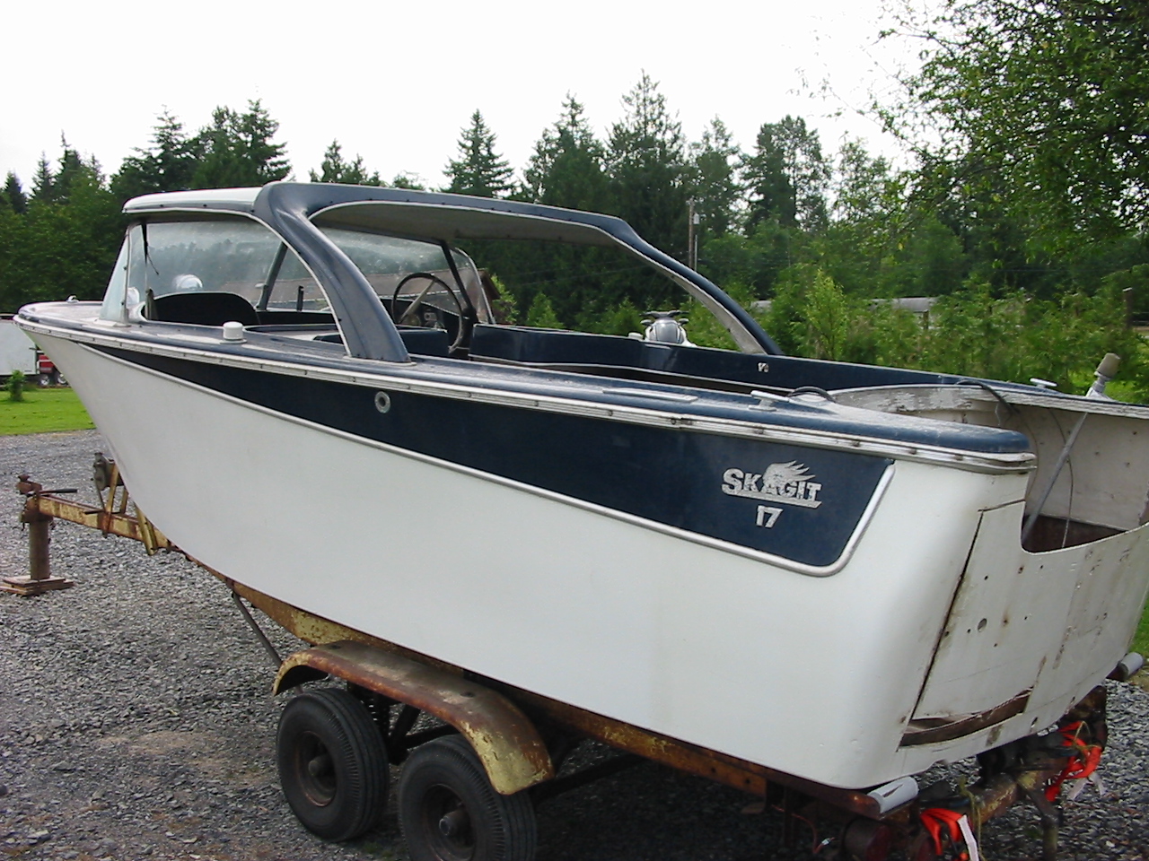

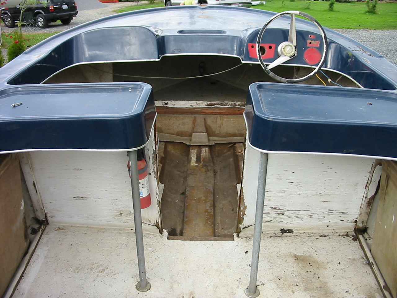

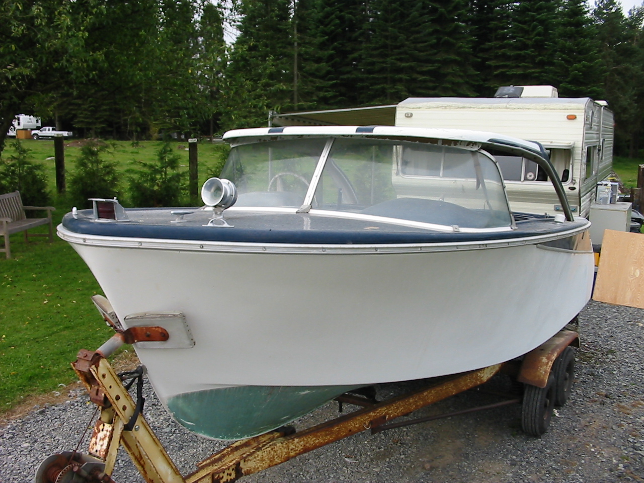

Hi Mark,
Went over to see Jamil today and bought the boat.
She's in better shape than I expected.
He's already started on her new transom, a curved transom at that.
The boat has the proverbial Skagit fiberglass stringers.
Serial number ID plate was present, 97U8025.
Decoding we find she's a 1959 model year, 17', Utility model with hardtop, 25th boat in the 8000 Utility series.
He'll be documenting various projects as he goes, so check back daily for his pics/commentary.
This boat and Jamil's expertise will be on display at the La Conner Classic Car and Boat Show this August 14th.
La Conner, Washington is the town where Skagit Plastics built Skagit boats.
A bunch of us FG members and Classic Skagit Boat Club members will have quite a lineup of glassics on display, including Skagit, Dorsett, Bell Boy, Glasspar, Dolphin, Power Cat and more.

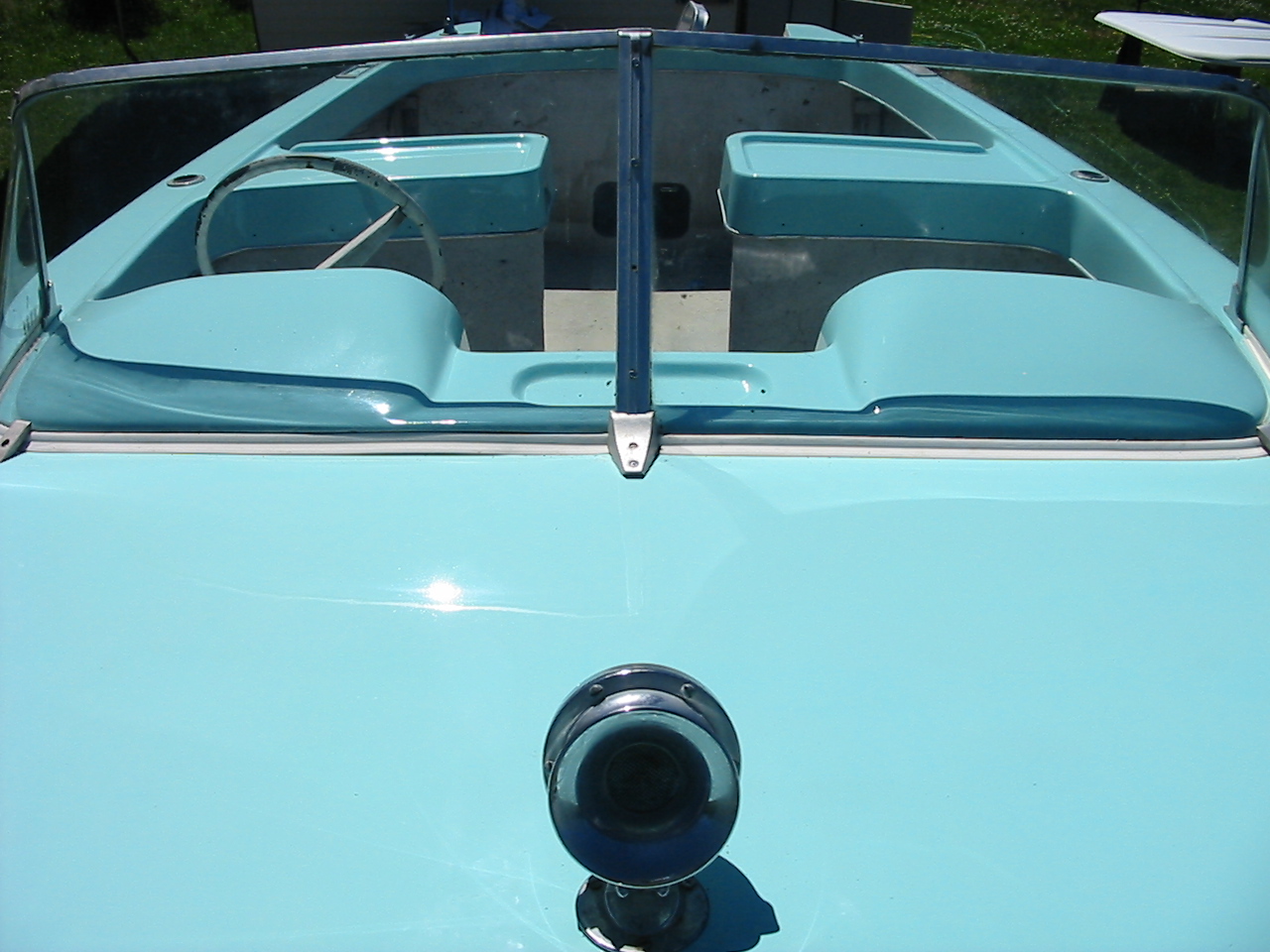

Cool Jamil!
She's coming right along.
I like the new solid transom!
Will support a Bearcat 55 4 stroke just fine, which is moderate power for this hull.

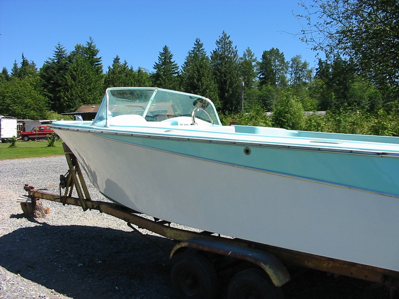

Re:Boat Painting pt. 1 and NOW ALL of pt.2 16 years 4 months ago #11318
Request emailed! The boat looks fantastic Jamil. Deep gratitude to you, and Bill as well for contributing to the project. There's a special place in the "big boathouse in the sky" for you two for what you have shared with us here. THANK YOU !!!

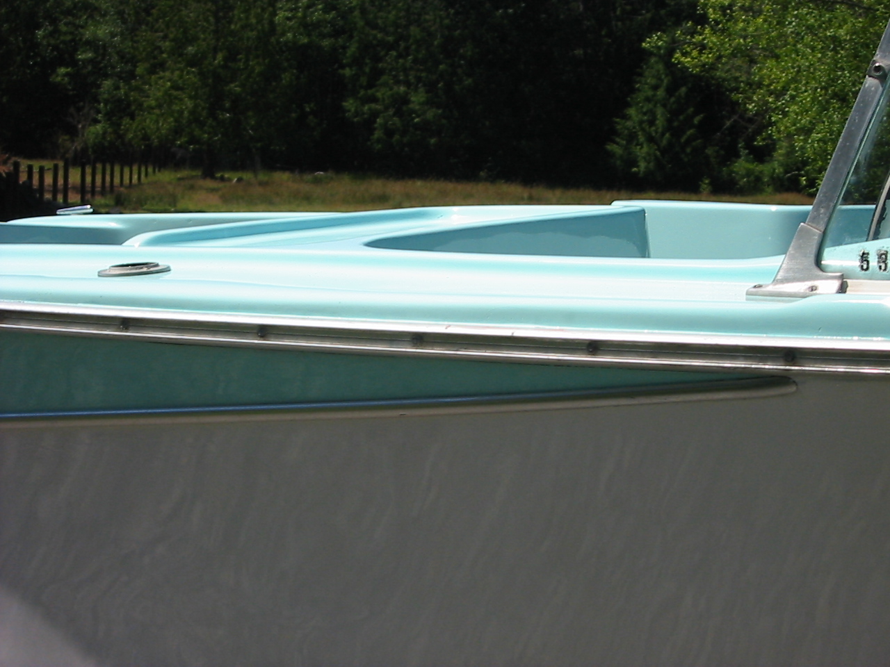

Re:Boat Painting pt. 1 and NOW ALL of pt.2 16 years 4 months ago #11327
'Nuff said indeed! Thanks for the terrific seminar!
I think I can see my house in that gloss :~)
