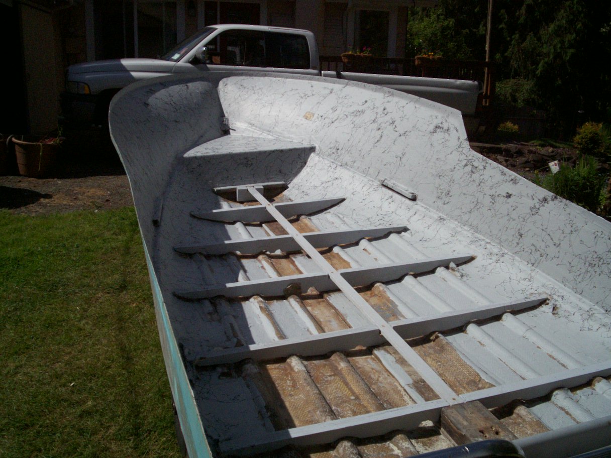

Finally got some sun today in the great PNW so spent the day doing my faux finish on the inside of the hull. Removed 5 (yes five) layers of bubba paint then rolled on two coats of 100% acrylic porch paint. (light gray). Then sprayed black spatter paint over the gray. I usually do black and white over gray but just went with the black this time. Will bed the sole (floor) ribs tomorrow and be ready to install the sole. Then I'll flip her for more marathon grinding, sanding, and fairing. You know the drill. Fun project.
