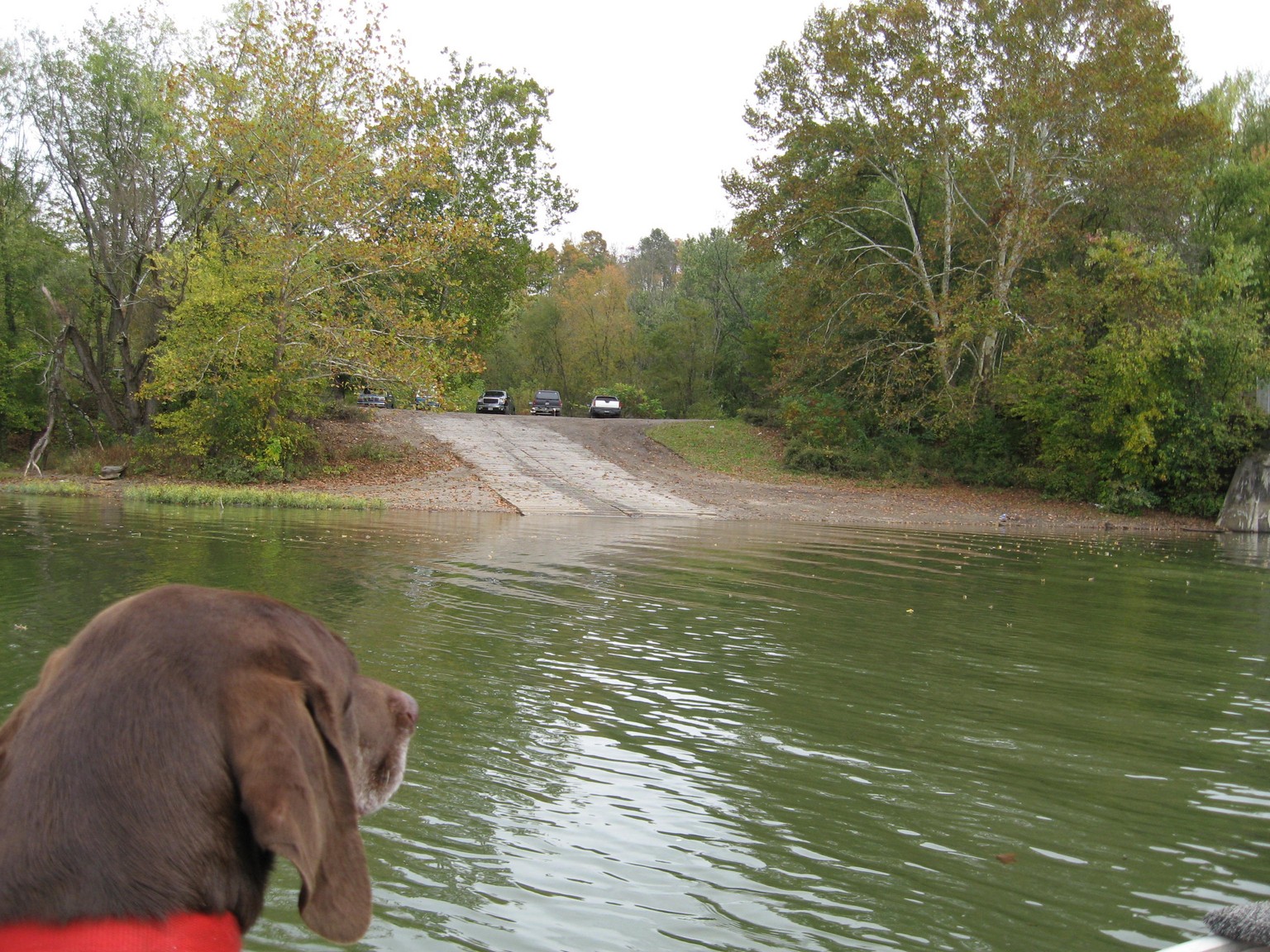

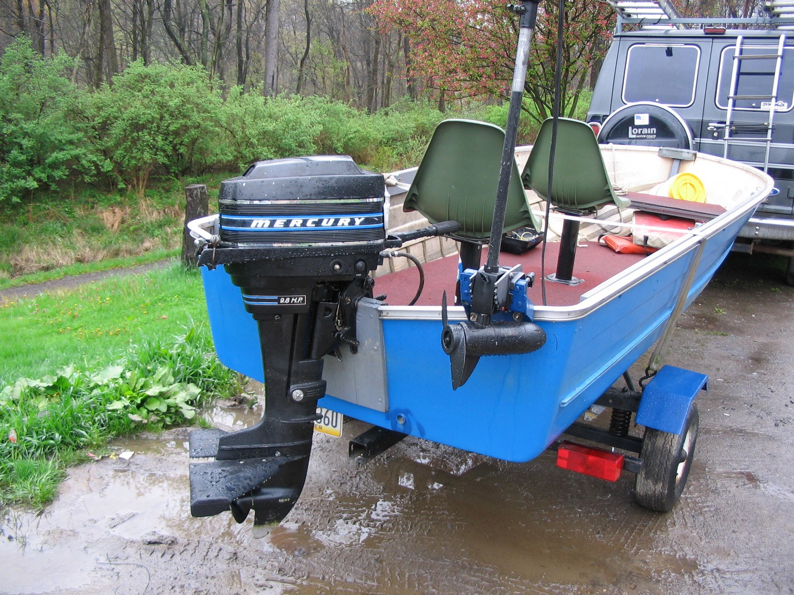

I won't be going but I'm only a half hour away from Butler. Oh and Bob Warren Boat Sales there treated me great. My first real outboard I bought used there many years ago. I got a 9.8 Mercury for $400. I took it home and it would sometimes pop out of gear. Although there was no warranty he gave me a whole new rebuilt lower unit for free. When I bought my 4 stroke Honda it was only 4 months old. A guy bought it and thought it was too small. I bought it for $1,000 less than new and he told me if it did not push my boat as well as the 9.8 he would give my money back, no questions. He was also willing to take my Mercury back on trade but told me I could sell it for about $650 on the open market and ask for $800. It sold for $650. I still get my parts there and have got free advise there many times. They are very friendly and helpful. My boating is for fishing. Here is my old Mercury. Same Boat with my Honda. This is The Babe, my boating Partner looking out at the Ford City Veterans Bridge. And if we ever meet don't be surprised if I do not look like my Avatar. This is Crooked Creek Lake.

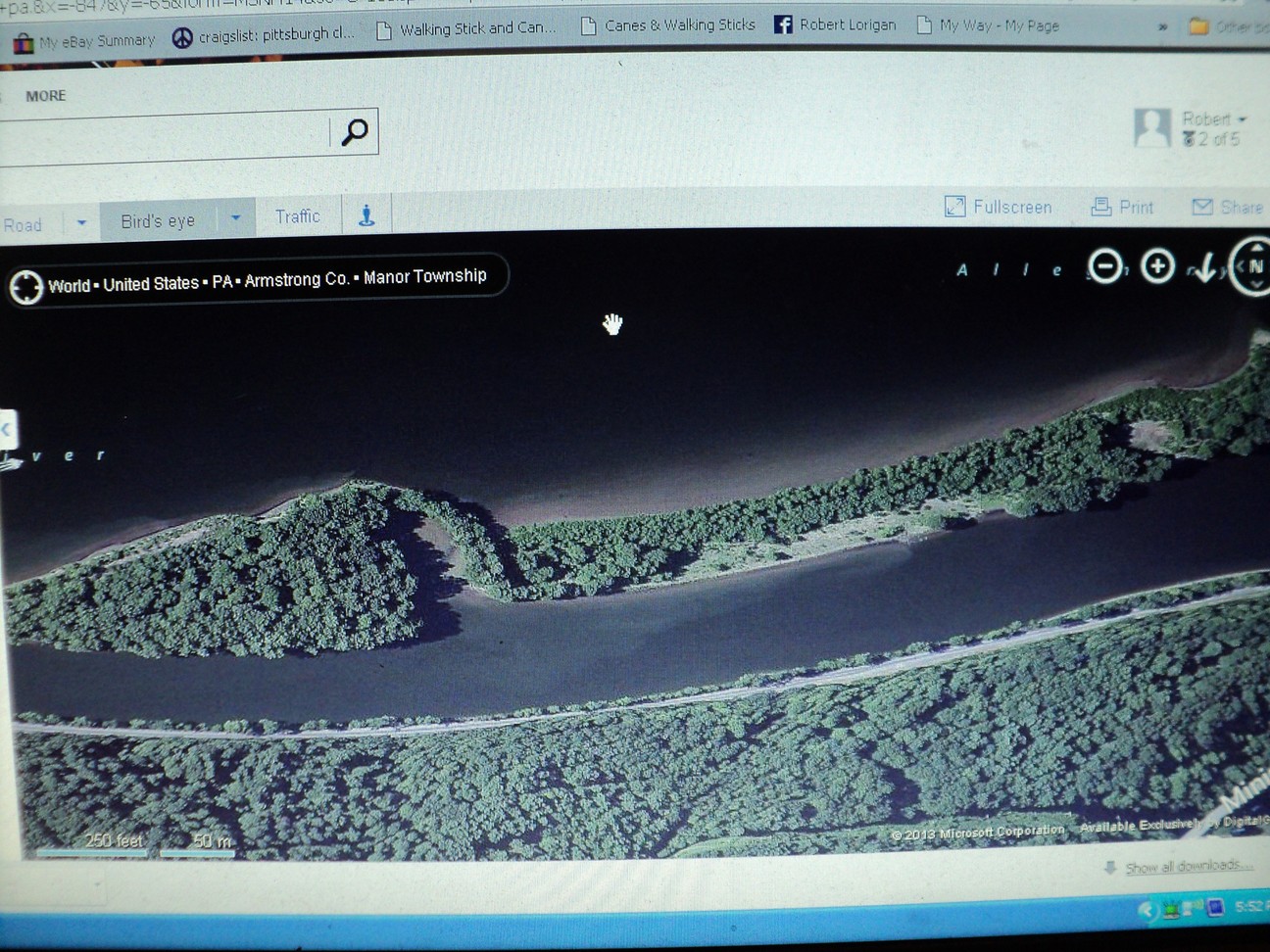

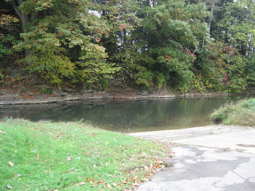

I just checked out said launch less than an hour ago. Water is just shy of the parking and hard mud is everywhere. The dock is almost turned over and looks about half sunk. I like the Roston Ramp below Ford City better. It's the same pool. You got to watch the shoals. But there is good fishing around them. Check out Google maps aerial view and you can see locations. Some of the water will be less than a foot on the shoals. I love to fish Crooked Creek. If you want the pool above number 7 I go to the launch about 1 1/2 miles nORTH OF kITTANNING on the River Road. It's the Cowanshanock access. If you boat is large it difficult, narrow and not very deep. This is the Roston Ramp at the mouth of Crooked Creek This is Ross Island from Google Maps.
