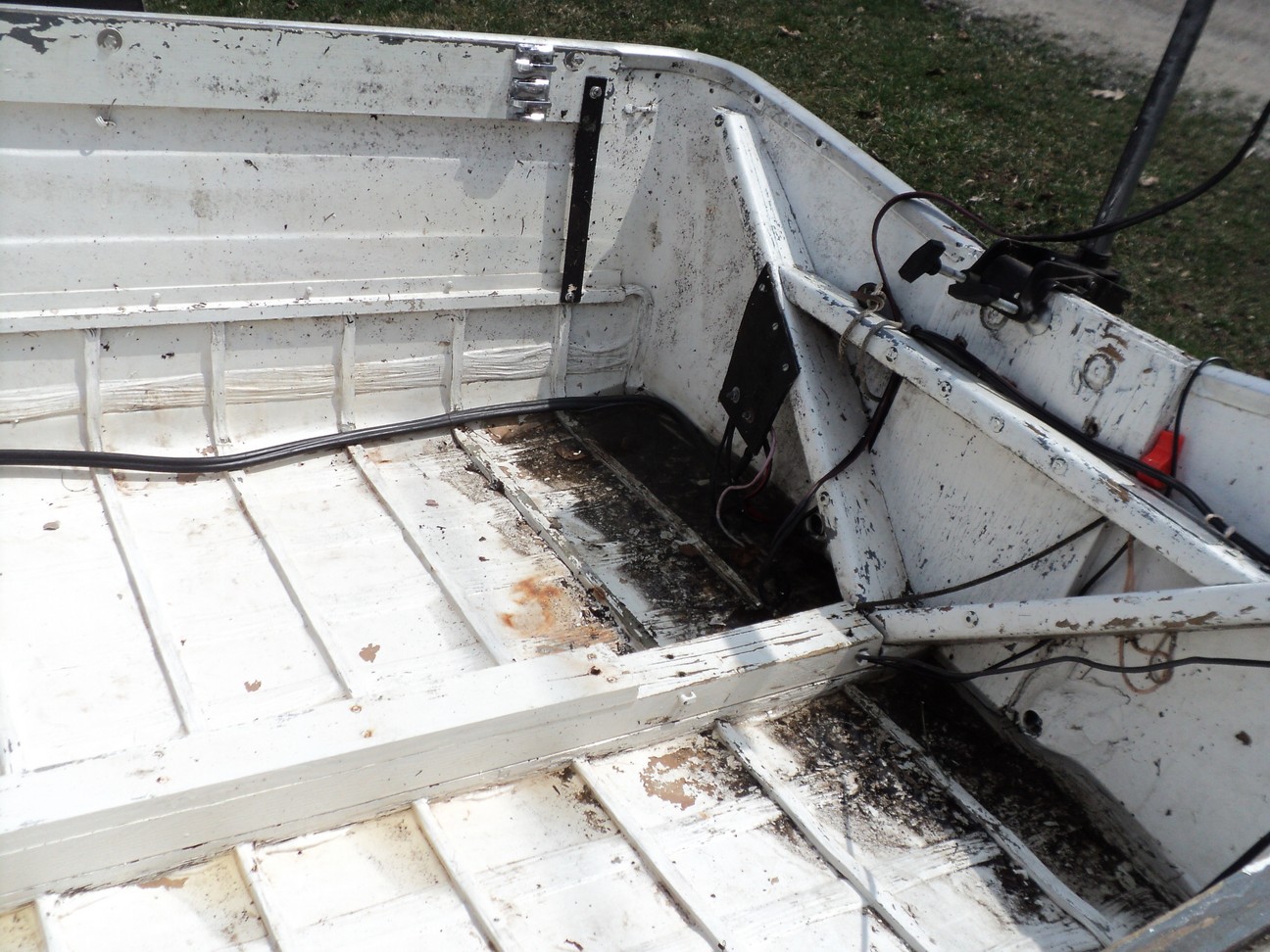

Today I found some soft spots in the floor so it will all get torn out this winter as a" winter project".
Looks like I'm going to just throw a remnant in for the summer and decide the complete restoration for this Fall.

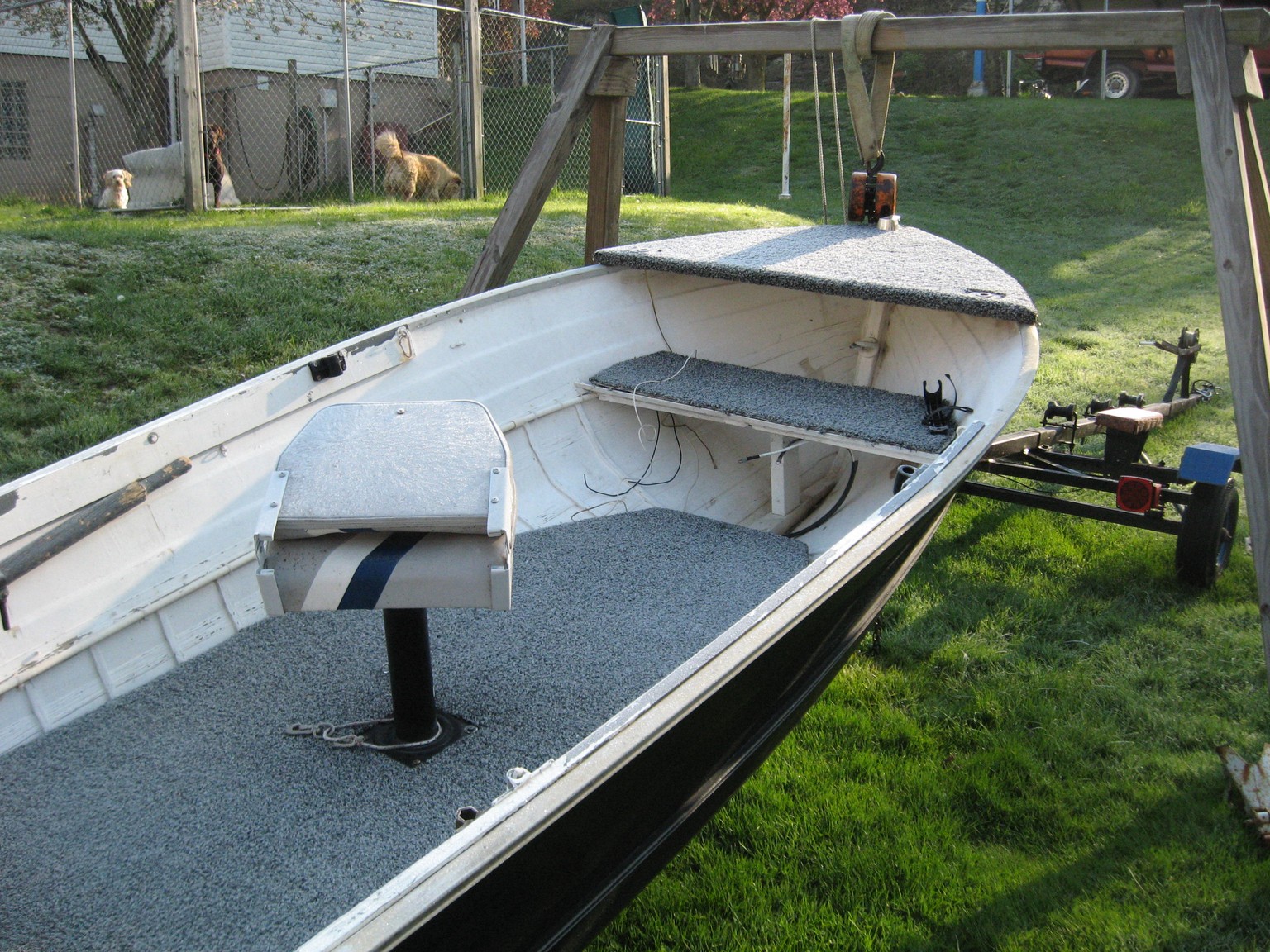

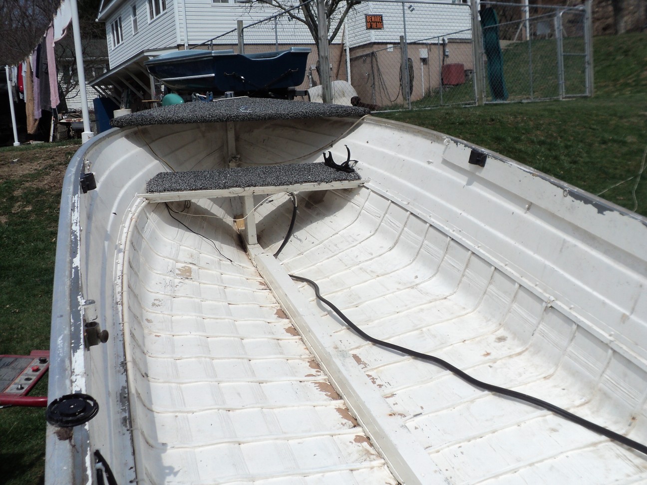

That will give time for planning and research also. Maybe even shopping for the best deal. Sounds like a plan. Oh and I pressure washed my entire interior also, not just when I took the deck out. I made it that way so I could inspect my wooden internal keel. I checked it every year. That boat was used for 100% fishing. My battery and box was kept in the bow. That is why the wire is there.
I'm liking the idea of a removable floor very much!
Good idea...
The ONLY Easy Day Was Yesterday
