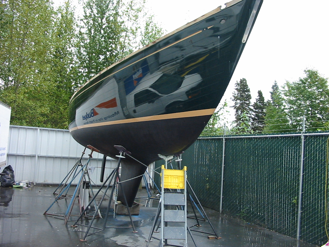

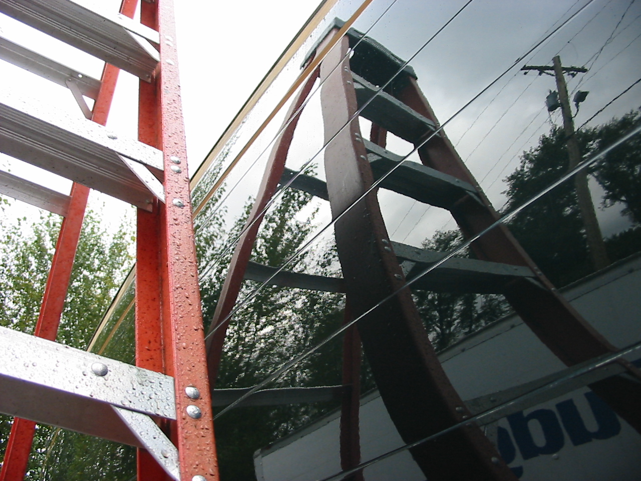

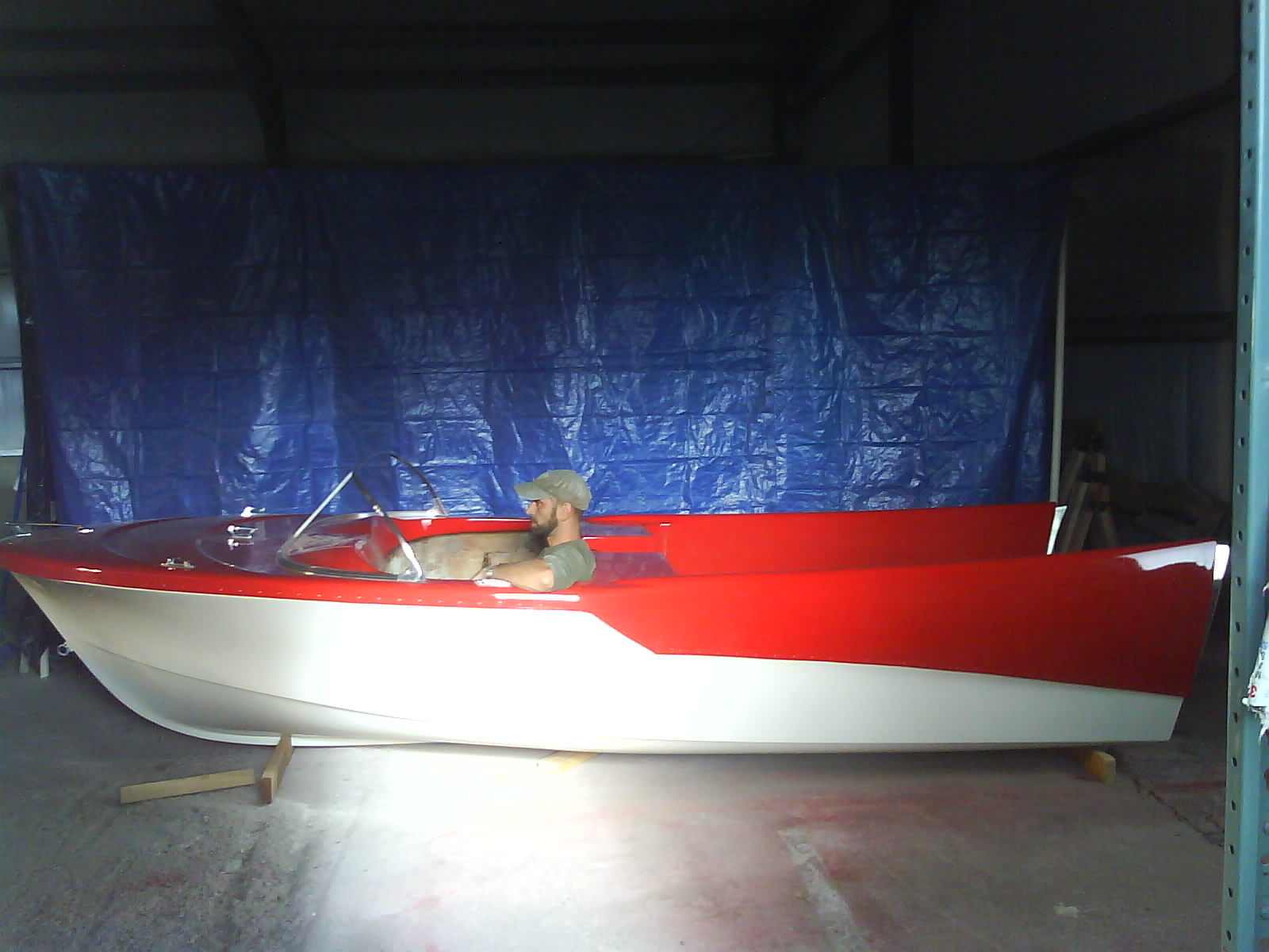

godelescher wrote:
Spearzike,
This is rolled and tipped Awl-grip that required no wet sanding or buffing.
Thats BEAUTIFUL!!! :blink:
What do you mean when you say "tipped"?
Re:Paint vs. Gelcoat 16 years 4 months ago #9639

You have to be kidding me! THAT paint was rolled on with a roller? What a great finish what was the process?
Re:Paint vs. Gelcoat 16 years 4 months ago #9640
Godelescher,
That is a very good looking paint job. Nice job.
But how many of the back yard guys here could get that paint job DIY? I know that I personaly couldn't do it. Takes many years of experiance to beable to tip and roll a paint job to that quality.
