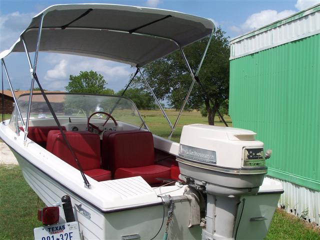

3 weeks ago I came across a boat that I feel needs to be shown here.My name is David aka Bowwiz,I'm 44 yrs old and I own a 1966 Arkansas Traveler.
I found the boat in Central Texas around Austin.The owner I bought it from said it belong to his grandfather who bought it brand new in 1966.The boat ended up spending almost 40 years in a climate controlled garage-in Northern California with a canvas tarp over it.In late 2008,the Grandfather passed and the grandson got the estate and shipped it all to Texas.
Here in Texas ,he had the boat serviced spendin $1,200 at a boat shop in 2009 and took it out 2 times on Lake Travis.The mans wife -a large woman-didn't like the boat ,small for her,so she made him sell it..
The interior panels are in excellence condition,the floor has a thick vinyl covering/mat,its faded,but floor is solid.The upholstery on the seats were cracked,and checking around,it was cheaper to replace the seats with new molded plastics seating.After laying down indoor/outdoor carpet over the vinyl floor. This boat is in almost new looking condition.
The 1966 Johnson 40 hp outboard with Electromatic drive runs like a sewing machine.
Its a good feeling owning a boat thats the same age as you and in alot better shape than yourself.:)

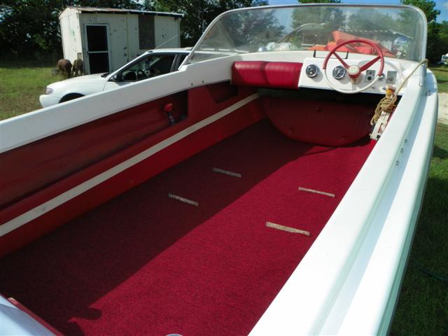

New carpet over original floor..

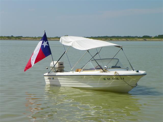

I did add a aftermarket Bimini Top. [/i]

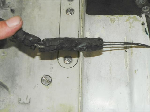

Thanks Yall..My excitement in owning this boat when sour today at the Lake.While cruising across the Lake at full throttle/power.The Johnson 40 hp with electromatic shift-the boat lost forward gear .Come home and checked it,and found I have 12 volts going to lower unit and reverse gear still works,but no forward.
Doing a quick search for lower unit parts for this old 1966 Johnson 40 ,I see its not going to be a quick fix.
Anyone recommend a parts supplier of electric shift lower unit for this engine?
Re:Introducing myself and my boat 16 years 4 months ago #9664
Bowwiz: By the description of your failure it sounds like you may have a problem with one of two thing. The electro-magnet may have failed or the drive coil has broken or come loose. Elertro-magnets do fail but in my experience not as often as the drive coil breaks or comes loose. Get yourself a parts/maintenance service manual. Once I studied the parts blowup you can see how the unit works. As often as not the three allen set screws that hold the drive coil in place will have come out/loose and tension will have been put on the drive coil tab. Eventually the tab will break off causing a failure as you have described. In an instance such as this I have switched the forward with the reverse drive coils as they are identical. Installing the forward drive coil in the reverse position holding it in place with only the three allen screws without the advantage of the drive coil tab. You use reverse so sparingly the drive coil without the tab should last you a very long time. Use locktight on the three allen screws. If this is indeed your problem the cost is only in time.
I have priced out electro-magnets at $300.00each/new. Way to much for me. If needed pickup a parts motor for parts. The forward and reverse electro-magnets are different.
I have found the Electro-Shift lower units to be very long lasting and reliable. However the correct oil (TYPE "C") must be used as standard 80-90 will cause the gears to drop out momentarily and they re-engage, hitting very hard.

Hello David, Mine did the same thing,reverse but no forward. The electric wire that runs through the exhaust housing down to the gears was burnt in two after 40 yrs ;)

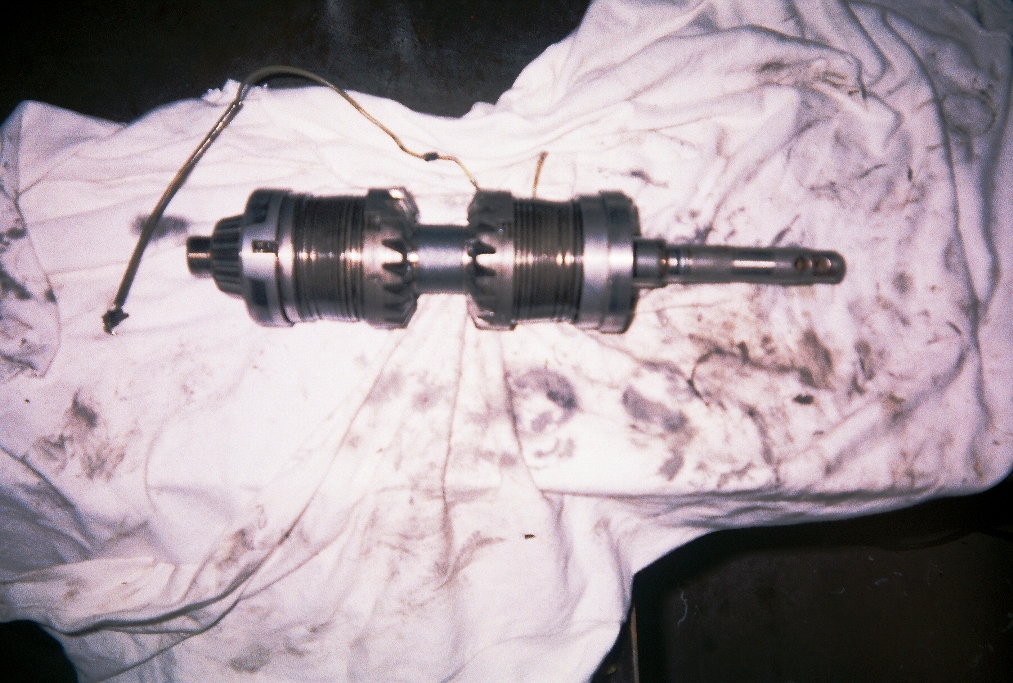

I torn it down today and this is what it was! Thanks for the advice..
--This type C oil,guess I am gonna have to go to local boat shop now :)
Thanks for the replys and the advice Greg..

I am a retired ASE Master Certified Auto/Diesel of 24 yrs due to having a form of Muscular Dystrophy .I knew when I ohm'd out the green wire going to the lower unit.I knew it was a burnt or broke wire,so I figured ,tear it down and see what happen.
I was so excited that it only cost $10 in supplies to fix-which was my choice,i could have done it cheaper :)

Amazing how a great website can get info to those who need it so quickly, congrats guys, job well done.
As for the boat, she's a beaut, love to see excellent original examples. And ya gotta love a guy who flies a BIG pendant!

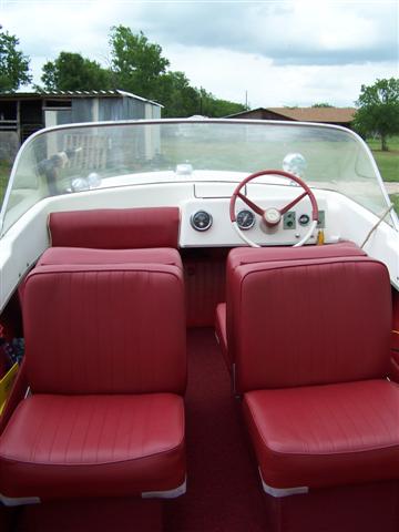

I still have the original Bimini top frame and have the original seats that came out of boat.I would love to have them redone to return the boat to complete original.
But thinkin it over,the original bimini top,you almost had to get down and crawl into the seats..

I just scrubbed the upholstery with warm soap water,died,than used Black Magic on them...Cleaned up like new again.
