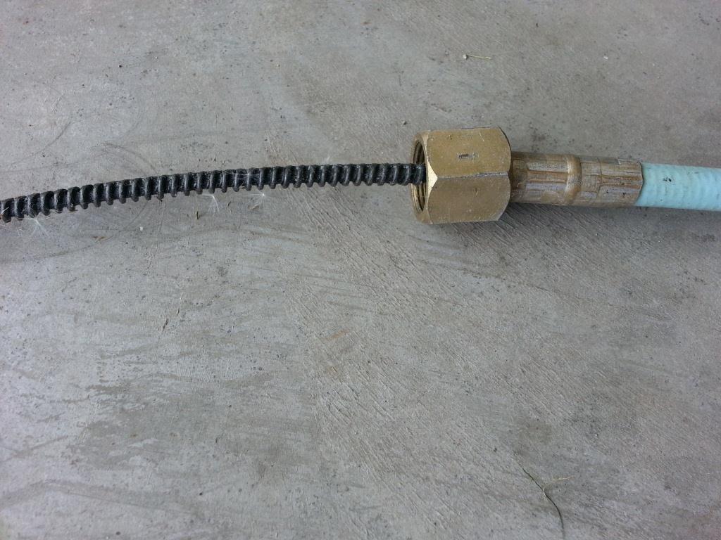

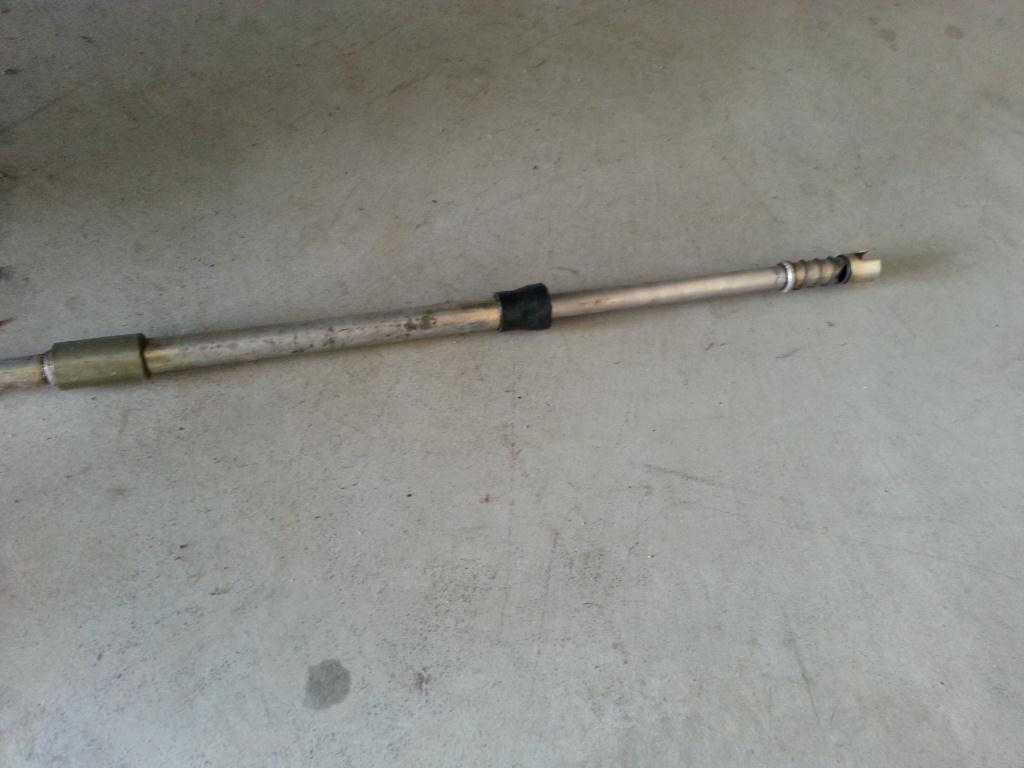

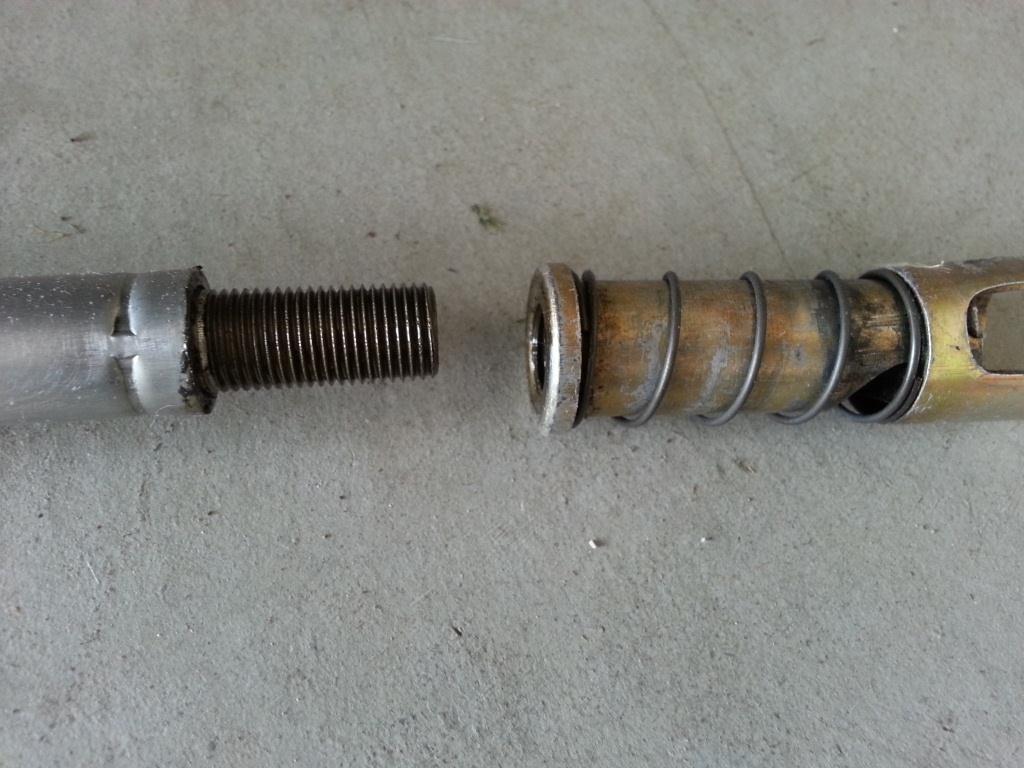

I need to replace the steering cable on my 1966 18ft Span American. I would like to get a new cable that requires as little retro-fitting as possible. I am not seeing any cables out there like mine with the threaded on ball disconnect on the outboard side with a clamp style pivot.
Any tips would be appreciated. Thanks!

Re:Teleflex Cable Replacement 12 years 3 months ago #95635
You might give the crew at Jamestown Distributors a call Bedo, they have a pretty good assortment of the Teleflex cables and fittings;
www.jamestowndistributors.com/userportal/search.do?freeText=teleflex+Cables&page=GRID&engine=adwords&keyword=teleflex_cables_sitelink&gclid=CNTAm-O_5b4CFSJo7AodoAIAGw
Re:Teleflex Cable Replacement 12 years 3 months ago #95642
Hi,
Mark's advice is always worth listening to, but I am very skeptical that a new cable that old in the correct length can be had (they were discontinued decades ago). My advice would be to purchase a new steering system (you may find that the existing dashboard hole is still the correct size). I give this advice as the steering cables for the threaded helm units are very close in price to a kit. There are several areas to possibly discuss, but you will have to purchase a clevis kit and a replacement transom mounting tube with external threads (versus the internal threads your picture seems to show. However, if you have an outboard motor with a tilt tube, and the boat's splashwell is not unusually narrow, you may opt to change to a through-the-tilt-tube steering connection, and purchase a link arm assembly instead (of the tube and clevis kit). I do not trust the color when viewing on my computer of the plastic coating of your original cable, is it white, or faded blue? Another thought would be the angle of the steering wheel shaft in regards to the dashboard. These can be 90 degrees, or 70 degrees (referred to as a 20 degree tilt). I am enclosing a picture of a 20 degree tilt steering wheel shaft for your study. If you would like to speak directly, our cell phone is 770-597-5992 (please no calls from outside the US - e-mails are welcome though), and I will try to walk you through the needed parts, and provide you with some quotes for your consideration.

Re:Teleflex Cable Replacement 12 years 3 months ago #95720
Hi,
In revisiting my answer based on Tom's comment, I am more inclined to think that the cable shown is a Big-T or Safe-T, and therefore, a replacement cable is an option (a Midi-T would not be), and would then eliminate the trouble of replacing the helm unit. A new support tube for the transom mount assembly (the picture shows the cable with the support tube and adapter still installed) and a clevis kit will still be required. If like Tom (as I best presently remember), you can convert to "through-the-tilt-tube" steering connection, this would be the time to do it, but this would depend on the year, brand, and horsepower of the outboard involved.

Re:Teleflex Cable Replacement 12 years 3 months ago #95724
My apologies Joe for not thinking of you first as a reference for Bedo on this issue! Your initial response with the thought that a complete system (cable and helm) is only a few dollars more than a cable alone definitely bears consideration. Many times what is thought to be a serviceable rotary helm has "play" (from wear) in it that will leave the boater wondering why the new cable didn't correct the problem completely! (I know this from experience.)
The helm end of Bedo's cable appears to be the common rotary helm design, but the "motor end" is the strange bird to me. Is that not the "spring lock" design that was discontinued because it was deemed unsafe? Please forgive my ignorance here if this is incorrect, always attempting to learn more.... :unsure:

Re:Teleflex Cable Replacement 12 years 3 months ago #95733
Hey Mark,
My take is that all the steering connections which had a spring involved for quick disconnection (it was once common for outboards to be removed from the boat and storage separately, typically indoors, then reinstalled the next season) of an outboard were changed (during the 1960's and early 1970's) to reduce the perceived possible liability issues. There were many of these produced, so I am not sold-on them being unsafe, but the threaded cable ends were eliminated to force the change.

Re:Teleflex Cable Replacement 12 years 2 months ago #96067
  • Bedo
  • Posts: 14
Thanks for all of the replies and useful information! I ended up getting the Safe-T cable which came with an adapter to easily bolt up to my original helm. I found a support tube from a local boat shop that has outside threads compatible with the new cable. The support tube adapted perfectly to the original clamp block. Unfortunately I had to move the clamp block towards the engine about 3" to get the proper range of motion, so I had to drill an extra hole in the transom. The original quick disconnect had to go because the new cable isn't threaded on the end, so I bolted it directly to the engine using a 1" spacer.
I am pleased with how well it turned out while using as many original parts as I could.
