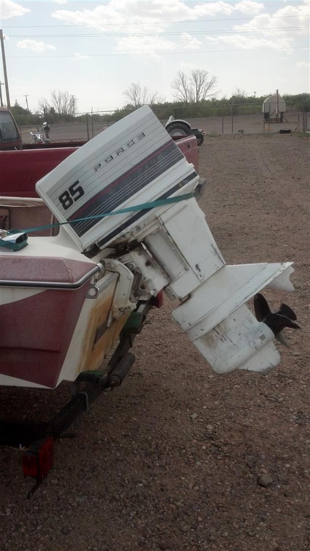

Local auction yard has a worn out throwaway 16 foot boat on a good trailer that I could use. The boat sits on a decent Trail-Rite trailer and has a Force 85 motor. Boat has some decent hardware on it but interior, hull and gel coat are a mess. Doesn't look like it could be test run before bidding.
Wondering about the Force 85. I couldn't see the manufacturers tag, but it's a 3 cyl, Power tilt model. Boat and trailer are Circa 1983-85. Motor looks ok externally, and the powerhead and wiring have not been messed with.
I did a forum search but didn't turn up much on the Force motors. Any opinions?

Thats one the early Force badged Chrysler motors. They were pretty stout, easy to wrench motors. And I hear little if any "known" problems them.
Later when it all became US Marine/Bayliner, and the later black motors, did have some problems. But I don't care what any says or bash them, but I STILL have my 25 year old 20 foot Bayliner Capri Cuddy, 125 Force. Runs in salt too. And still runs fine. Just needed a "known problem" stator/ING system upgrade to Mercury. Ya get a decent price for it, go for it.
And IBoats has a great forum on Force/Chrysler, and some smart guys there too on Force motors.

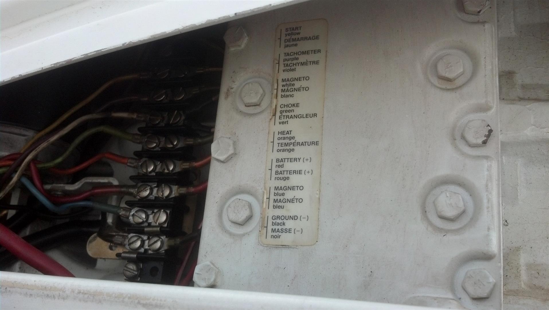

Thanks guys. Looking at the wiring label in 2nd photo, looks like maybe it's a straight magneto motor, no module to act up?
That's just a generic sticker, that model should have a CDI-type ignition. They're not too bad, I've done a few stators and the occasional switchbox, but parts are still readily available and the system doesn't seem inherently unreliable.

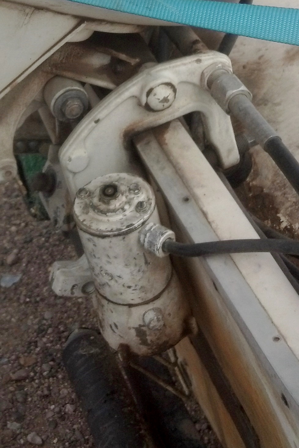

Thanks Ed. Although the motor looks OK cosmetically, I notice the tilt pump has a number of nicks in the case, as though someone kept a hammer handy, to give it a clout when it acted up. That, coupled with the web strap holding the motor in tilt position, isn't a real good sign. But if parts are still out there...

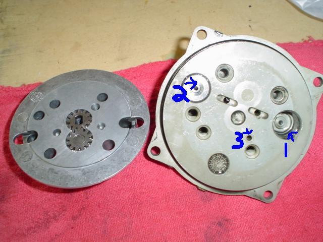

OK, that could be a HUGE..(maybe) problem. I have the same T and T unit on my Force. I think, as would need more pix it. Nice when working properly. Its all in one. One the long rams is a shock absorber, the other tilt. As it comes down it goes to the slower middle fat cylinder for trim.
OK, when I bought my boat used, it was in the shop just having had the pump repaired.I didn't think or know much about it, so didn't care. Boy, have I learned a LOT since then. (Funny too, as getting mine ready for summer this week, I had no tilt up, just down. Dash switch OK, then switched the relays. Now up, no down, so new relays coming soon.)

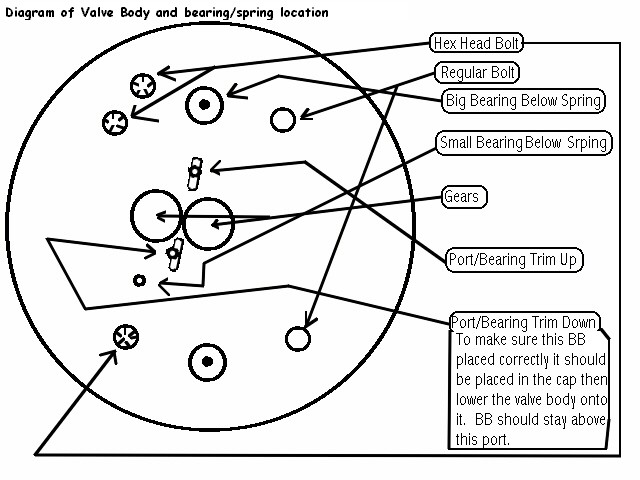

But if its just the motor that need whacking to run, that can be checked, and they are (maybe) available. But TRUST me, if its in the pump body and a problem? Even experienced wrench's won't mess with it. Its so convoluted its a nightmare of springs, washers, check balls, UUUGGGHH! If you can find a good used one, VERY expensive. That strap holding it up is a very bad sign to me as something aint right. At the least, its not holding pressure and ..well...I might think taking a pass on this might be in order. But ya could get lucky too...its a simple gamble. Hers some pix the body..
