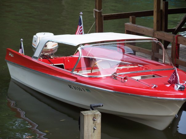

Yes Steve, it's mine. HEY(former) NEIGHBOR !
