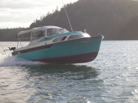

Here's some action shots, showing that we gave our keyboards a rest, exercised our control handles, and back to the keyboard to share them.
Fun to work on 'em, but boy does it revitalize ya to get out and take a cruise.
Pics are from near Deception Pass, WA state, saltwater.
Which we're surrounded by.
Re:Russon: Do you have pics of....... 16 years 4 months ago #9440
Thanks for sharing those pics Bill. That is some beautiful scenery you've got out there, the 'Glassics look even better with a background like that!
