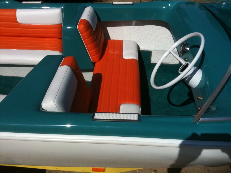

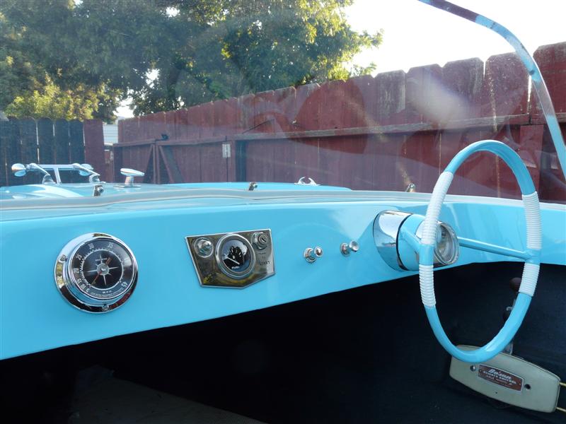

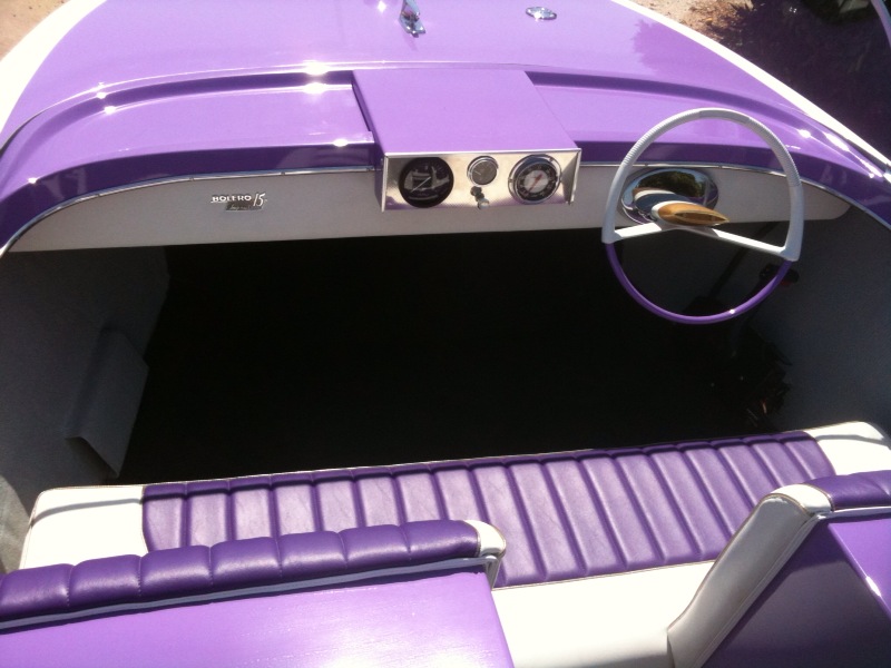

satx,
It can be a tough call on restoring these old wheels. We use a Dremmel to open the cracks up to about 1/8" and use some really nasty black 2 part epoxy as a filler. It dries hard as a rock. We finish the wheels in Imron polyurethane. I'm fairly certain it's not going to re-crack where we repair, but new cracks ???
Larry

Nice looking wheels Larry. Great work
