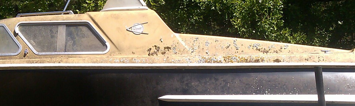

Hey guys,
New here also, so bear with me. I found this catalina. A 63 is my guess. The inside is rotten, which I can handle but I'm worried about the upper flaking and peeling on the top cap. I realize most anything can be rebuilt, but I'm trying to decide if this is too far gone. Opinions?
I'll try to post more pics if I can figure out how to do multiple pictures.
crash

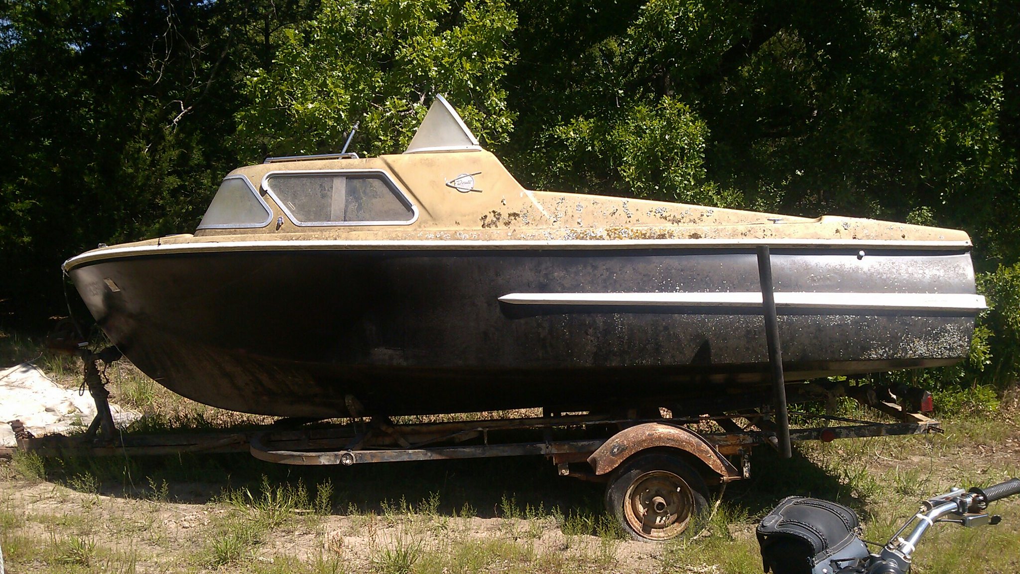

Re:fiber glass boat repair? 12 years 3 weeks ago #93771
here is closer.

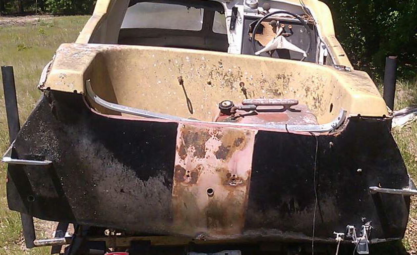

Re:fiber glass boat repair? 12 years 3 weeks ago #93772
And the back.

crash11,
1st, WELCOME ABOARD.
2nd: That boat LOOKS like "a real project". - Whether it's worth your time depends in the main on how "much in love" you are with that rig.
just my opinion, satx
