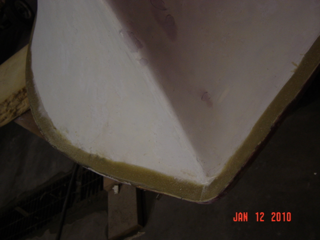

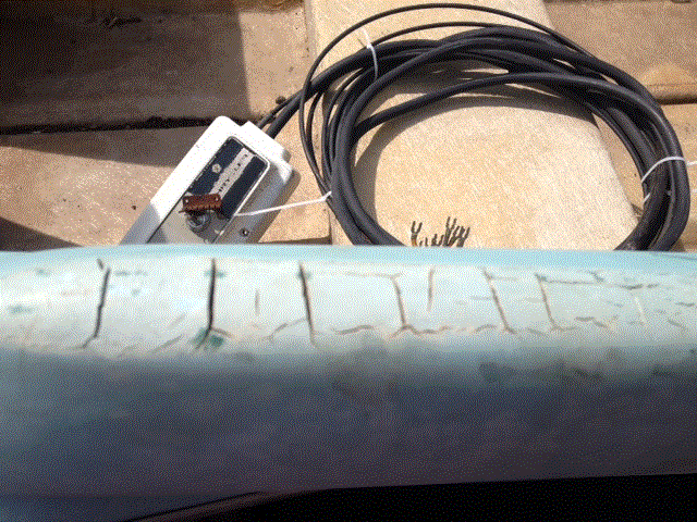

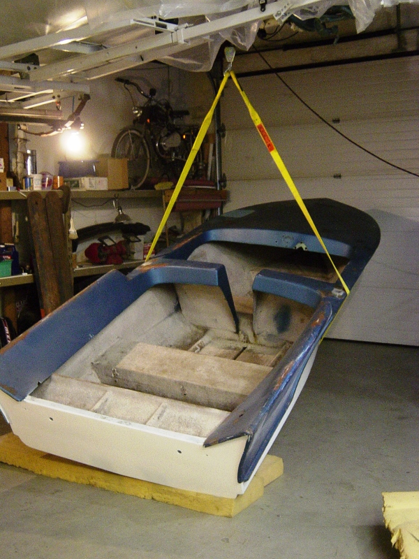

I finally got the Tomahawk home. I stripped most everything off. I have been researching how to repair the fiberglass imperfections. Has anybody used the product Ad Tech P-14? Here are a couple of pictures of future "fun" I will be enjoying.

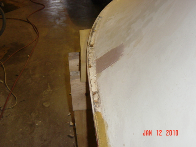

I used that product as a filler after sanding and before gelcoating my Glasspar. Got good results and be careful to not put on any more than you need. It dries hard and take a while to sand smooth. Was a good tip I got from our friend Jerry over at Haynes Fiberglass Repair.

Re:Tomahawk Boat Restore- AD Tech P-14 12 years 4 months ago #93291
Thanks Terry. If I got it right, I first sand/ Grind out the cracks, then fill the cracks with a fiberglass repair. Using the Ad Tech P-14 is too get the final shape, before Gel coating? It would be nice to have someone in the area to bounce these things off of. I appreciate your response.

Bruce: Nice looking 1960, 61 or 62 Tomahawk, SkiMate. For awhile I couldn't get enough of them.
If I can be of any help in sourcing parts feel free to contact me.

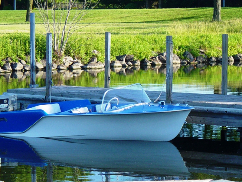

Hello Bruce,
This was the first time I have applied gelcoat and got good results. I talked to people that had experience in it and learned what I could before going in.
After sanding down the gelcoat I found lots of pinholes and used the ADTECH P-14 ultra white as filler.
Terry

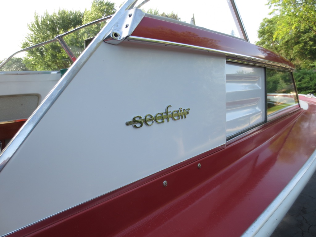

Re:Tomahawk Boat Restore- AD Tech P-14 12 years 4 months ago #93353
Terry
Thanks for your response. Beautiful Seafair. I can't find the Ad Tech P-14 around here, I will have to go on line and look.

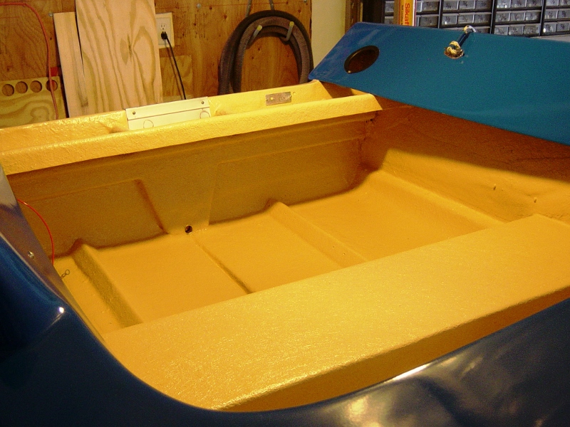

Re:Tomahawk Boat Restore- AD Tech P-14 12 years 4 months ago #93378

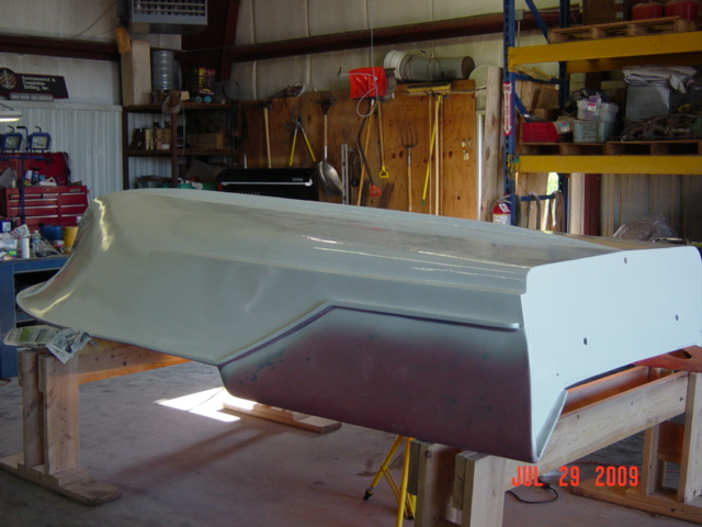

Yes Bruce I have between 100 to 250 photos of each boat taken during restoration. I live in Monona, WI near Madison (South Central WI)
Greg Anderson
Wisconsin

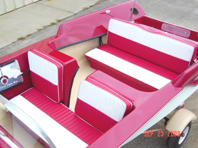

Photos of this boat (1961 Tomahawk SkiMate should be identical to yours.

Re:Tomahawk Boat Restore- AD Tech P-14 12 years 4 months ago #93417
Greg
Thanks so much for the photos. I was told by the previous owner that it was a 1959. I believe you know better. My transom seems pretty good. Did you have to beef yours up?
I live in Northern IL.

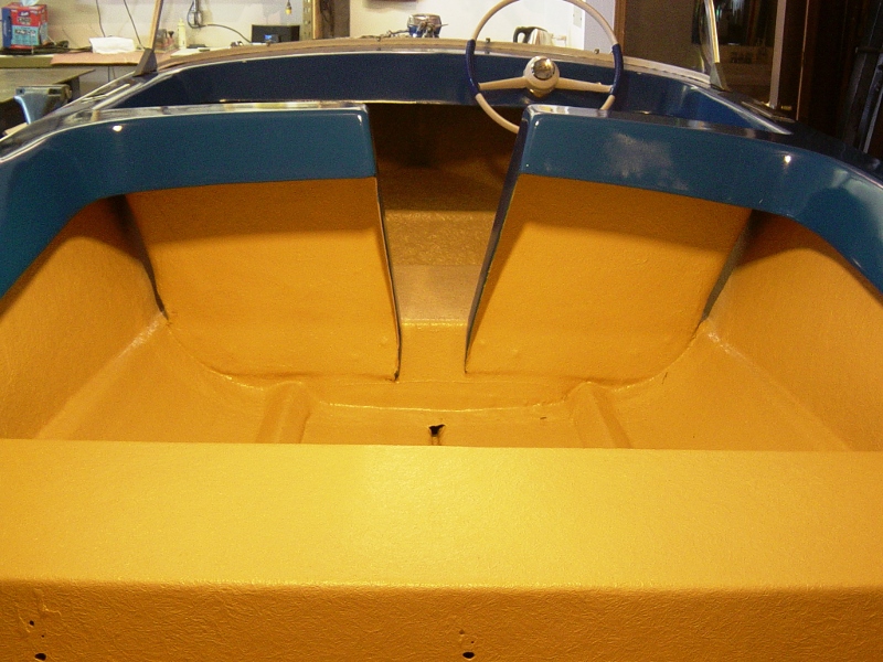

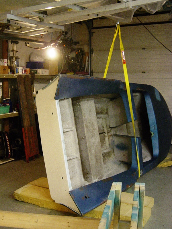

Re:Tomahawk Boat Restore- AD Tech P-14 12 years 4 months ago #93437
Of the five Tomahawks I have reconstructed I have never had to "get into" the transom. Each have what I call a 1/2 transom. That is to say the wood portion of the transom is in the top 1/2. Some models have a small portion of the transom that extends to the floor. Because of the 1/2 transom water was not able to "suck-up" into the transom wood, saving them from rot. Of the five tomahawks three had the original transom tags showing maxim motor ratings of 65 HP. With that said I would not think there would be a need to beef up your transom. The most horse power I have hung on a Tomahawk is 55 HP.
I have never split a Tomahawk. The two half's are, for a lack of a better term "glued together". Making them very difficult to get apart. With the two half's together it makes it much more difficult to work on. So, the boats with a floor had to go back in with two pieces rather than on piece. Of course yours doesn't have a floor saving you countless hours and money.

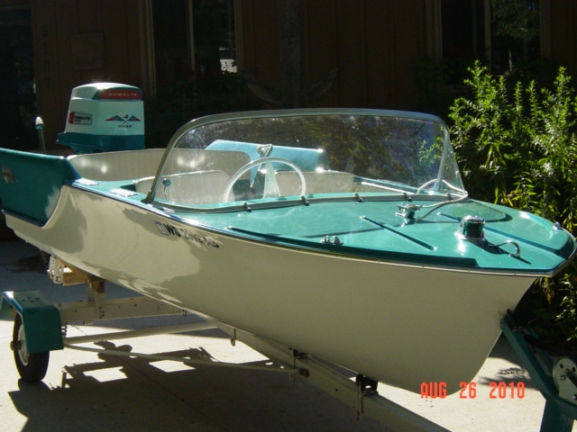

Re:Tomahawk Boat Restore- AD Tech P-14 12 years 4 months ago #93492
Greg
Thanks so much for the pics and the tips ( I would have split the boat) Mine has the same yellow ring around the edge. Did you make your own upholstery? What paint did you use? Sorry for all the questions, I am new at this and I like the way your Tomahawks turned out.
