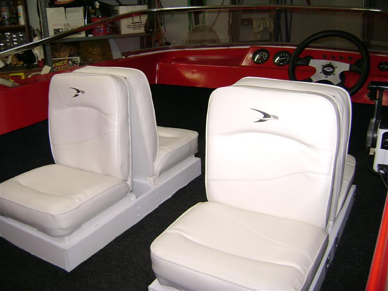

Welcome aboard Scott, glad to have you join us. Here's some pics from when Andgott was restoring his Citation, thought they might help
www.fiberglassics.com/fiberglassics-forums/home/main-forum/glasspar-citation-seating#7627
I was running low on funds when I got to the interior on my project, "store-bought" seats and/or upholstering the originals just wasn't in the budget. I found some jump seats on GreatLakesSkipper site (off-season sale) that were affordable, just had to build some frames to support them. May be an idea you can adapt to fit your needs?

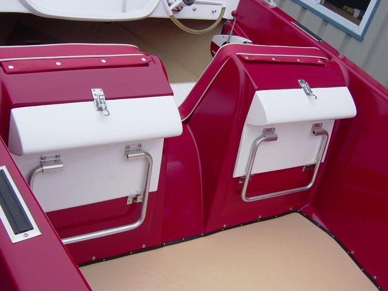

Here is what Lake "N" Sea did:
3/4" plywood, hinges, hasp, support and upholster??
