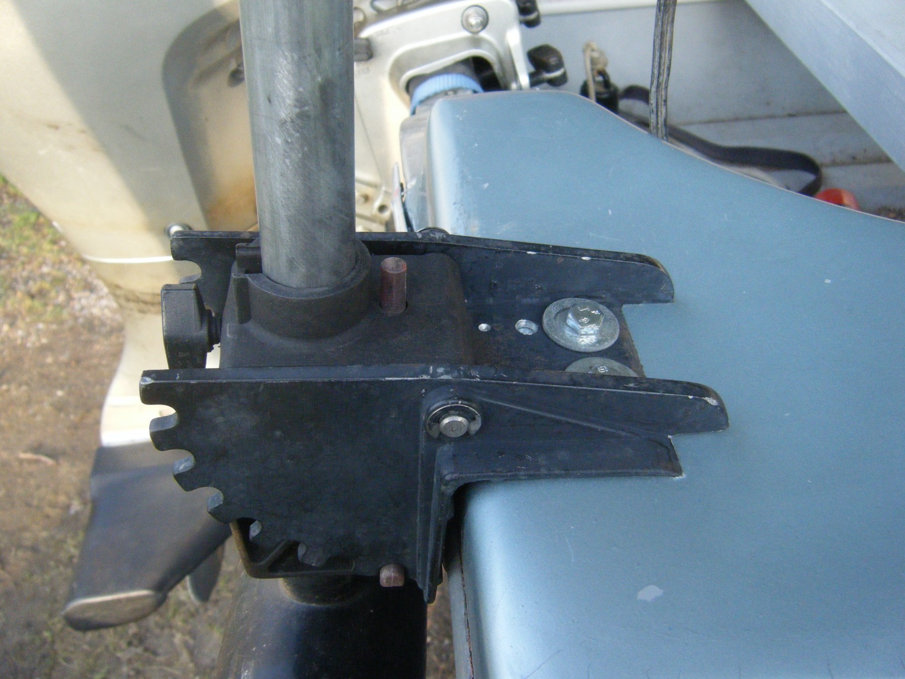

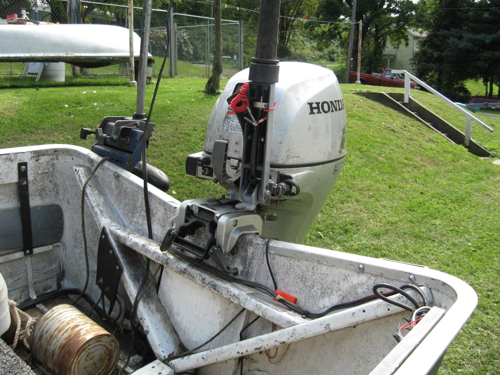

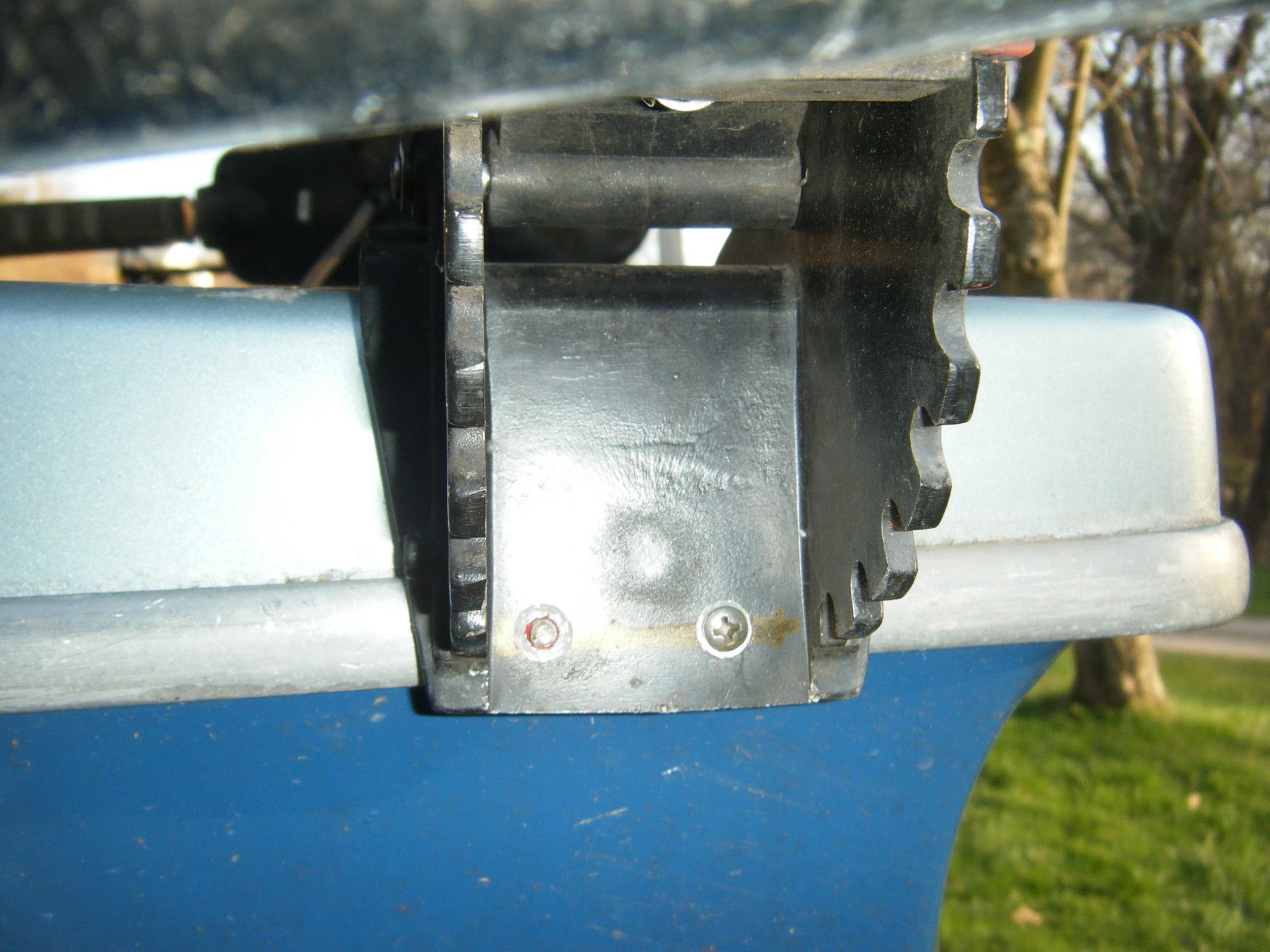

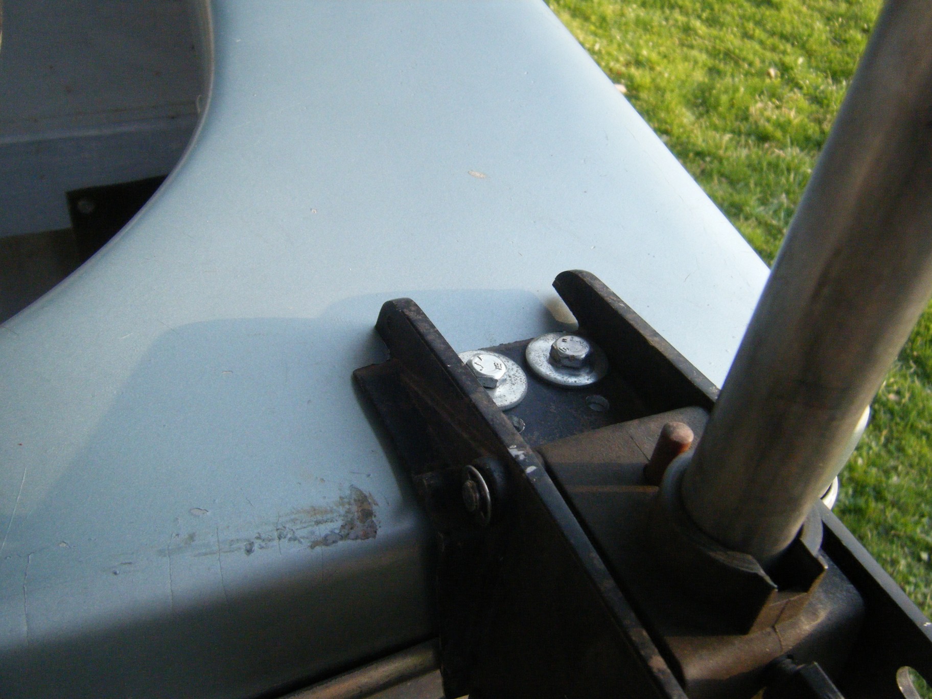

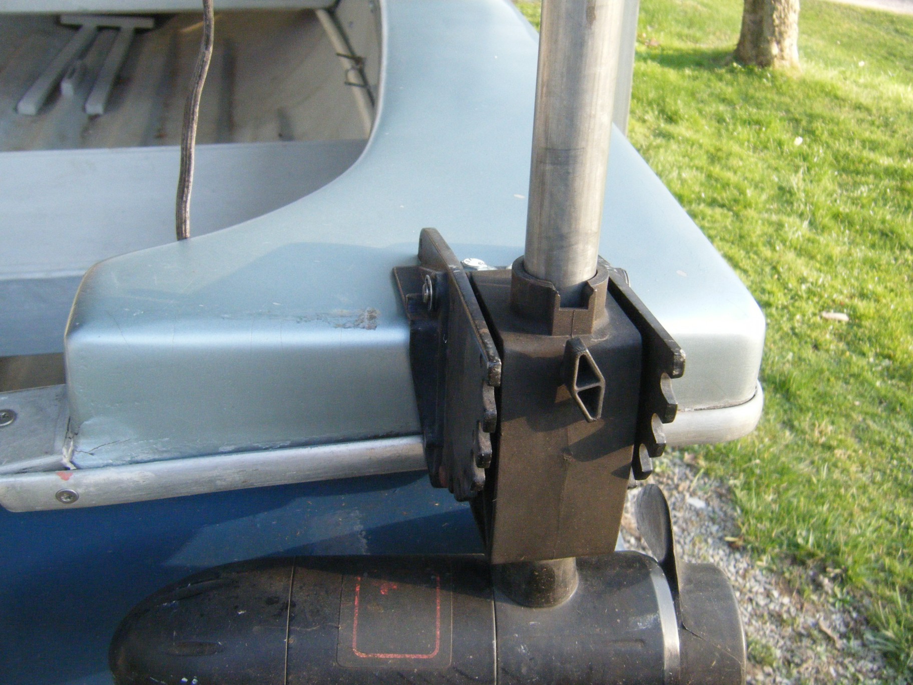

On my MFG I just sold I took off one of the handles on the stern and made a bracket out of high carbon steel to match the offset angles to make it plumb and straight both ways. I put a small chunk of 3/4 inch treated I had laying around. It could come off in seconds. Only problem was you had to paint it every few years. But it could have been easily made from aluminum. On my Winner I cut the original cast aluminum mount on the trolling motor to lay flat on the gunwale. I drilled some holes and just screwed it through the fiberglass into the wood under. I'mm get some pics later. I have not even tried it out yet. You can see the mount I made on the other side of the Honda.
Re:Trolling motor mount idea 12 years 4 months ago #92725
Here goes. Yes that's a big goober where high wind knocked down a pole. But it's time to fish. The holes can easily be repaired if need be.
