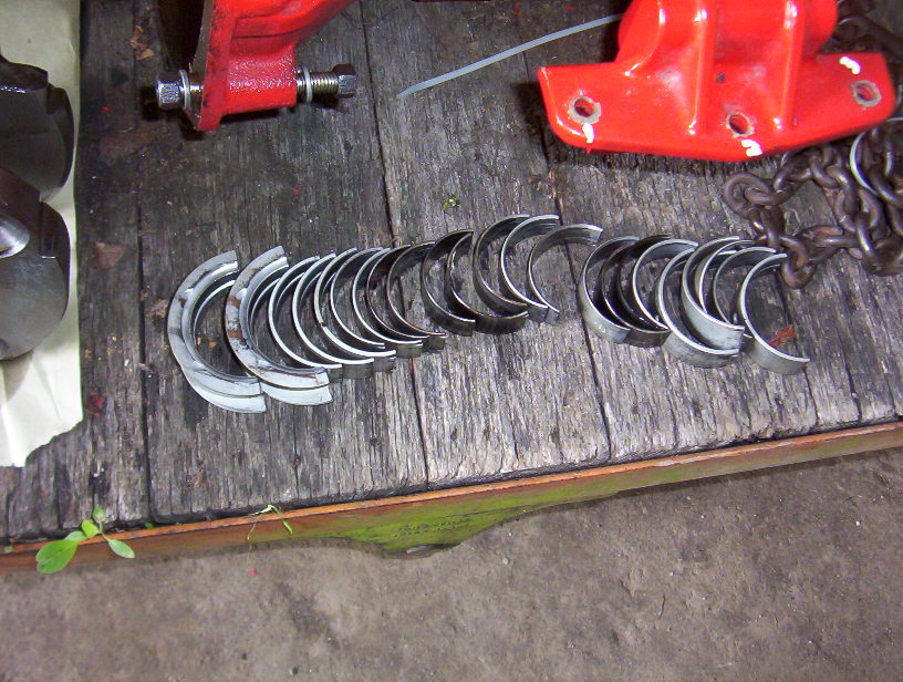

I took her out for a final test ride before installing the engine cover and balance of the interior. When I took off from the dock she was running great but on the way back down the lake to the dock she started loosing RPM bad. I knew somthing was not right so shut her down and costed to the dock and pulled the boat. Got her home and put water to her and she was ratteling like a brass band! To make it short, she spun four rod berrings. Ouch!!

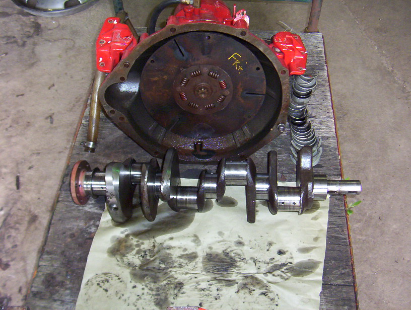

This engine had been down and redone before I bought the boat and was done about 16 years ago. The boat sat after that till I bought it. The short story, rear main was cut 1/4 inch short which allowed the oil to flow to the bell housing when RPM forward thrust was put on the engine and starved the crank for oil, other things also due to a poor job by someone who did not know what they were doing when putting this engine back together.

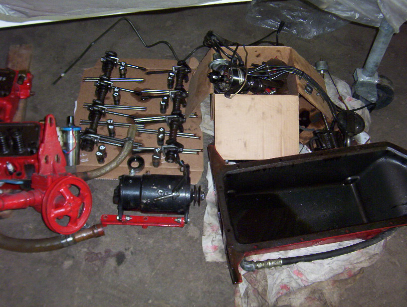

A very sad day. I've seen a lot of damaged engines from poorly installed parts. Most times the person that did the work saw the problem and the justifications to let it go can get wild. From the pics it looks like your quick thinking to shut down limited the damage to the bearings. If there is a bright side you didn't frag the motor at WOT. I always recomend the use of gauges. An oil pressure gauge can make the difference between a rebuild or replacement.

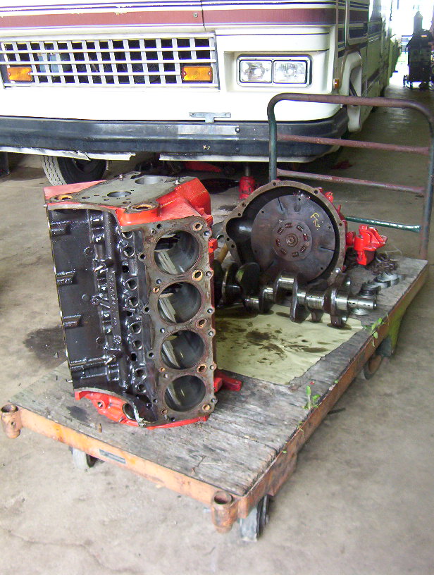

I picked up a reconditioned crank and a set of connecting rods from them this morning. We now have all the replacement parts and are working hard to get her back together time for Algonac show.

Took the heads to "Performance Automotive" here in Hillsdale early this AM. They are installing all new hardened intake and exhaust valves and seats and correcting anyhting else that might be needed on the heads. They finished boiling the block yesterday and honing the cylinders and the engine is back at "Tri State Fleet and Trucking" a super great guy and mechanic Mr Jay Bumpus owns the place and he's just great! I figure anyone who has been rebuilding Kentworth, Mack and Peterbuilt engines all his life would consider this job duck soup, he's starting reassemply of the block today and Performance should have the redone connecting rods ready tomorrow.
