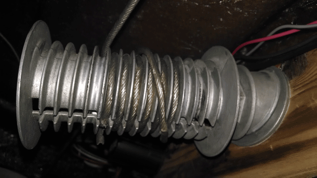

Please post a pic of what you are dealing with. Both cables should be coming off of the top. They should also be wound around each grove area 2-3 times if yours is a double grove drum. Your issue may be in the position of your pulleys on each side of the front of the boat, not feeding the tiller line properly.

  • haplife
  • haplife's Avatar Topic Author
  • Posts: 13
not a problem. I appreciate any help even it's late! I have attached a picture of the drum before I took the old cable off. you can see how it is skewed and that the grooves are also skewed. the one side has come out of the groves. when I put the cable on "backwards" from the original setup..it is smooth and stays in the grove...but steering is opposite. that is what makes me think the drum needs to come off and rotated 180 degrees.
