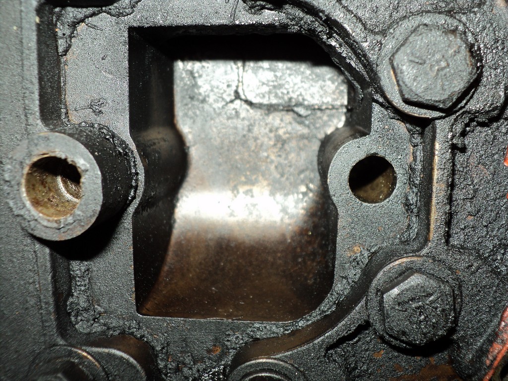

Here's a pic of the bottom of a 40hp powerhead I assume its fairly similar to my 60. 13 bolts?

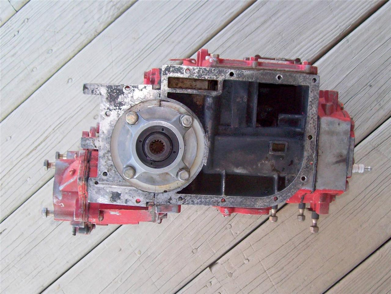

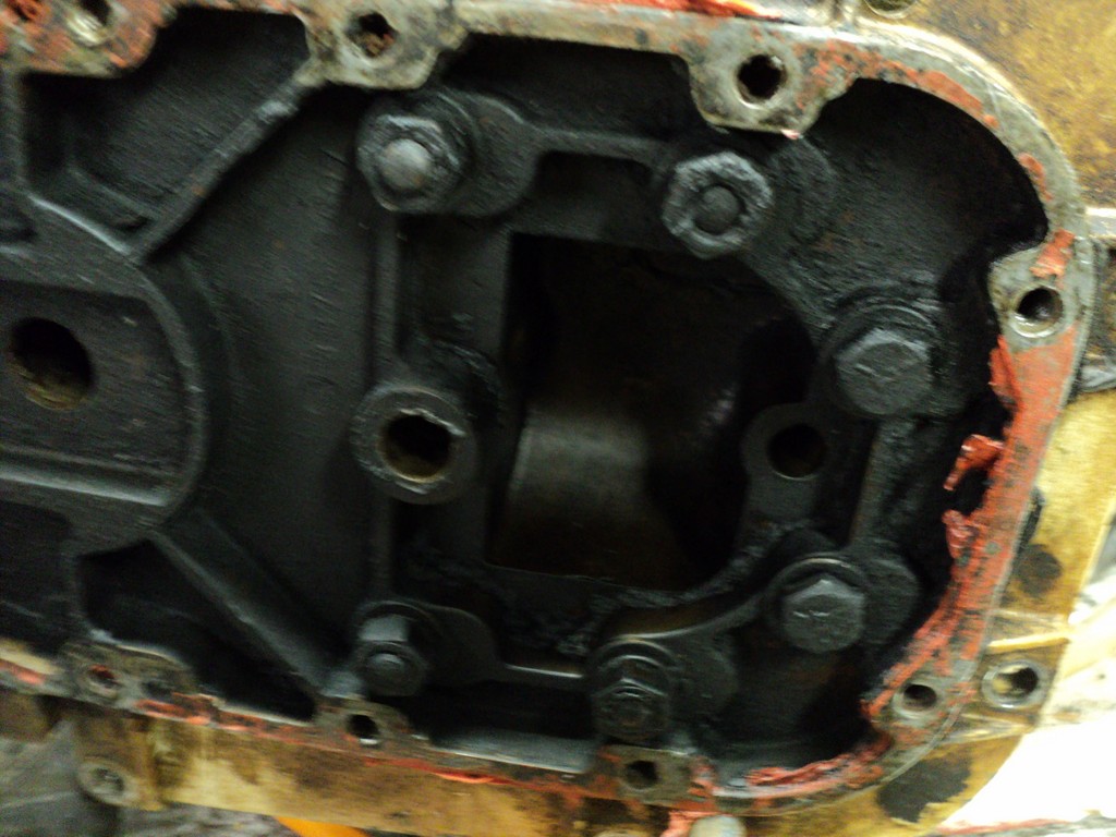

So, you'll probably get a few out, and you now have a decision to make. You can break the rest off and pull the cover leaving you with a lot of drilling and easy-out work, or you can cut the heads off with a die grinder and cutting wheel, or some similar method. This leaves you with a bunch of "studs" left and with a vice grips and a with a lot of heat for a very short time period from an oxy-acetylene torch (I use a rose bud tip) applied to the block on both side of the screw hole allows them to be easily turned out. You can see on the attached pic of the 75 HP I am currently working on where I had to heat a couple of bolts to get them out. A hand held propane torch won't put out enough heat, but you can give it a try and you might be lucky.
By the way, the 75 hp has more cover bolts than the 60 hp, which tells me the cover has had leak problems in the past and Scott tried to fix it on the 75 hp!
With the cover off you can now heat the center row as well as the outside rows. That's another reason to cut the bolt heads off. It allows you to remove the cover to heat the center bolts.
If you want to reduce the amount of bolt heads to cut you can remove the side and end bolts with heat and then just cut the center bolt heads. You usually have to heat a little more because you can only get to one side of the bolthole this way.

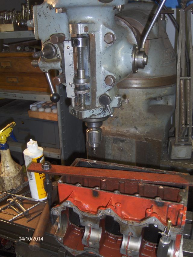

Once all the bolts are out, I use a 1/4-20 bottoming tap to clean each bolthole. Occasionally you will find the tap may hit bottom and keep right on turning. The threads have been corroded away. Now it's time for Heli-coils. I used a 1/4-20 2D (twice the bolt diameter) 1/2 in. long. NAPA may stock them, but they can order them if they don't. Their part number is BK 7703117.
Also, before you install the cover it's a good idea to screw in a 1 in. long 1/4 -20 bolt with a couple of washers in any hole you that you didn't have to Heli-coil. Torque it to 30 inch pounds (factory recommended torque for these bolts) to make sure the threads will hold during the final installation.
I really don’t like recommending patch jobs, but to do this job “right” is a real b**** IMO! Getting Heli-coils in straight and on center is difficult. The block I am working on now had a botched Heli-coil job and even has a broken off tap in one hole. As you can see I use a vertical mill to get the Heli-coils straight and on center.
