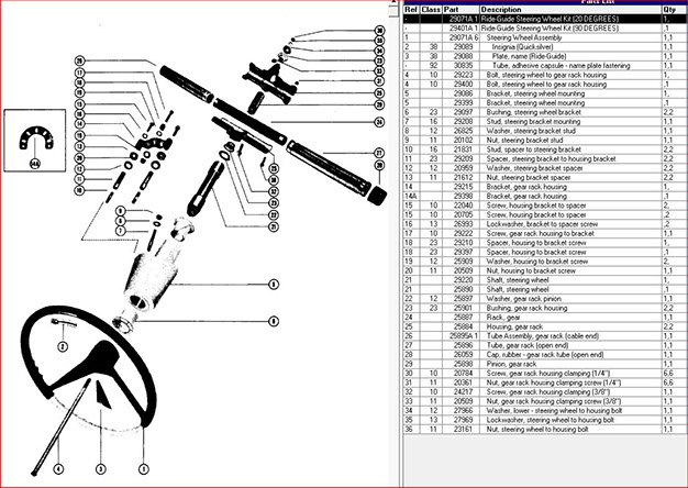

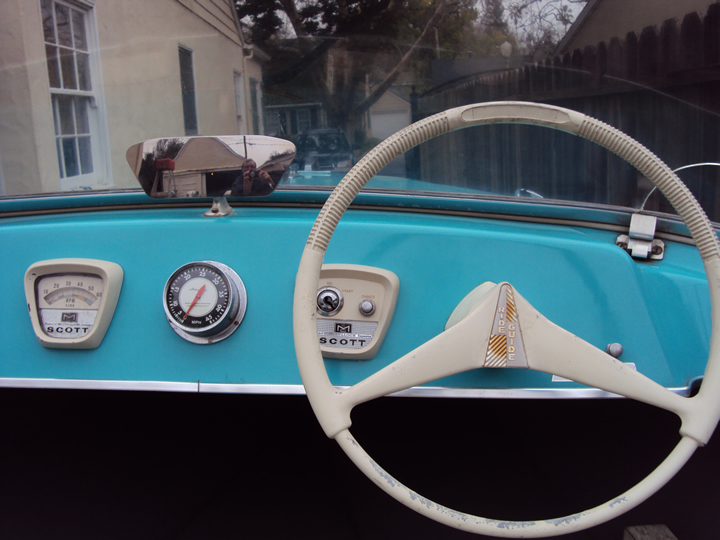

Mine says Ride Guide on the steering wheel. Is this what your looks like?

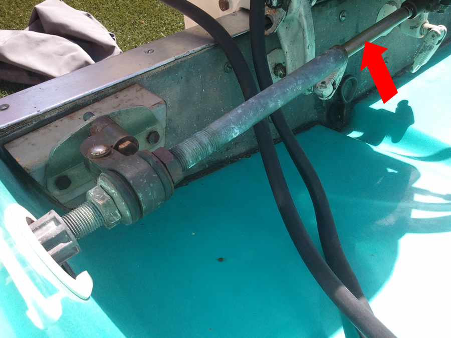

Mine locked up after I first started running it in the water and then let it sit for a couple weeks. (Very embarrassing at the launch ramp, the boat fired right up but I couldn't steer the motor. Epic Fail!)
I needed to disconnect the steering ram from the motor and the bracket on the transom. Then I could get it vertical so I soaked it with WD40 letting it run down the ram. After it sat a little while I was able to slightly move the steering wheel. I had my wife work the wheel back and forth with light force while I continued to soak the ram and eventually it released. Now every time I close up I WD40 the ram and turn it fully both ways several time to distribute the lubricant and (hopefully) displace any residue water.

Shacomm... fyi.. Ride Guide is a Mercury brand name steering... similar to Johnson's Shipmaster... or Evinrude Simplex.

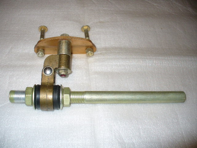

If your transom components are too corroded, we do have a new old stock assembly.
Regards,

Hey Mad, hope this helps. Your cable is held in to the steering tube aka gear box, by way of threaded shaft and nut with lock washer. After soaking I would recommend placing a drill on the inner cable and try nudging it to spin if it don't spin soak it some more. Don't forget to clean and inspect the gearbox while you are at it.

Yes... that makes sense. It looks to be a fairly popular setup.
Interesting, I thought the flat at 12 o'clock was a spot with Mfg name Dorsett. (Mine is missing). But the diagram above shows it said Quick Silver. Were these private labeled here by the boat Mfgs?
