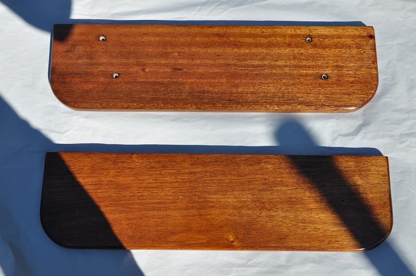

The first photo is of the footrests that are just below the mahogany bulkheads:

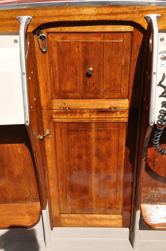

[img] The second photo is of the mahogany door leading to the cabin on our Seafair Sedan. That is with six (6) coats of "Interlux" shown below: [img]http://www.fiberglassics.com/media/kunena/attachments/legacy/images/DSC_0732-20140313.JPG

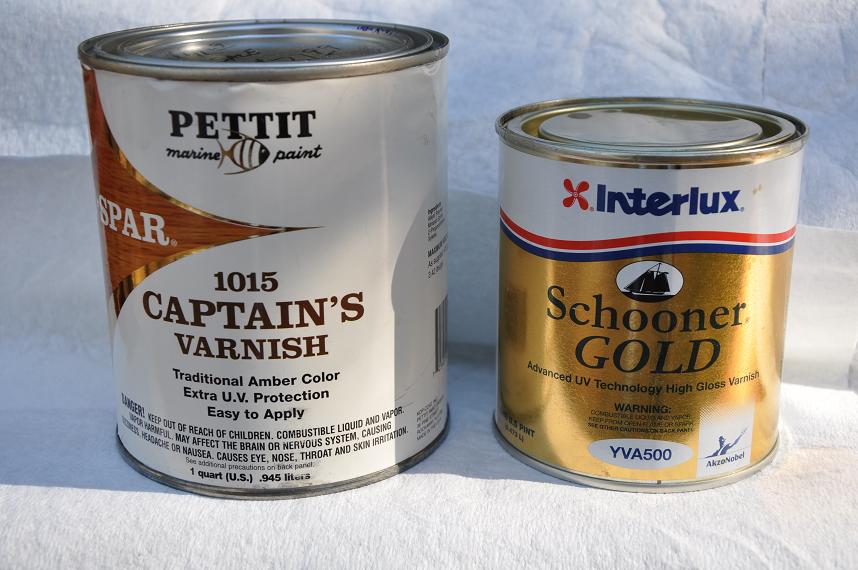

Here is a photo of the "Interlux" High Gloss Varnish that we used Norm:
Norm, we tried the "Pettit" High Gloss Varnish, but for us it just did not seem to work as well. It may have been something I was doing wrong. BUT,...the "Interlux" High Gloss Varnish worked great and I was very pleased with the way it came out.

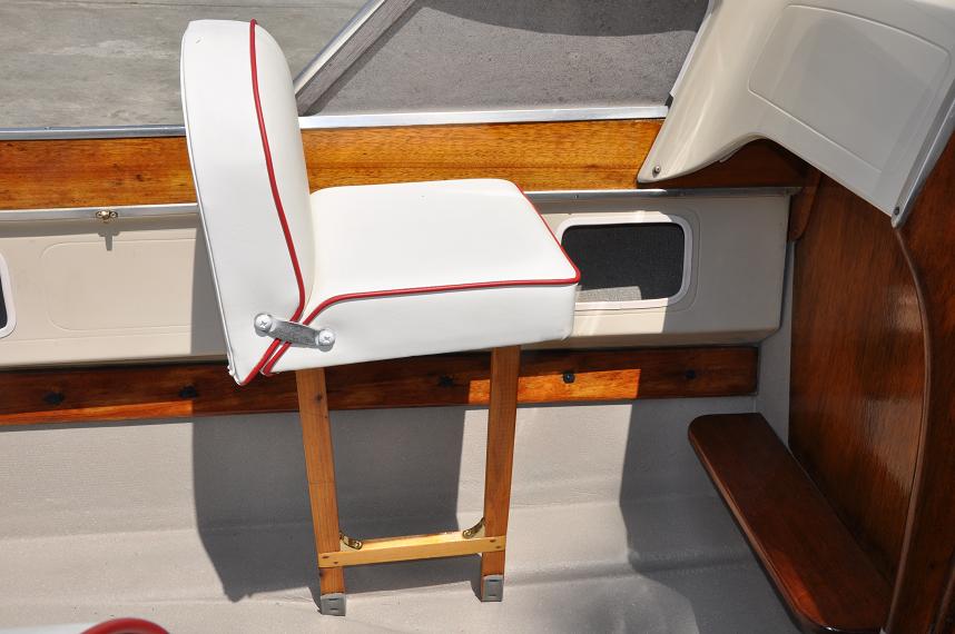

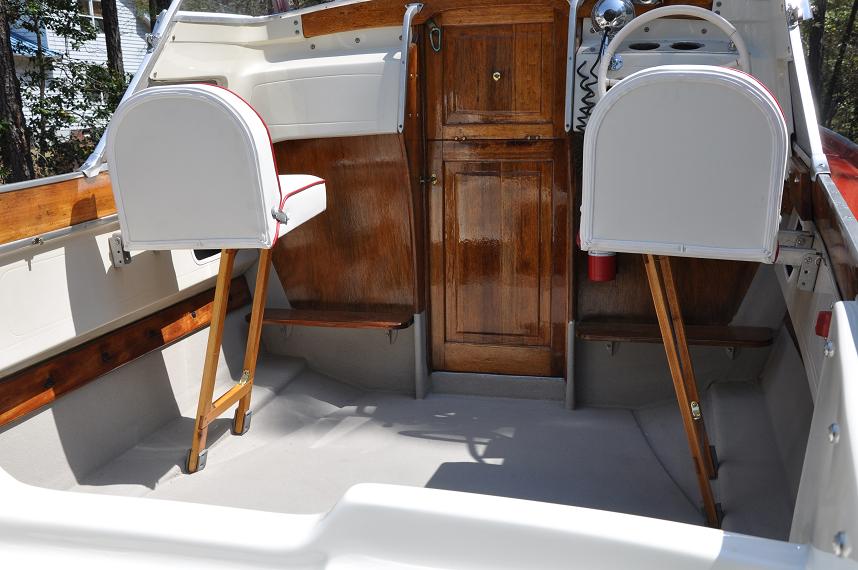

Norm, here are a couple more photos of the mahogany bulkhead and trim boards alongside the seats from a little further away. These photos were taken before we finished installing the gauges and switches on the driver side dashboard.
