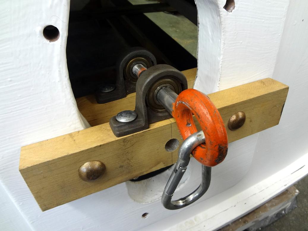

I've watched all the videos on Youtube and talked to a lot of people about the best way to turn a boat upside down. I've done it with straps, chainfalls, come-alongs, whatever. Today, we wasted about 90 minutes trying to flip a 17' Donzi and had all kinds of problems. After thinking about it awhile, I came up with this idea. I made this in 30 minutes with stuff I had sitting around the shop. By using a rope and come-along on the bow eye and another come-along hooked to this rig, we flipped this boat in five minutes.
I used two meaty pieces of maple, two 3/4" pillow block bearings and a 3/4" eye bolt with a 6" shank. The inside pillow block is used without tightening to the eye bolt and so can slip right out for installation/removal. The maple was drilled for mounting to a transom drilled for a Mercruiser Alpha outdrive but can be easily re-drilled to match other bolt patterns.

Great job you make it look easy! I guess the only part i dont understand is how you keep it from rolling as you lift? Is there any control? How hard is it to roll back right side up? Seems easy to set up but im thinking at least two guys. Thanks for the pictures now i am less scared of smashing my boat instead of flipping it!!!

Given that the front bow eye is stationary, the rear mechanism needs to be positioned such that you find the center of balance, or at least close. When it's in the right place, the boat will turn easily with one person and can be held in the flat position with one hand while you lower the come-along with the other. It really is quite easy to do.

The picture where its suspended bow and stern was the natural attitude of the boat so it was easy to flip to the top or bottom basically because it was almost on its side when i lifted it off the cradle. The only thing i would suggest would be to make very sure the bow eye and the hull where the eye is attached to is up to the task which meant me crawling up to the bow with fresh backer blocks , nuts and over-sized washers .
