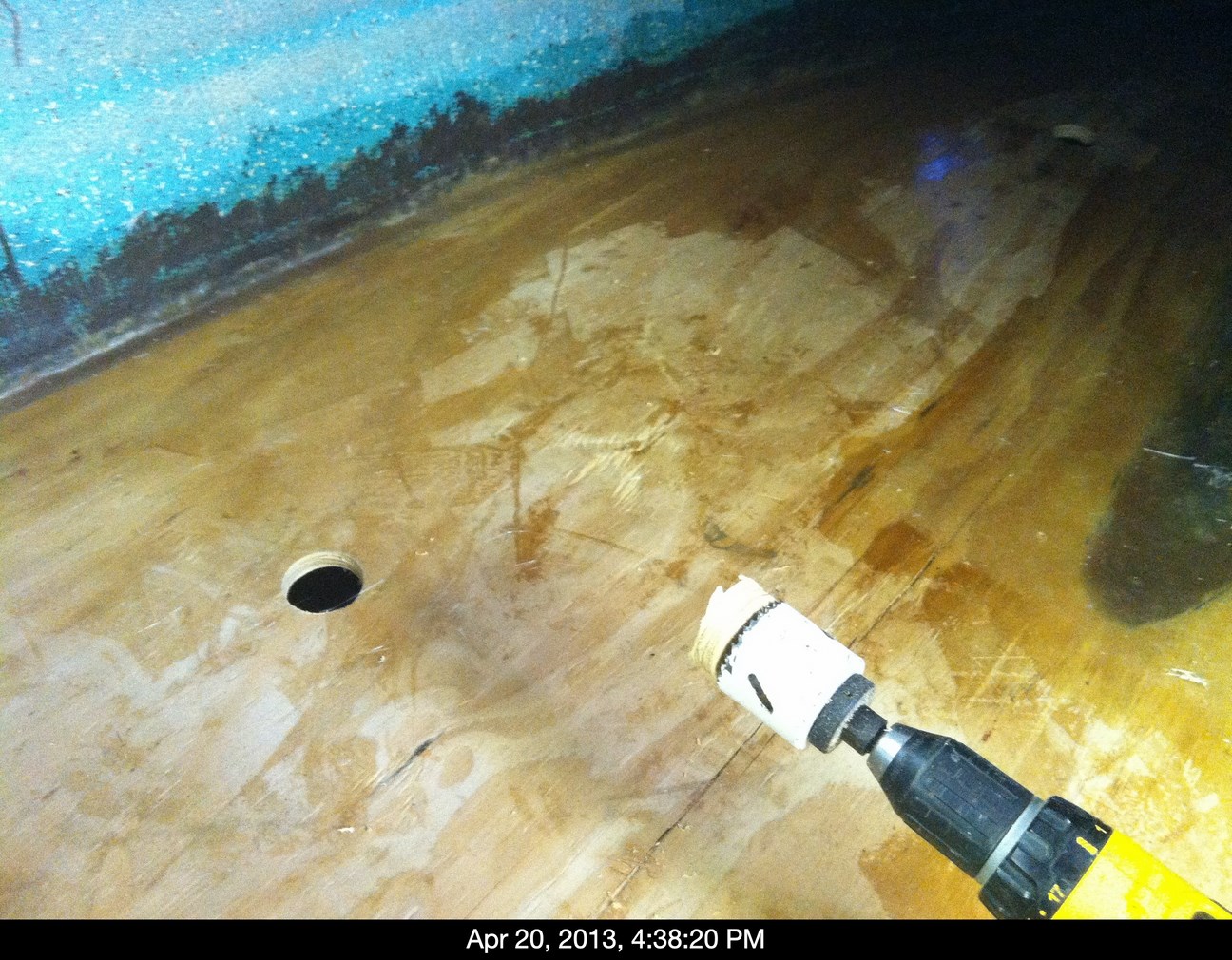

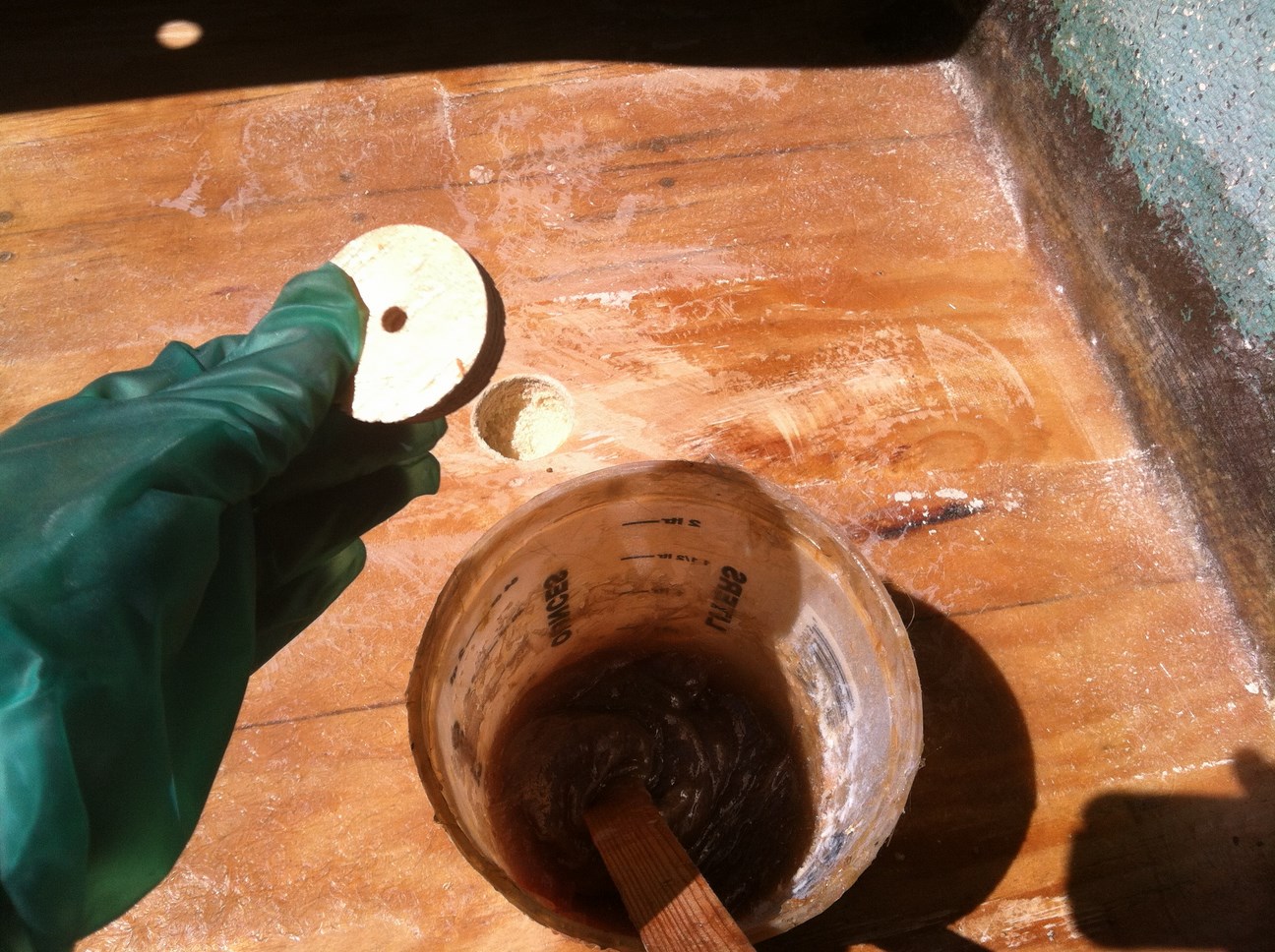

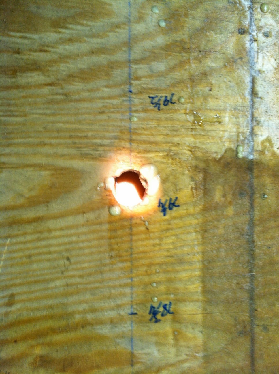

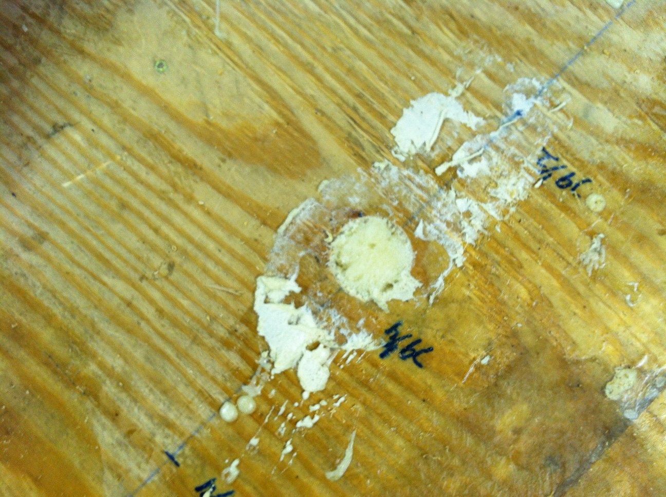

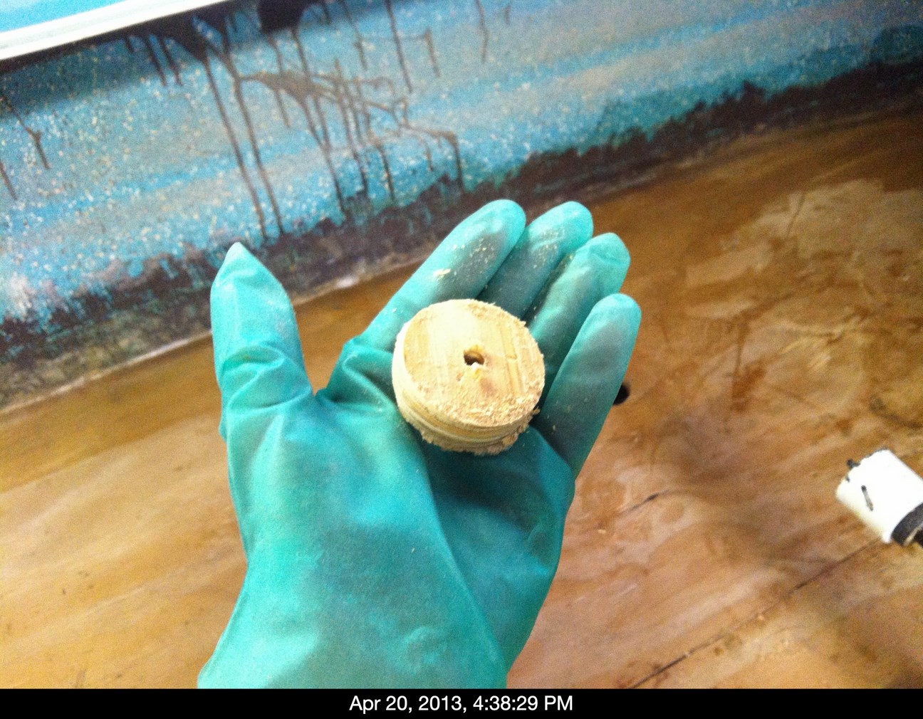

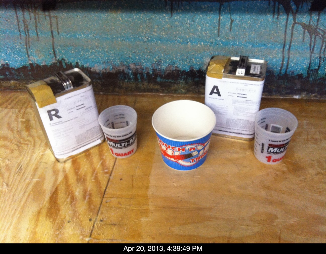

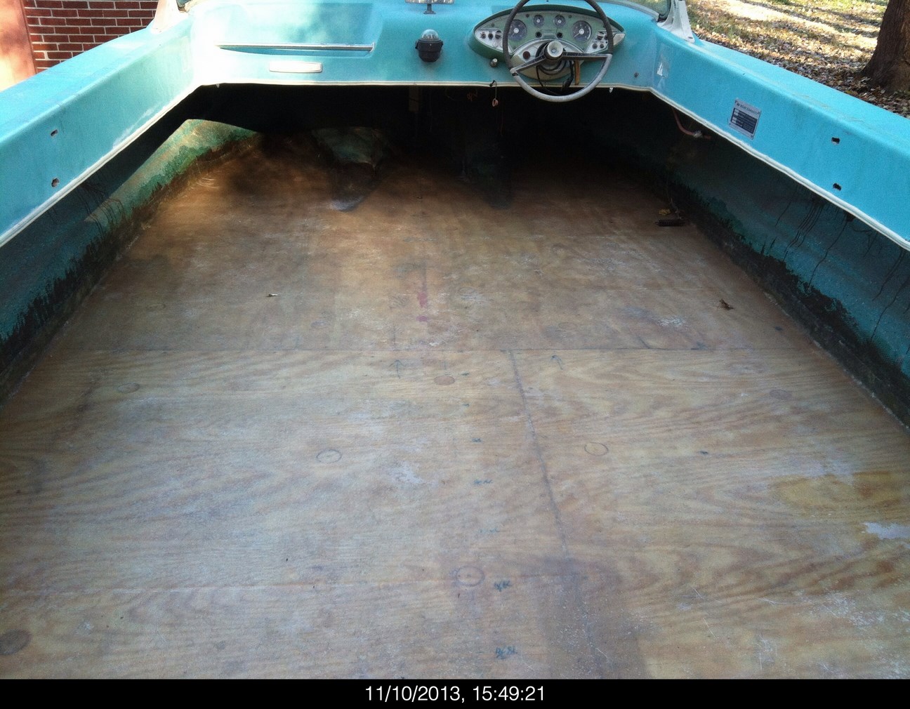

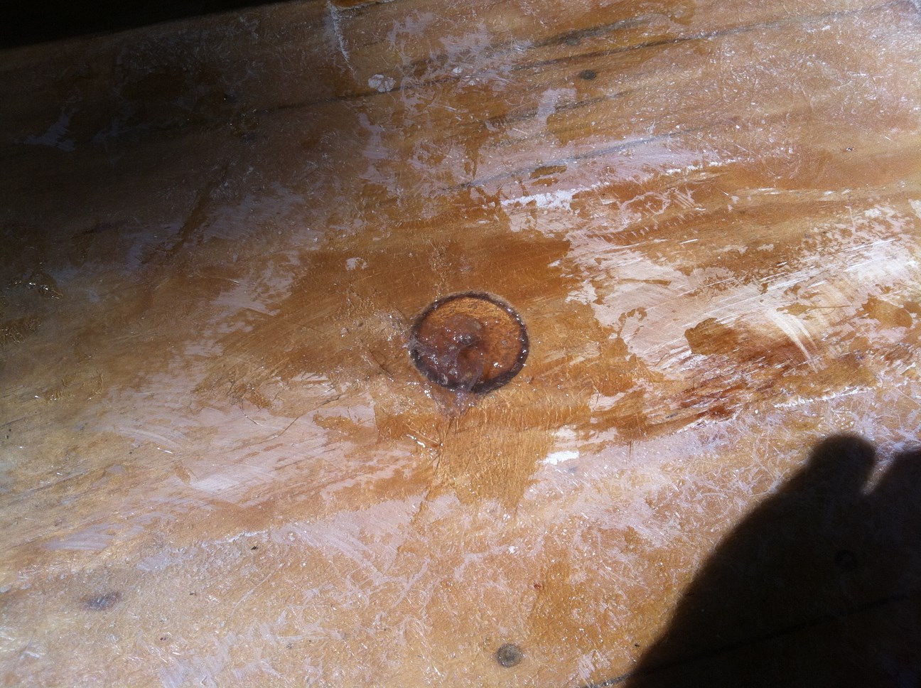

I'm totally in support of the foam. When I put it under the floor of my Johnson Deluxe it became rock solid and deadened that hollow sound. I put my deck down first, fileted, and tabbed it in. Then I bored holes in the deck to pour the foam under the deck. I made sure there were extra holes to let air escape. PB'ed the wood plugs back in and laid 2 layers of chopped strand mat over the entire deck and up the sides several inches to create a type of bathtub to keep water out. The trick is to not ever screw into that part of the deck, but glass in an extra layer where needed to fasten everything down without penetrating the bathtub.
I bored 27 holes total.
Keep the wood plugs to glue back in.
Ready to mix and pour. I had about 30 seconds to mix it up and pour it in.
You can see it expanding in the cavity and you will feel the deck and hull get warm everywhere it touches. That helped me know it expanded nearly everywhere.
After the foam had hardened.
Remember that plug?
Glued back in with peanut butter.
After sanding and the 2 layers of CSM. You have to look hard to see the 27 holes I bored into the deck.

Andrew had better luck than we did the first time. We bored 2" holes and poured in foam...what we "thought" was the right amount. The foam came up out of the holes and then hardened...but the foam beneath wasn't finished doing it's thing. The result was that we stood there and watched the expanding foam make the decking convex...a lot! So...we tore all the decking up...not much choice. That was when we found that there were a LOT of voids beneath the floor where no foam had spread. We shaved the foam to the level of the framework, added more foam to fill the voids, shaved again and then installed another floor. From then on, we have used the "overfill and shave" method. The decking goes on after all the foam is level with the framework. No problems. (See the "after" photo in my post above.) I like no problems.

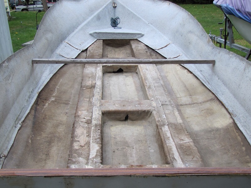

How about some thoughts about adding foam in a boat that did not originally have it. I am thinking about my 59 Glastron. It would be easy to seal up the spaces between the stringers and pour foam. However, the stringers themselves are inverted fiberglass channels and could probably not be properly filled. Sealing off the "drains" (see photo) would itself be easy, but would this create a potential problem elsewhere? Would I still need to have a drain for inside the stringers?

You asked for thoughts so here goes. I have never tried this, but I think it would work. Basically you want to provide a drain path for any water that might get in. How could it get into a sealed bilge you say? Well, how about a situation where you have just beached the boat on a nice sandy shoreline but there were stones that you didn't see that rubbed off the gelcoat on a spot on your keel. Now you have water getting into the bilge but no way for it to get out if it is completely foamed and sealed. So, what if prior to foaming the area you lay down some plastic sheeting (maybe just some trash bags) in the bilge. You would not want o cover every area as you want the foam to adhere to the bottom in some spots for rigidity. You also leave the drains open by covering over with the plastic. Then you add the foam. Now, if any water gets in it can drain under the plastic (which is under the foam) to the rear where you would have a small well area with a conventional drain trough the transom.
I think this method would allow the original intent of the design to function so far a draining water out; while giving the advantages of floatation safety, and hull dampening that foam provides. However, as someone pointed out, this method could also allow water to get into the bilge through the well under some conditions, so it is not without concerns. The attached photo of my Saber Craft shows the well area that I am talking about. I just foamed and sealed this boat and then provided a small vent. I only thought about the plastic idea after it was all done. I think I will always wonder if the boat is really perfectly sealed and whether the foam is getting soaked. No way to know unless the boat starts to get real heavy.
Just some thoughts,
Bill

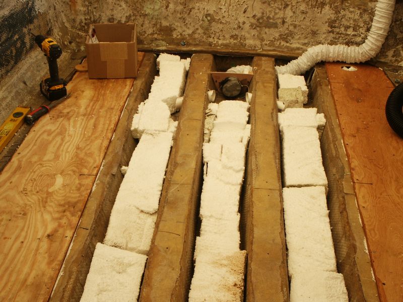

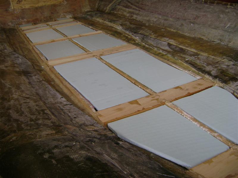

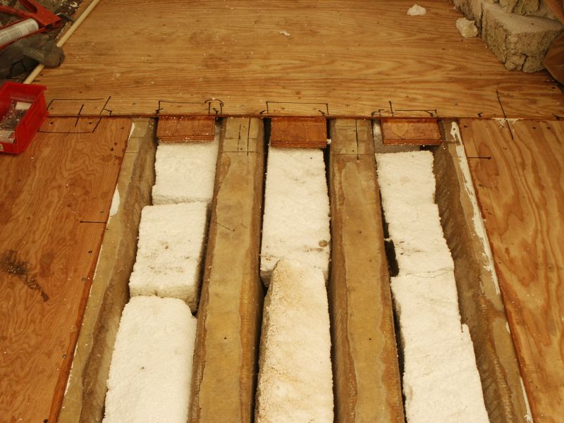

Lots of good replies here. But I may be able to add some insights. I spent many years running the US Coast Guard's program testing boats for flotation.
Simply put, if flotation is installed correctly it works. It keeps the boat afloat and provides a much better platform to sit on and one that is easier for rescuers to see. It saves lives.
But then the question arises, how to install flotation? By the way, it doesn't have to be foam. I have seen everything from beer cans to ping pong balls used as flotation. If it displaces enough water then it works.
So, what did I do on my own boat?
I used polystyrene foam from Home depot. 2 inch thick planks, 2 feet by 8 feet. I cut the planks into pieces to fit into the voids. But first, I coated all exposed wood with clear penetrating epoxy sealer, and then several coats of regular epoxy over fiberglass. No water can get into that wood. I then bagged all the foam, that is, encased it in polyvinyl plastic sheeting and sealed it. So no water or any other liquids, like gasoline, can get to the foam.
see here: http://newboatbuilders.com/pages/SeaRay190.html
There a lots of ways to do this but this way ensures no wood rot, and no water in the foam, as well as no foam degradation due to things getting to it that shouldn't.
I could go on at great length about studies done on why some foam absorbs water and some doesn't, but if you search the posts here I think you will find other posts I have made on that subject. http://www.fiberglassics.com/fiberglassics-forums/home/main-forum/wet-foam-what-a-pain#66690

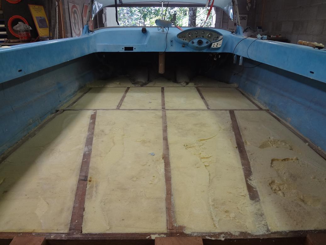

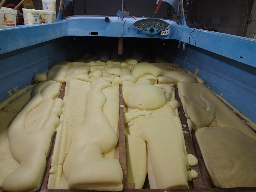

When I was wrestling with the foam issue (could I afford it, was it necessary, etc.) I decided the foam had to do 3 things if I put it back under floor.
1. Keep the boat from sinking if the worst ever happened.
2. Fill the hollow cavities and deaden the sound.
3. Add strength to the hull.
By using the mix and pour foam made specifically for this and pouring it under after the deck was tabbed in accomplished all three.
1. I added 7 gallons of floatation foam under the deck, enough to float more than 4000 pounds (my Deluxe will weigh 2500 tops).
2. The foam expands to fill the hollow cavities. I drilled extra vent holes around the perimeter and the foam came out all of them. That also let me know it expanded through out.
3. This foam sticks like glue to whatever it touches, so it created a mechanical bond between the deck and hull that added the extra strength.
If I had to do it again I would do it the same way.
