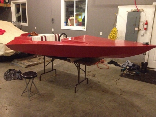

Thanks for the help. Here is a pictures of what I have at the moment. The transom has most deffinetly been reinforced. I will measure my boat next time I have a chance to work on it.

Nice! I've thought about building that boat.

NICE boat, too.
