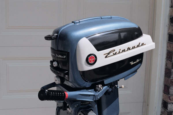

Next. I just bought a 1957 evinrude fastwin 18hp and am wondering , What are some easy things I can do as far as tuneups over the winter to ensure it's ready for summer? Keeping in mind I only have basic tools and an extremely limited knowledge on motors.
I was thinking maybe there's some really easy filters to change or maybe spark plugs , ect?

The 18hp Fastwin is one of the best motors made. It puts out lots of power for it's size and it doesn't weigh that much. In addition to the things you have already been advised of Things to look for are cracked ignition coils and dried out water pump impellers. The coils can easily be checked by removing the recoil assembly and the inspection plate on top of the flywheel. Look through the hole in the flywheel and see if the coils are cracked if they are replacement is fairly easy. You will need a flywheel puller (I bought a harmonic balancer puller and the correct size bolts that fit into the flywheel) and a few screwdrivers. Getting the flywheel off is easy just run the bolts through the puller into the flywheel evenly about 1/3" down then tighten the puller bolt until the flywheel pops up. Once you get the flywheel off it is obvious how the coils come off and on. If you are lucky and the coils are good just check the point gap .020 and you should have spark. To check the impeller you will need to drop the LU. simply remover the small cover on the tower and remove the lower bolt in the shift rod linkage. Undo the bolts holding the LU on 4 small and 1 large (the last one you undo) then pull sharply down. The impeller housing is then self explanatory as to taking it apart. If it is nice and pliable re use it if it is stuck in a shape replace it then reverse the dissassembly process. You will need a pressure tank which you should easily find at an AOMCI meet or on ebay. The fuel mix is 24:1 and ethanol free fuel is best.
