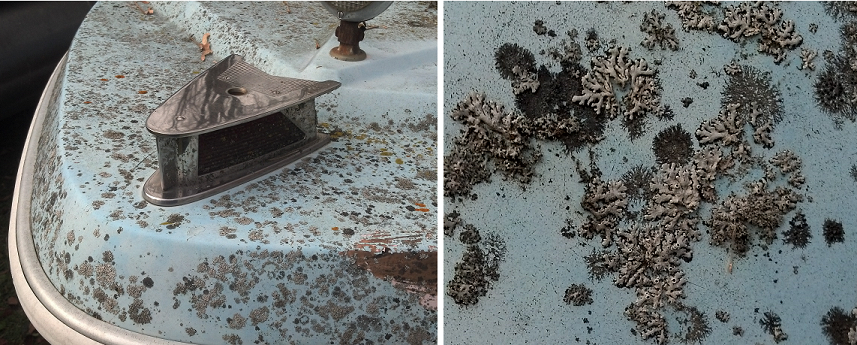

Boat Needs Moss, Lichen, Mold, Mildew Exorcism 12 years 9 months ago #86573
What products are recommended, safe to the hull and finish , etc.
This is BAD !!!

Re:Boat Needs Moss, Lichen, Mold, Mildew Exorcism 12 years 4 months ago #92436
Growth like this normally damages the surface of the gelcoat / paint. The organisms actually "root" into the outer surface of the finish, leaving it rough appearing where they were attached. This is because the sheen had left the finish at some point making it porous. The porosity of the finish enabled dirt to collect and for these little buggers to make a living. So because of this, even when fully cleaned off, the finish of the fiberglass will not be completely smooth. The point of all this is to say, use anything you want to clean it it, as long as it doesn't gouge deeply into the finish. A pressure washer is a good place to start. Take it to a car wash & spray it with tire cleaner & let it soak in for half an hour. Then blast it off. Any bleaching cleaner will help to kill the spores that enable growth. You can use comet cleaner and a scotch-brite scouring pad. Start with the least abrasive pad you can find. If the stuff won't budge, get nastier pads or cleaners to do the trick. If it's gelcoat under that stuff, you will probably have to wet sand it (if possible) and then spend many hours buffing it out with compound. Some of these can turn out surprisingly well.

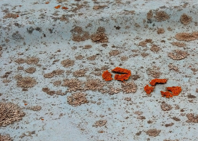

1st pic is from original treatment.
2nd pic is an inspection today to see the effectiveness of this product.
Re:Boat Needs Moss, Lichen, Mold, Mildew Exorcism 12 years 4 months ago #93501

Either you posted the wrong pic or that stuff was wholly ineffective. I'm new to boats but I'm no stranger to molds, mildews and lichens having been a painting contractor for nearly 30 years. I've had to get this crap off of all kinds of surfaces, wood, vinyl, aluminum siding, metal buildings, concrete, even fiberglass hot tubs. Miracle cleaners are almost always a waste of money. We always use plain old bleach, 100% straight from the jug into an old windex bottle, add 5 or 6 drops of liquid laundry soap for "wetting", this will allow the bleach to fully penetrate the lichens. Keep it wet for 15-20 minutes and hit it with a power washer. I wear painters whites so it doesn't matter, but make sure you're wearing old clothes when you're doing this. If you're doing this while parked on your lawn, wet the grass around the boat before you spray the bleach, and then hose it down again after you've washed the boat.
