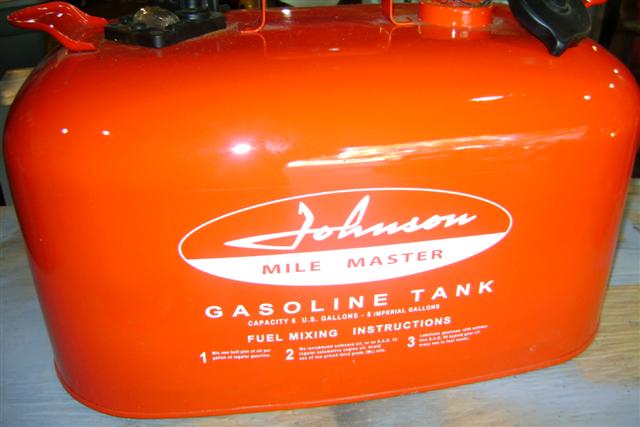

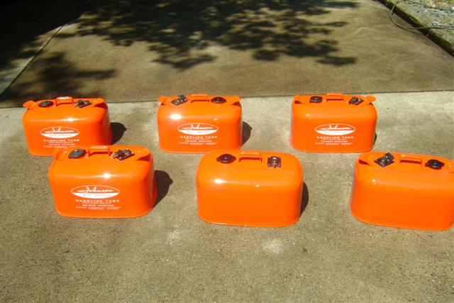

Since it is the winter I have decided to take on a hobby/project that I really enjoyed during the restoration of my boat. I have eight 6 gallon tanks, one 4 gallon and one three gallon tank that I am restoring.
I strip all of paint and any rust, clean the inside of all rust and gunk. I will replace all gaskets, cork floats and glass indicators as needed. All dents pulled out. I then will use high quality automotive etching primer and I have color matched the paint and will use high quality single stage automotive paint (4 coats)that will fend off any rust and allow no penetration by gas and oil. I cant screen print the original logos but will put decals on them. I have seen a guy on ebay asking $175 for tanks and can tell that the paint is not high quality as I can see pitting.

If the tanks are single line versions I simply wouldn't bother unless you need the tanks for yourself. No one is going to pay even what is your cost for a restoration as you describe for a tank that can be replaced by a new plastic one. If the tanks are the 2 line pressure tanks don't expect to get much over $100.00 as most people who would want these tanks would simply find a really good original for about $100 (ebay is a false guide for pricing) or start with a $15.00 one and do all the work themselves. nymarine.ca has all the parts, paint and decals in stock so your chance to profit from this work is minimal at best.

There is a lot of prep work to painting. You only use Metal etching primer on bare metal, and rust on the lower welds is really hard to remove without sand-blasting. I would recommend blasting the whole tank. I used "Lab-Metal" to fill the small dents. You can't "pull" dents without drilling a hole, which is something you don't want to do. If there is ANY rust on the inside of the tank, don't use it, or get a product called "KREEM", which you can get at any motorcycle shop. If you don't it will come back to bite you in the butt. I used PPG "Paxton/Urbana School Bus Orange" paint. It was the closest thing I could find to the original color. All my decals I got from Peter at nymarine like Andreas said www.nymarine.ca/ I replaced all the cork gaskets which I got at Sea-Way Marine www.seawaymarine.com/
I probably have 4-6 hours in each tank and $50 - $75 in each tank. If you could sell them for $100 you would be lucky. Like I said, it's a fun project.

Tim, The cork sight-glass gaskets are only a few cents. I think I bought a package of ten for a couple bucks. Shipping old gas tanks is a no-no. They're considered Hazardous material. Shipping new ones may be OK, but not sure about repainted and cleaned ones. You could box them and take your chances.
I forgot to mention I use Duratech Polyurethane primer. It sands great, but you need MEKP just like resin or Gel-Coat.
I don't want to rain on your parade, because I have done a bunch at a time for my own use, but always thought if someone wanted one I would sell one for around $125, so I think you're right on with that price. I shopped for a long time in boat parts places, and Craigslist until I cam up with 10 good tanks, but even some of them had too large a dent, or something that made me set it aside. To make it work you really need to shoot about ten at one time.
