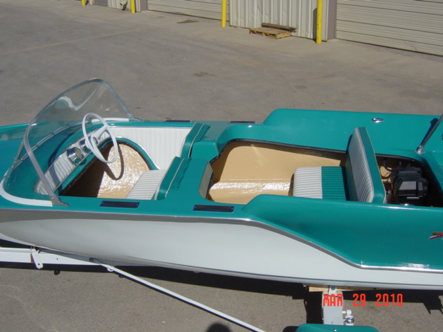

I had the same problem trying to find the aluminum rub rail for my Tomahawk, which was missing one section. Finally robbed some from an old junk boat in a field and formed it on my workbench to the proper shape. It is quite flexible and easy to bend to shape. I then polished it with a polishing/buffing wheel. Picture attached

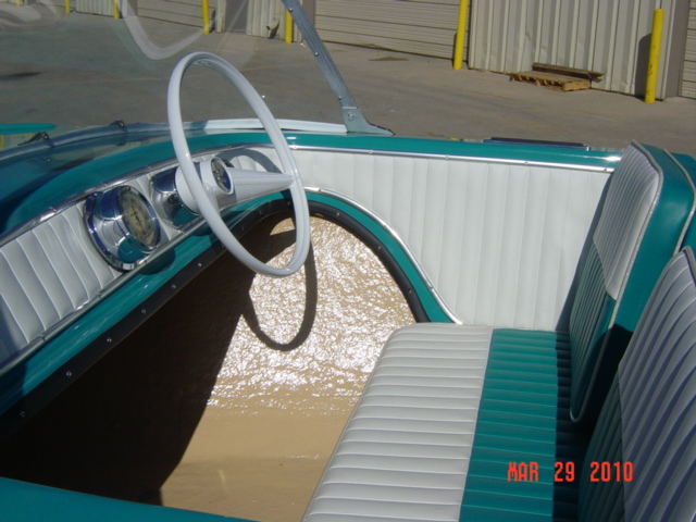

My Tomahawk came with no rub rail at all. Bent easily, for the tight turns on the dash and side panels sharp bends I made a jig so the aluminum would not "roll over" during bending.
