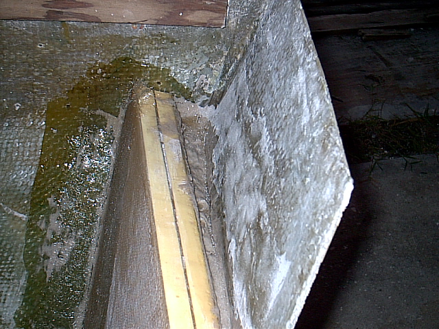

I used a pourable 'ceramic' transom compound to seat my laminated composite board, and fill the flare in the corners of the hull. Worked great. Solid as a rock.
Re:Transom Repair 16 years 4 months ago #8710

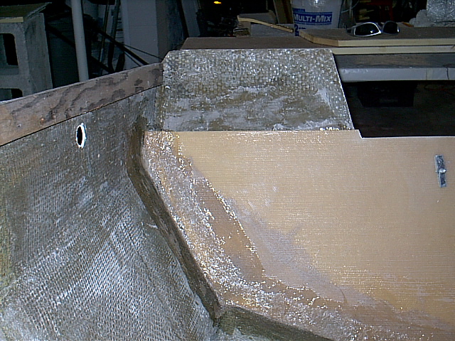

Nuther pic.
Re:Transom Repair 16 years 4 months ago #8713
CAUTION! Do NOT make the new transom too thick! I almost did. Duh! Ended up having to grind every last bit of old goo off the back of the splashwell. And probly a lil glass too, but we got her on. Looked like a real dumb*ss the first time my buddies were helping me reset the top btw lemme tell ya. Heh heh.
Good luck!
Re:Transom Repair 16 years 4 months ago #8718
I must add, cuz it bothers me just lookin at it. That the plywood around the gunnals where the deck meets was replaced with 1/2" starboard.
I cut & clamped the starboard into place first. Predrilled pilot holes for the screws. Then took it off & 5200'd & screwed it back on.
Little anal I suppose but I'd like to believe it stiffens up the gunnals a bit?
