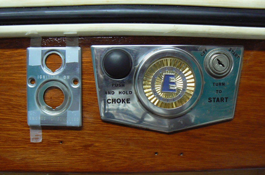

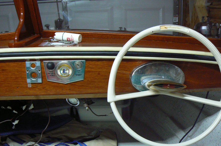

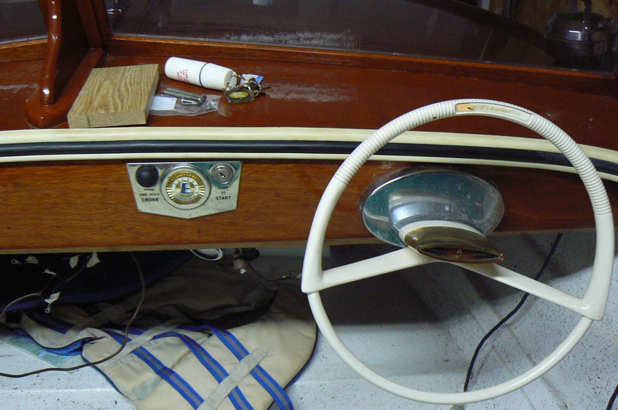

Ok folks, I need an opinion before I finish the 80 hp transplant. The new motor has the amp meter, ignition light and overtemp light. Plus I want to move the switches from the aluminum bracket they were in, to the new throttle board. The plan was to keep the current dash clean with no holes but now that I've removed the Golden Jubilee "Fat Fifty" I probably don't need to keep the emblem there so I can put the amp meter in it's place, it fits perfect in the hole. I'm assuming it was designed that way to be somewhat generic. Any way here's the dash as it sits now.
So now do I add the ignition light and over temp light to the side....
Or do I move it to the throttle board like this....
The thumb nuts are to signify where the switches will be. I thought about putting the amp meter over here too but it would be blocked somewhat from throttle handle.
Do I put the amp meter in the dash? or move it to the throttle board also?
If I do would it look funny to have the Golden Jubileee emblem in the dash without having the Golden Jubilee motor on her?
Do I put the ignition/overtemp lights next to the ignition group?
Or do I put the ignition/overtemp lights in the throttle board and keep dash clean?
Yes I'm keeping the emblem no matter what since I'm not getting rid of the Fatty, it's a spare so I can put the emblem back in if I switch back

bob, you have a nice looking clean dash, I would put them by the controls. just my 2 cents. frog

On my Larson All American I mounted a piece of Mahogany to the underside of the dash from the back and mounted the switch in that with no holes in the original dash face.
Re:Need an opinion 12 years 7 months ago #85092
  • Thank you received: 5
FWIW I like the idea of adding a panel under the dash to house the new equipment on your boat Bob. Your dash looks pristine just the way it is, I wouldn't disturb it with any changes. Try to keep the new panel as far starboard as possible, that way you won't be bumping your legs against it. Just my two cents...... ;)

Bob, I agree with Mark and MR 50's Flash aka Frozen Northman J. I have mounted under the dash as well on the g3 rather then cut another hole in the dash.

I would try to keep from cutting holes. They can be repaired in fiberglass. I repaired several in mine including ugly radio holes. But in wood I would not.
Re:Need an opinion 12 years 7 months ago #85102
Bob, I concur with under dash add on...

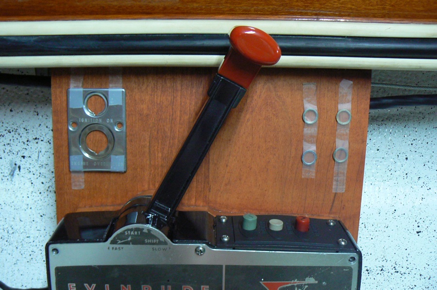

So no holes in the dash. I had actually made a small board up to put everything on and hang from below the dash directly down from the ignition panel, but after holding it up there it just looked too much like and add on no matter what shape I made it. 'm going to take that board and attach it to the left side of the throttle board where I have the ignition/overtemp light taped.
Todd good point on the ignition/overtemp lights but it does look unnatural there and too much like an add on also. I'll also connect a buzzer besides the light and have it behind the new add on panel so it will be real close to the driver, so you can't miss hearing it if it goes off.
Thanks again for all the inputs guys. I should hopefully have it ready to go back in this weekend. I'll post picks when complete.

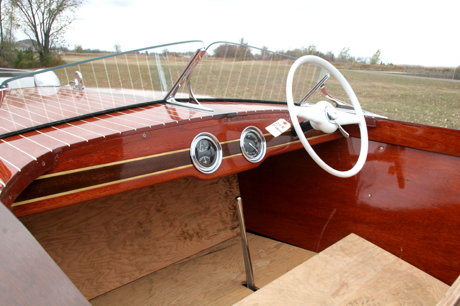

For get the amp meter, forget the "Hot" light. Get yourself a new ignition switch that has a "push to choke" feature. You'll never regret it. While turning the key to crank the engine, just push in on the key and presto - choke is on as long as you push in on the key. Put the key over on the right side of the dash where it belongs. By putting the ignition over there - it's away from the curious hands of children. That's a BIG deal. You can use the "ON" light bezel with the new key, or just mount the key by itself. Keep in mind - that all these little lights and things were OMC's attempt to "idiot proof" their motor installations.
Remove the old dash plate and mount a nice pair of vintage gauges - a speedometer and a tach! Those will be useful! You can surface mount the gauges, or cut holes for flush mount types. Use the edge of the holes for the old switches as a guide for the edge of the larger holes for the new (vintage) gauges. I did this EXACT same thing on my '59 skagit a decade ago and it came out great. It had that same plate smack dab in the middle of the dash - a horrible place to put it, in my not so humble opinion.
Below is a pic gives an idea of what it might look like

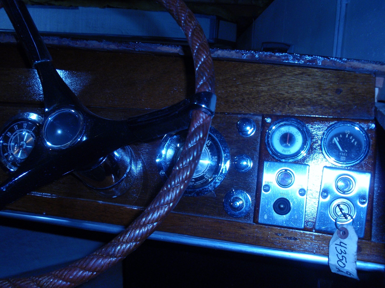

Bob, sorry for chiming in so late but the old saying about opinions...they're like---holes, everyone's got one.

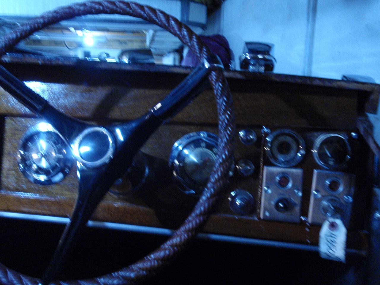

Some good ideas came across, here is what I did on my current unfinished project. Kinda a compromise between what was already stated. What Skip said I can back up, something that close to your control lever will not only be hard to manipulate but might turn into a knuckle buster. I mounted the "modules" on a separate mahogany board and put the "buttons" in the dash but everything is as close to the starboard edge as possible. This way it's possible to hold the choke switch and turn the key without crunching your right elbow or pushing yourself off the seat. The "board" is held in place by decorative screws and the whole ignition setup can be pulled forward without laying on my back to get under the dash. Sorry for the lousey pictures, the camera is going ka-poot.
Cal
Re:Need an opinion 12 years 7 months ago #85259
Nice dash Cal. Skip.

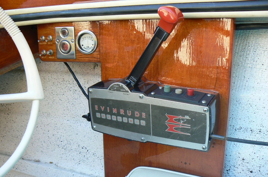

Well it's done, FINALLY!!!!!!!!!! Thanks again for all the inputs, it really helped in the final decision. I hope you all like it. It works out real well, easy to get to and easy to see from the drivers position.
I still have to put the red push button knob back on the horn switch but I wanted to bring some of the original red color back. finished that this afternoon but didn't take a pic.
Now to just get her back on the water for a tweaking run and put her to bed for the winter. Wanted to do tat yesterday but ended up having to drive to Baltimore, back home then back up to Annapolis for the Navy/Loyola soccer game. Ah the things we do for our wives and kids! Oh well, only 58 today so a little too cold to try, will try later in the week or next weekend, hopefully.

Thanks Cal. I still have to figure out how the heck I'm going to restore that paint on the plate of the throttle box. It was stenciled on I think but I won't be able to do that I don't think.

Great looking job there Bob. At least you have more room to do that than I had on my boat when I tried to mount my switches that way. Skip.

Looks great. I like the idea of the mount ahead of the controls. You know that will work with fiberglass too.
