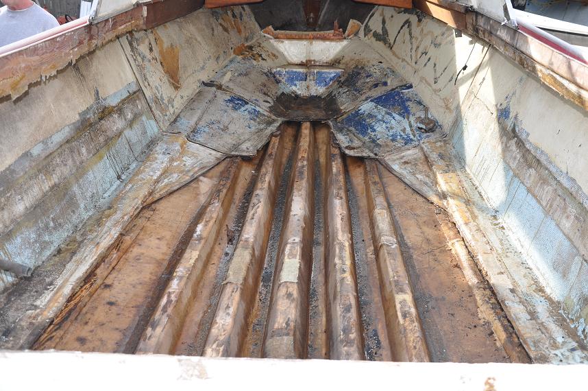

Al and I are in the East Coast Glasspar Owners Association along with another good friend of ours (Mike D.) and we are currently working on three (3) Glasspar Seafair Sedans that need floors and transoms. I will try to get some pictures up here for you of what the lower floors look like.
Re:1968 glaspar citation 12 years 8 months ago #84350
Gary:
Here is a photo of one of our Glasspar Seafair Sedans showing what the fiberglass stringers look like below the floor. To do this, you have to take a saw and cut the floor in between the stringers being very careful NOT to cut those fiberglass stringers. Then, it is a matter of sanding and feathering the edges and laying down new
plywood and then fiberglassing over that plywood.
You would have plenty of help here from all of us!
