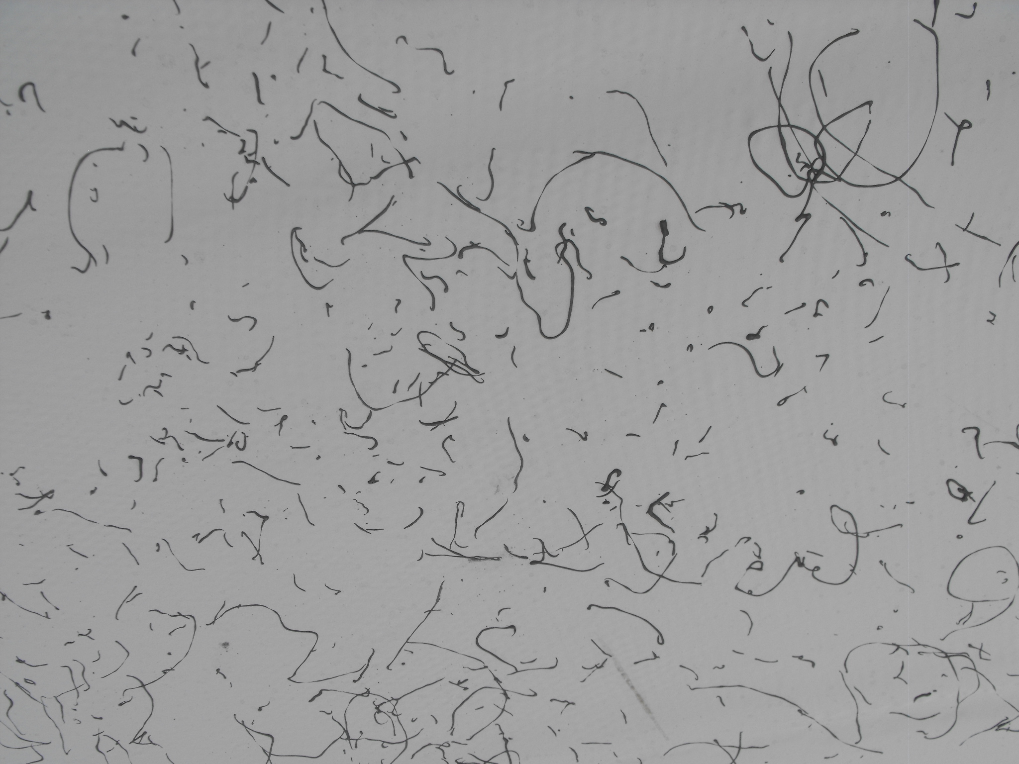

we used to get similar results by spraying unthined laquer with a binks7...sprayed it on while the panel was still wet then cleared it...called it cobwebbing....once painted the sides of a 57 ford conv plum crazy with gold cobwebbing for a customer....man was it ugly

They used a product called webbing solution. you mix it 50/50 with gel coat use mekp at 2% and spray it on you can find it on the net just look up webbing solution

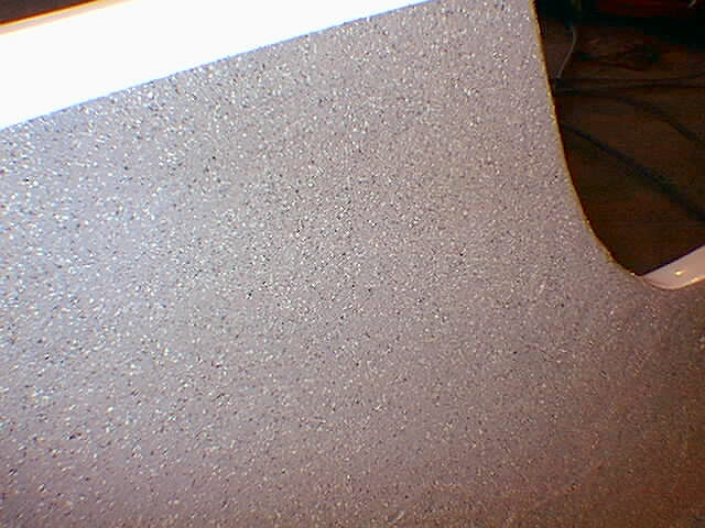

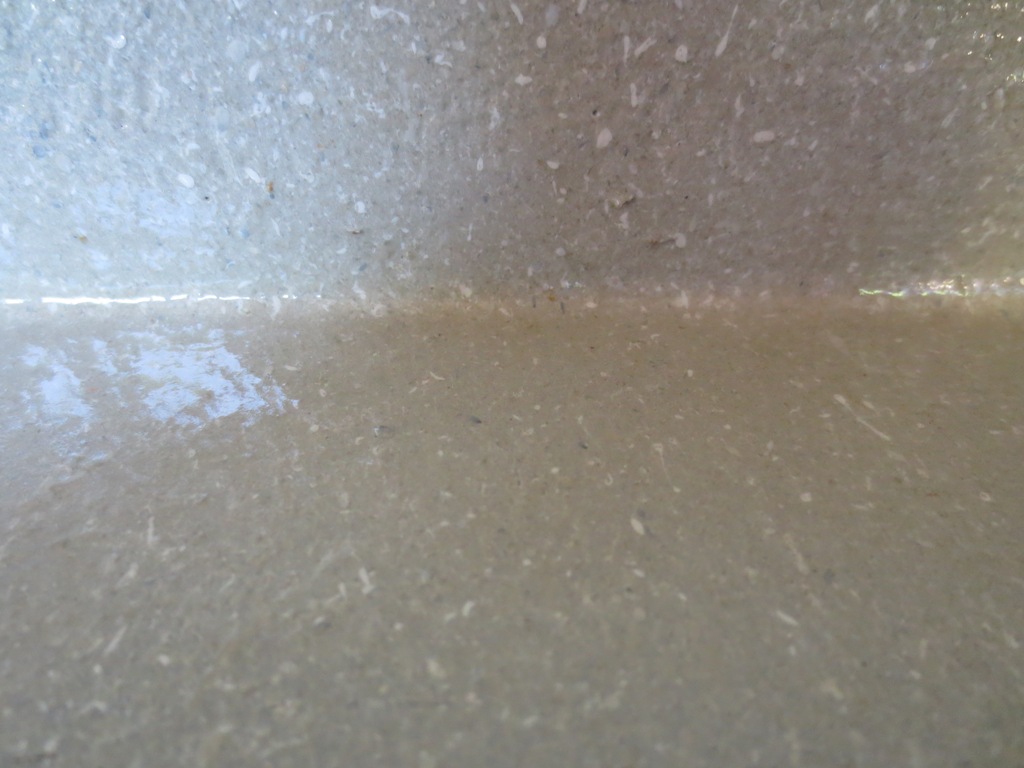

I used Zolatone on my Seafair Sedan and got good results. Glasspar actually used the same product back in the day.
www.zolatoneaim.com/
This is Apollo Grey before clear coat. Surface is a bit rough but still cleans up easily and is very durable.
Re:Splatter paint 12 years 8 months ago #84176
The fleck size can be adjusted by gun pressure.

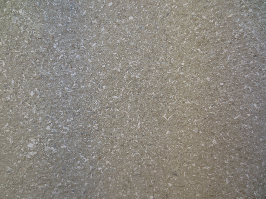

Re:Splatter paint 12 years 8 months ago #84178
Close up.

good to see ya jerry....seems to me the technique depends a lot on the type of splatter we want to duplicate...my 1960 red fish is white inside with turquoise specks....kinda plain....could be done with a paintbrush or a change of air pressure or viscosity....my 1961 red fish has this really cool cobwebbing that is a little more challenging....john

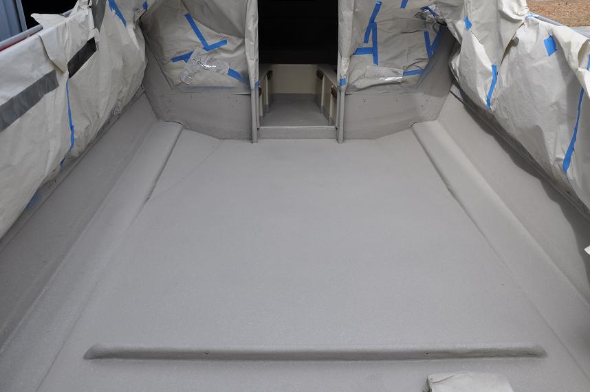

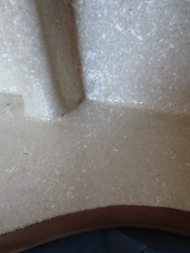

I used "Zolatone" on our 1960 Glasspar Seafair Sedan this past spring. It originally came with the MEDUSA GRAY color on the floors so that is the color I used. I had to sand down the old white floor and then use "Zolatone" Primer before putting on the actual color. Also,...you start with the color first then reduce the pressure on the spray gun to get the "spatter" or "flecks" to show up. Here are some photos of the work:
Re:Splatter paint 12 years 7 months ago #84477

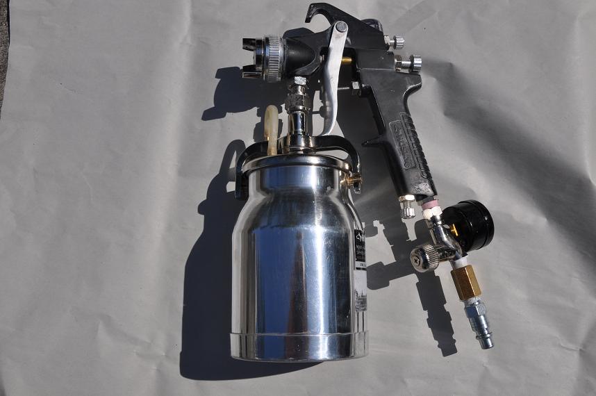

So,..a friend of mine who does fiberglass and boat restoration work for a living recommended the old "pot" style paint spray gun with at LEAST a 1.8 nozzle. I am happy to report that older style gun worked GREAT with no problems at all.
Here is a picture of that style paint spray gun:

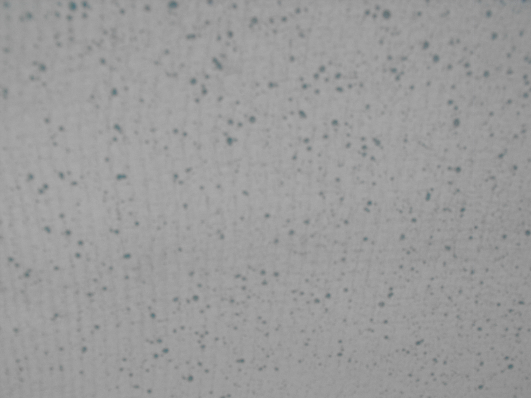

I got great results by using a WallPaper Paste Brush. Fewer Bristles. I only wetted about 1/4" of the bristles.
I also used a piece of wood to hit against the brush instead of hitting the brush against the wood. I found I got better control of the splatter that way. I too used a White Background with a "Baby Blue" Splatter.

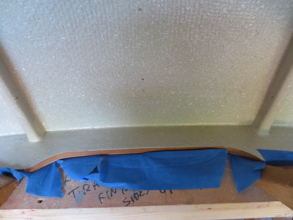

I did my Glastron with a little bit of the topcoat and some grey primer. I applied it with a HVLP paint gun with the pressure turned almost all the way down. It worked great and the paint will travel horizontally to reach the tough areas.
