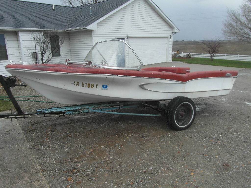

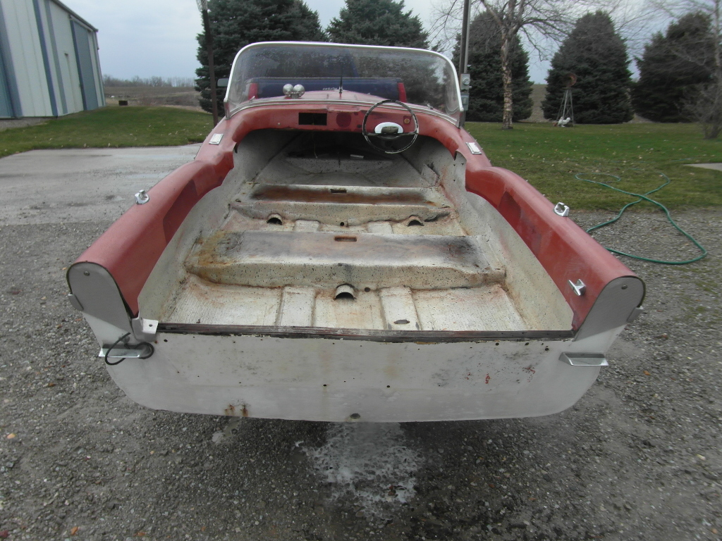

Looking at possibly buying this boat. Guy is wanting around $500. I am worried about the transom cut. Also there is no trailer, motor, or title. Thoughts? Thanks for any help you can be. Looks pretty solid inside.

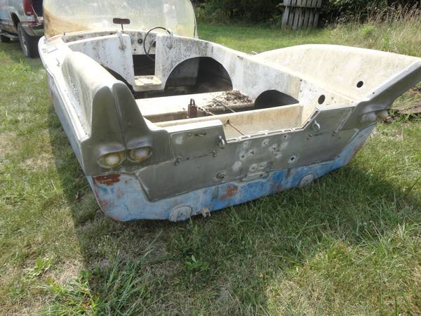

another view

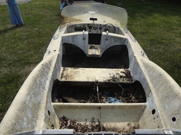

More pics ... I hope these are showing up.

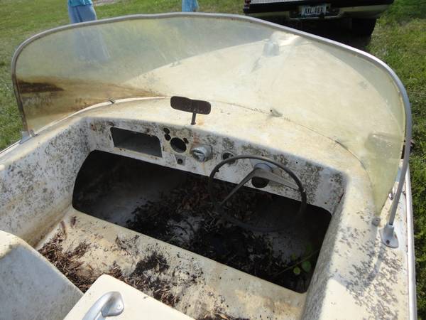

one more

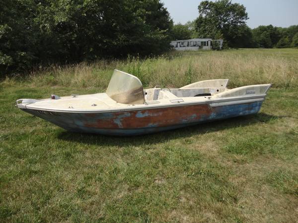

last image
Re:Please help me identify this Herters Boat 13 years 1 month ago #82736
You need to resize your pictures or something, I'm not seeing anything. Other than that, the registration might be a problem with no title. What state??

My two cents? Run away. MAJOR project, a boat like that, to me, is a giveaway, you can find much nicer for $500. With at least a trailer, and probably a motor.
Don't know what state you are in, but the lack of a title may or may not be a major issue. Check with your DMV before you do anything, I just went through a major issue with that. If I were you, though, I would keep looking.

If the bow handel, and fin script are in decent shape it's worth it. Herters was real big on Aluminum stringers and supports no wood so that cuts down on a lot of work. Have you checked out the Herters section in the Glassics Library? Read about their construction before you make up your mind. Should you decide to pass it by please post its whereabouts so someone can rescue it. You will be able to tell more once it is pressure washed. That thing is filthy. Oh for my two cents a good find. Talk the guy down.

Hi, I agree with Al,, this is a very do able boat with a great reward when you are done,Yes it is the least desirable of the 4 yrs of Herters but it is a unique boat when you are done,But if it is a give away there will be plenty of takers,I have the full set 56 57 58 59,,Do a little research and make up your own mine,I have did a lot worse and paid a lot more but glad I have them Bill

$ 500.oo???? = The current owner is living in a dream world. =====> If you look around even a little bit, you can find a NICE (and RARE) boat, motor & trailer that RUNS for 500 bucks or less.
(Boats like that one are often FREE.)

First the disclaimer. It is difficult to judge the condition of a boat from pictures, but here is what I am seeing.
The boat is either a 1959 Herters Mark III, or a 1959 Herters Flying Fish Standard. Measure from the tip of the bow casting to the rear of the transom. If it's 15 feet it's a Flying Fish Standard. If it's 14 feet it's a Mark III.
The Flying Fish Standard is a little more desirable than a Mark III model because it's longer and wider. The most desirable Herters is the single cockpit El Dorado and then the 57 and 58 Flying Fish Deluxe models because of their huge fins.
As Al and Bill have mentioned, the boat looks restoreable.
It looks like all the trim and hardware are there except the glove box. See if it's laying in the boat somewhere. Repops are available, but pricey. The windshield looks like the tall original Herters model, but will need to be replaced. Check all the castings and support pieces under the seats and front deck. They are often cracked and pieces may be missing.
The question mark, as you have noted, is the transom. It appears that it had the optional 20 inch transom and some one modified it. It can be repaired, or as some have done, replaced with a wood transom.
I wouldn't worry too much about the condition of the fiberglass at all. It's easily repaired. There will be a lot of grinding and sanding on the deck and hull however, to get a good finish.
If you are thinking about showing it might be easier to start with nicer one, but it is possible to make this one show ready. Problem is, Herters runabouts are becoming scarce and "nice" ones aren't turning up for sale as much unless they have already been restored.
If you just want to have a good looking glassic that you want to cruise around in and not worry about it being 100% authentic, this one would be a good candidate.
As Al mentioned, the big thing is all the aluminum trim and hardware. If it's all there and not chewed up or busted up the rest is not too difficult.
As for the price, it's not really out of line. I have seen this model go for more, in the same condition. Never hurts to start low though.

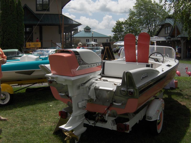

I've attached a pic of our 59 Mark III that we sold recently.
