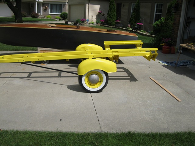

Re:12" Trailer Wheel- Tire Size 12 years 8 months ago #84463
The 5.30 does look much better on mine and fits just fine. Couldn't go with the Coker white wall because sadly it isn't rated for enough weight.
