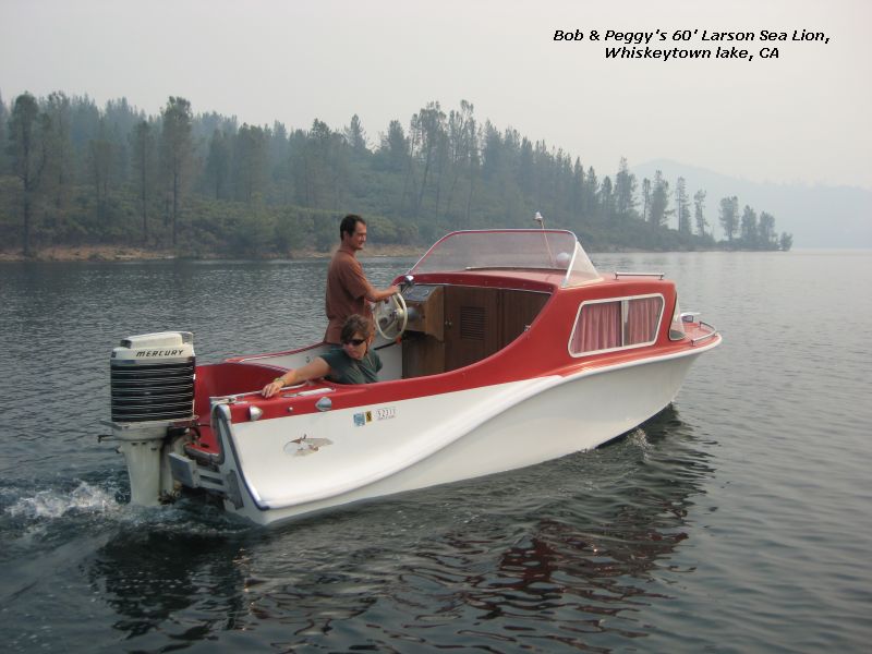

The 18' SeaLion still has the original Merc 700 "dock buster" and is great. A Merc 800 would probably give a bit better performance with extra passengers. I like the look of it.

I have one just like the one in the photo, and, the open runabout version of it, that I am going to liquidate. There is a 75 HP Evinrude on the Runabout that runs flawlessly. (well, it always has, until I posted that just now) ;)
