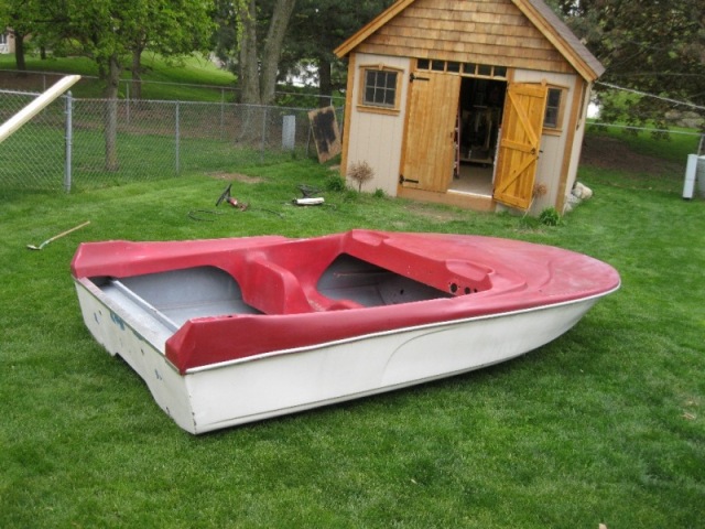

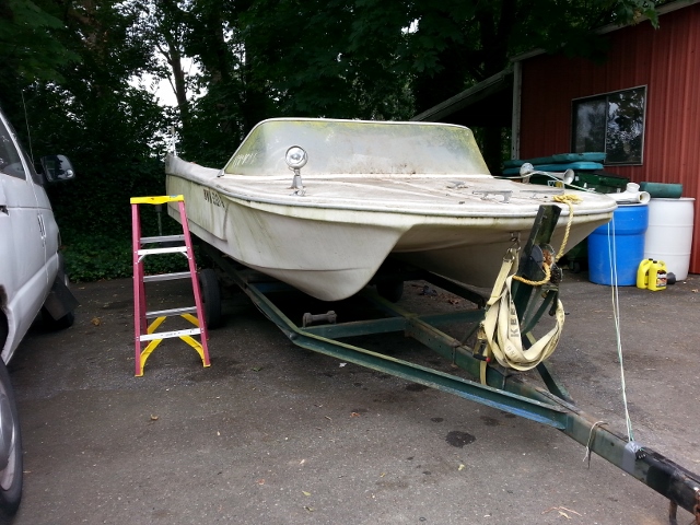

Lurked around here for a while. Finally landed a candidate for a restore. It is a '61 Delany 15'4" long 83" wide(she is beamy). Considering my power options. Any advice on power plants? She had twin Johnsons of unknown power. Let me know what you think.

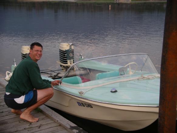

twin cloud white 70's...ron

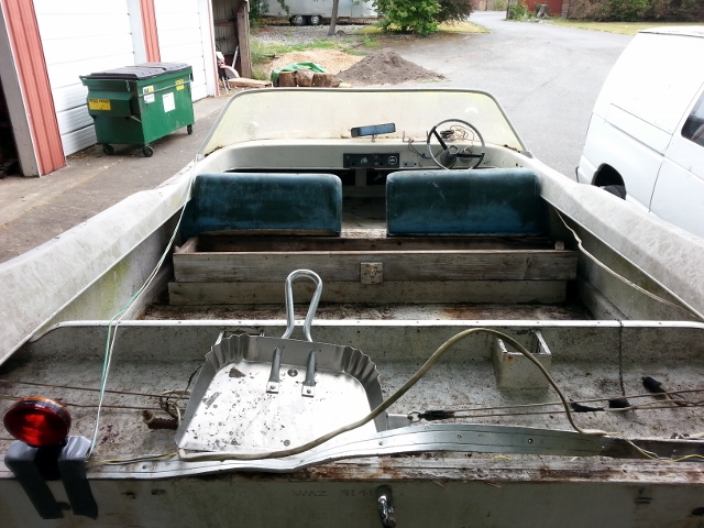

Yah that's the look I'm thinking of. Any photos of the controls/steering setup? Can't seem to find any info on twin mercs.

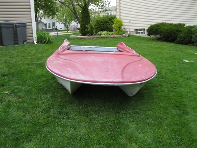

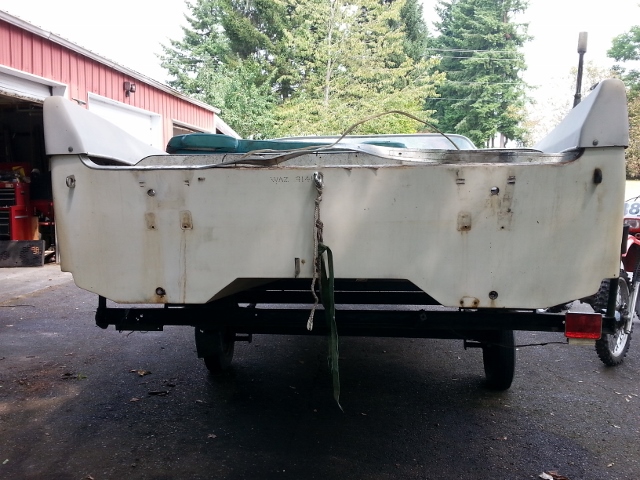

Got a photo that shows the twin hulls at the transom and all the way down to the keels?
Re:new member, new boat. '61 Delany catamaran 13 years 3 months ago #81206
here it is.

thats exactly like my mantaray. i've found by having a single engine in the middle of the tunnel you will have a cavitation problem. i have to run my 700 in the next to last pinhole to avoid cavitation. ron
Re:new member, new boat. '61 Delany catamaran 13 years 3 months ago #81215
Ditto Ron. I suggested twins based on actual experience with my Powercat 15C that I had a number of years ago. When I bought it, it was fitted with a single Merc 1000. It was a total dog. It threw up an absolute ton of water onto the transom wall, and into the splash well. If the motor was raised, the prop would blow out horribly on even the slightest turn under light throttle. A catamaran performs best with twins, unless it has a center sponson just ahead of the motor. It's common to see a cat with a single motor, and the transom cut down a couple inches - because someone was trying to make it run right. The sponsons of the boat push down on the water as they support the boat. The lower unit and prop, being just behind the sponson are fed water at the correct height. When an engine is placed behind the tunnel - the water is not at the optimum level for efficient operation.
Re:new member, new boat. '61 Delany catamaran 13 years 3 months ago #81216
bruce, the 61 and 62 mantarays were designed with a slight center sponson at the rear of the boat which solved this problem. crosbyboat ran a 61 mantaray with a single 1150 and didn't have this problem. franks powercat has the center sponson also. ron
Re:new member, new boat. '61 Delany catamaran 13 years 3 months ago #81220

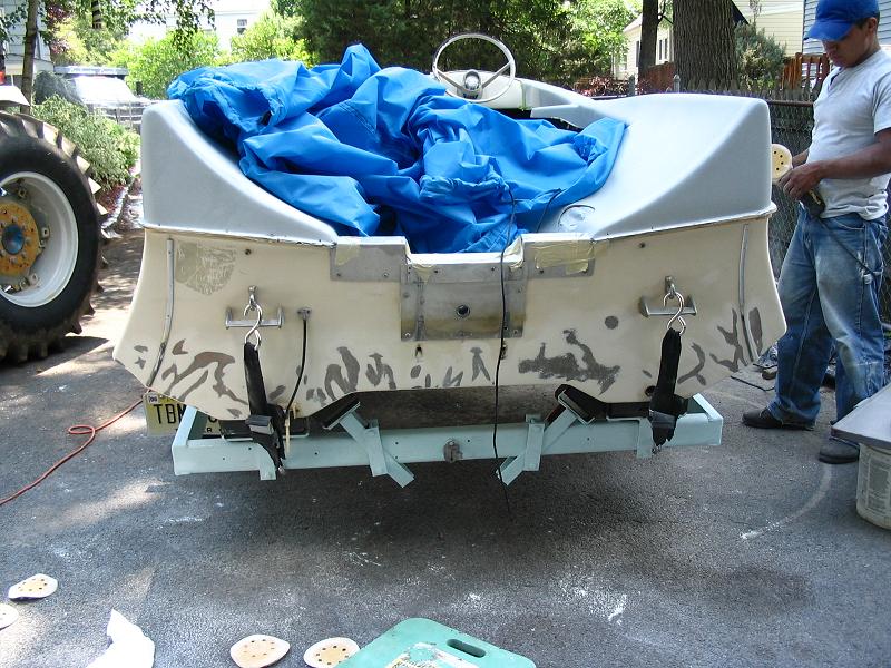

Based on your transom photo, I really like twins for your boat. She is going to take some time. Always watch for parts during that time. You will not believe the joy that you will feel when a hard to find part surfaces.

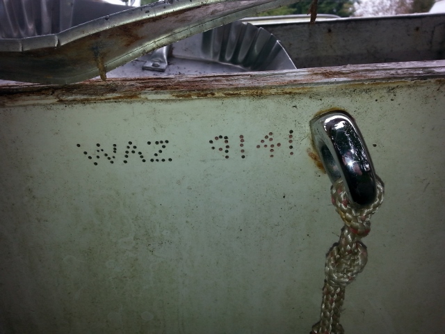

Why is the Delany listed as a Delaney by most people and on this site. Based on the badge the spelling is incorrect. Not that it matters but google doesn't even like me to search for it. Does anyone have anymore info about the company as there does not seem to be much available.
My hope is to rig the boat up and be able to use it the rest of summer. Then begin the process of making her pretty. She is sound and leak free with no rot in the transom.

Can you read the detail on the plaque of your boat? Is it a city and state?
Re:new member, new boat. '61 Delany catamaran 13 years 3 months ago #81261
Looks like it agrees with the record in the Glassic Library of Woodburn Oregon

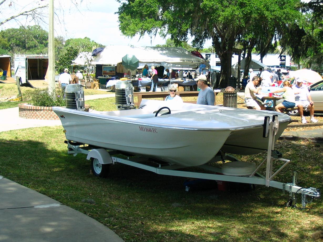

Here is the nameplate Delany used on the smaller cat from a 1959 model
Re:new member, new boat. '61 Delany catamaran 13 years 3 months ago #81265
Here is one that I believe is the larger
15 footer like yours with twin inline 6cyl..

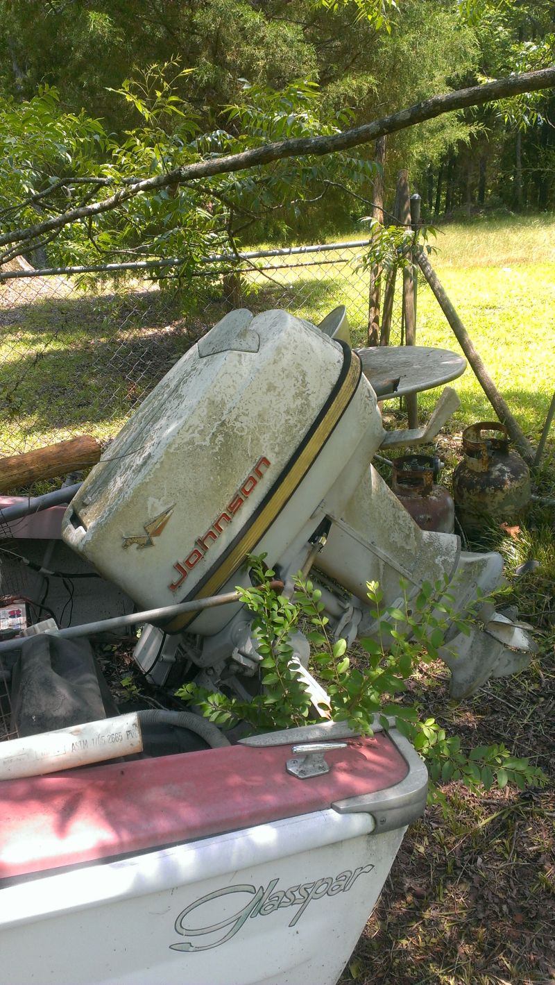

ok johnsons, i found a glasspar and posted it in sitings it is a complete boat parked and left there key is still in the switch. i got a picture of the outboard but i cant remember what hp it is if is something you might be able to match let me know i can go back and find out what hp it is. just a thought.
