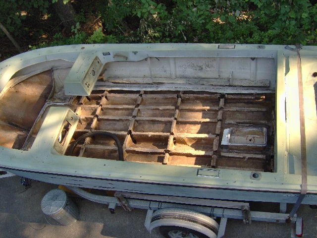

Thanks for the good tips!! Very timely as I have my Banshee stripped down to bare and ready to make new cross members that support the sole (floor). The old ones were 1 1/2" plywood. Should I go with that? Seems a lot easier to cut on a bandsaw than solid wood. They were glassed to the bottom in several places. I will repeat that process. There is one long piece of solid wood (mine has a bit of rot) going down the centerline of the keel on the inside. Can I cut out the rot (about 6" in a position just under the front seat bottom. I was hoping to cut the rot out, replace the wood and glass the whole thing in again.

So are you telling me I did mine right without even knowing it. Putting the framing back in seemed daunting, so I just layed another layer of woven roving. No more wood. The cut fiberglass was still strong enough to support my weight standing on it.

We removed all the rotted wood. We had to cut the existing fiberglass to get it all out. After cutting them we were still able to stand on them. They kept their shape, so we simply went over them with another layer of woven roving. Glued and screwd the new floor on to them.
I don't think I would have done this except for the fact that that was one serious grid under the floor. If it was only stringers I might have opted for new forms.
